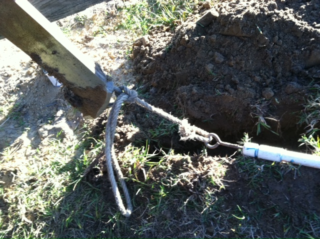

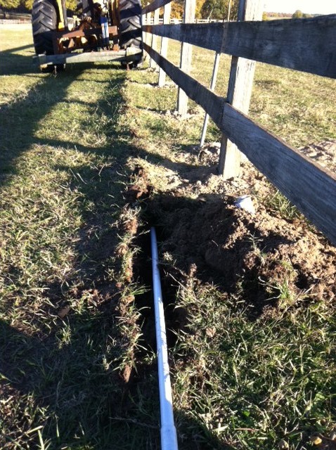

It's been a while since I've discouraged anybody from plowing roll pipe instead of pvc. I've done both. I like pvc much better ecause the fittings are so much better.
Yesterday I plowed some 3/4" pvc and I took some pictures. Plowing is so easy when you get the hang of it. I've plowed sizes up to 2"
I use a subsoiler foot with a sharp front edge to minimize grass disturbance. A steel ring is welded at the bottom to tie off to.
The pulling head is just a pvc cap with a hole drilled in it for an eyebolt, with 2-3 feet of pipe attached that I glue to the new pipe for pulling. Just cut it off when you're done and save it for the next time.

I've done this as well- probably got the idea from you. Pulled a couple hundred feet of 3/4" PVC in a single pull. My connection was as low tech as it comes, duct tape over the end of the pipe to avoid dirt getting into it and bailing wire around the pipe with duct tape for good measure and more bailing wire to attach to the subsoiler. Gotta remember to drop the subsoiler a few feet ahead of where you want the end of the pipe to end up and I found pre-digging my hole for the connection before I pulled was helpful as well. The big disadvantage is if you don't have enough room to lay the pre-glued pipe out behind where you are pulling- then the poly would be an advantage.

What sort of depth can you achieve with that method?
I can go over a foot deep with this subsoiler foot. It's limited by the length of the subsoiler and the lifting range of the 3 point hitch.

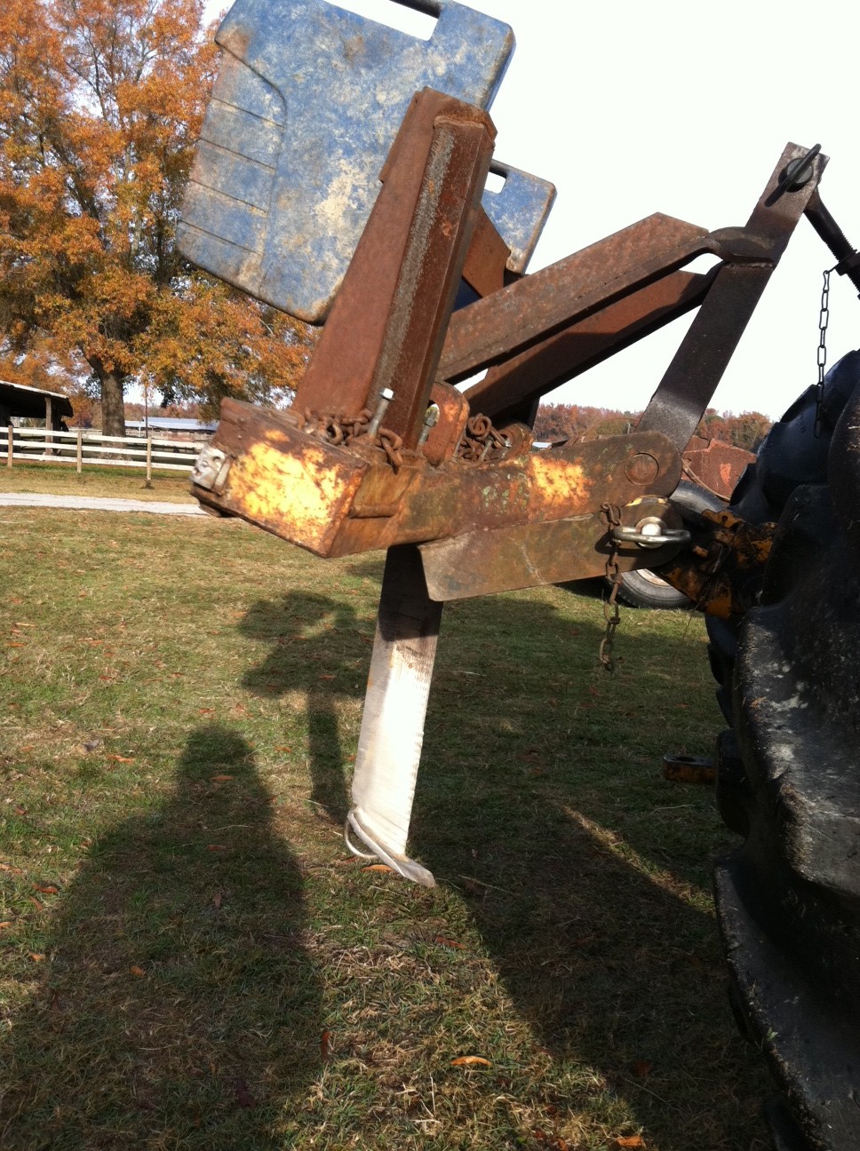

Gaby,
Do you have a pic of your subsoiler?
Do you start with the pipe or do you pull it first with no pipe to get the depth?
Here's a picture. I usually run it without the suitcase weights. The frame is a toolbar with seven slots so I can mount the foot in different positions. A simple subsoiler will work just as well. The front edge of the shank is sharp to slice neatly through the grass, that's very helpful.
Sometimes I make a dry run especially if I want to bury it extra deep or if the ground is dry and hard.
