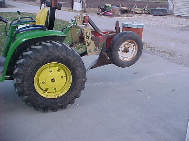

This might be alittle late but- I have a 1-14 plow and had set up problems aswell. I welded a gauge wheel on the plow and also made it fit my quich hitch. This save me alot of time getting it set.

Great, as long as it works. I noticed an hydraulic top link as well? That looks handy along with the quick hitch. How do you change the depth with the welded gauge wheel?

Dana,
How do you achieve any depth with the plow or are you just breaking up the top couple inches?

The guage wheel is welded to a sq.tubeing that slides into a bigger sq tubeing that is welded to the plow frame. I drilled 1/2" holes every 1" on center to set the depth I want. It's set at 6" depth in pic. It can get over 12" deep in the last hole. I guess I should have explained alittle better.
With a hyd top link and QH it works very well.
