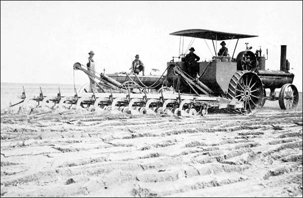

The clue to that tractor's ability to pull a 12 bottom plow is in the HP and RPM. Remember from physics, HP is equal to Torque*RPM/5250. So, a steam tractor with 45 HP at 260 RPM has a whopping 908 Ft*Lb of torque!!! Yowsa. My modern Kubota diesel has 34 HP at 2500 RPM (or there abouts) and with the same math, 71 Ft*Lb of torque. Kind of a let down in comparison....
So like my Auto Shop teacher used to say, "you can only compare horsepower ratings if you know the RPM".

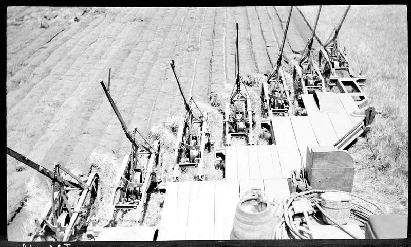

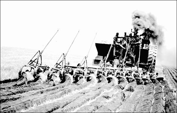

JOHN: THANKS FOR THE PICS. this old steam engineer really liked them.
