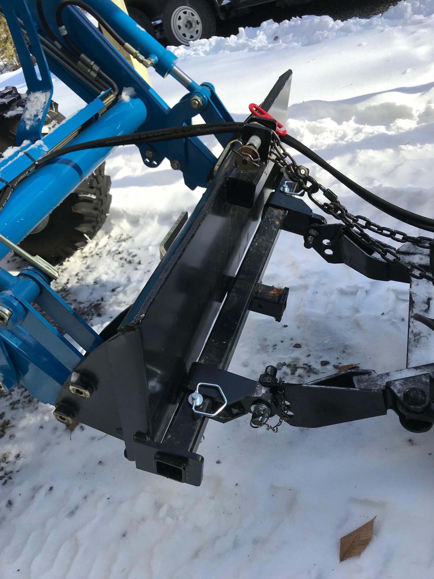

I run a similar size tractor and adapted a 7' 6" truck plow to a QA plate and ran hyd. lines from one rear remote to the front for power angle. Also run a 7' blower on the back.

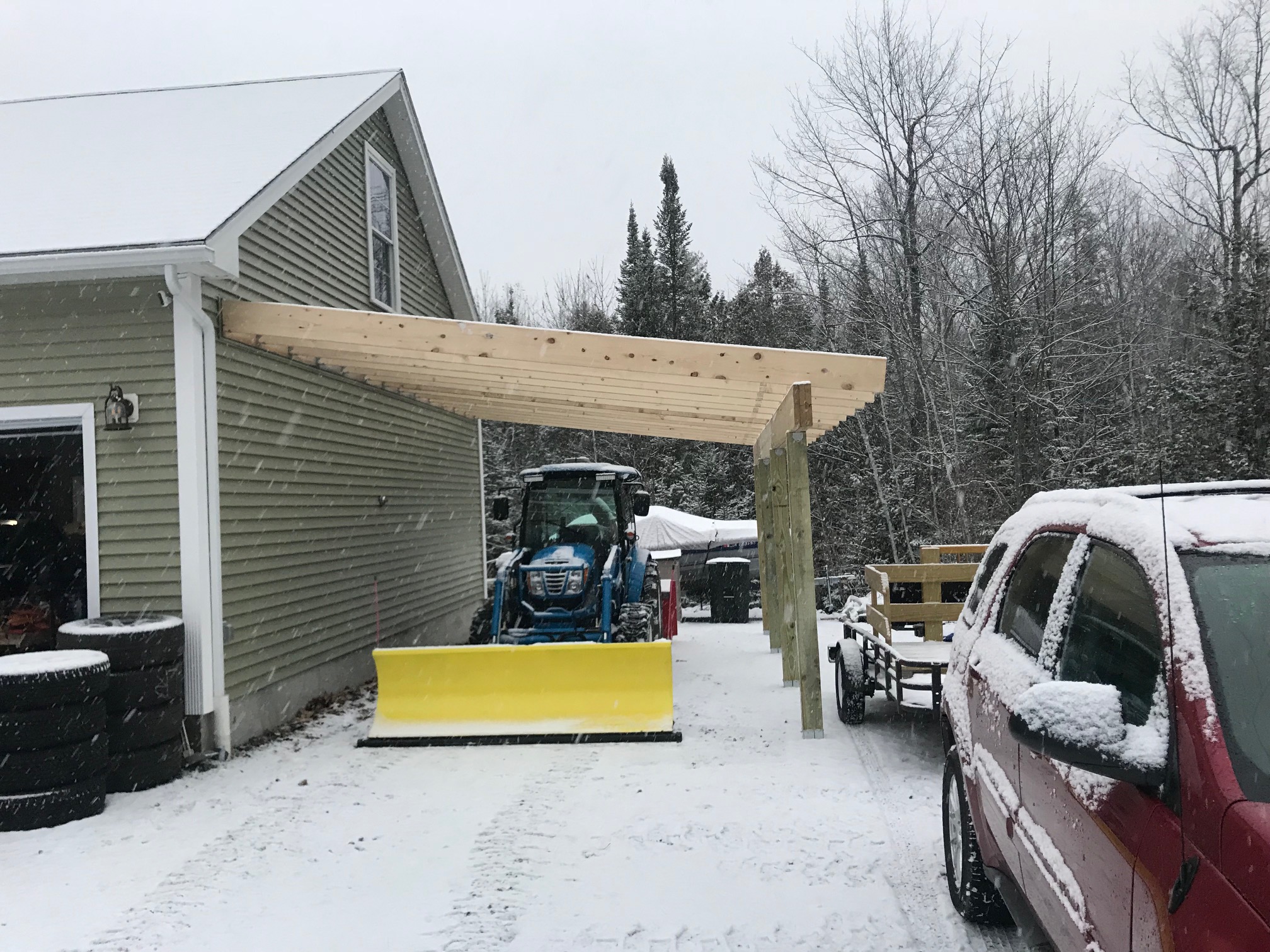

I use a 7'6" Diamond unit with my Titan 3PT QA on my LS XR4140 unit. Its more than capable. If I had the option again, use the same size plow.

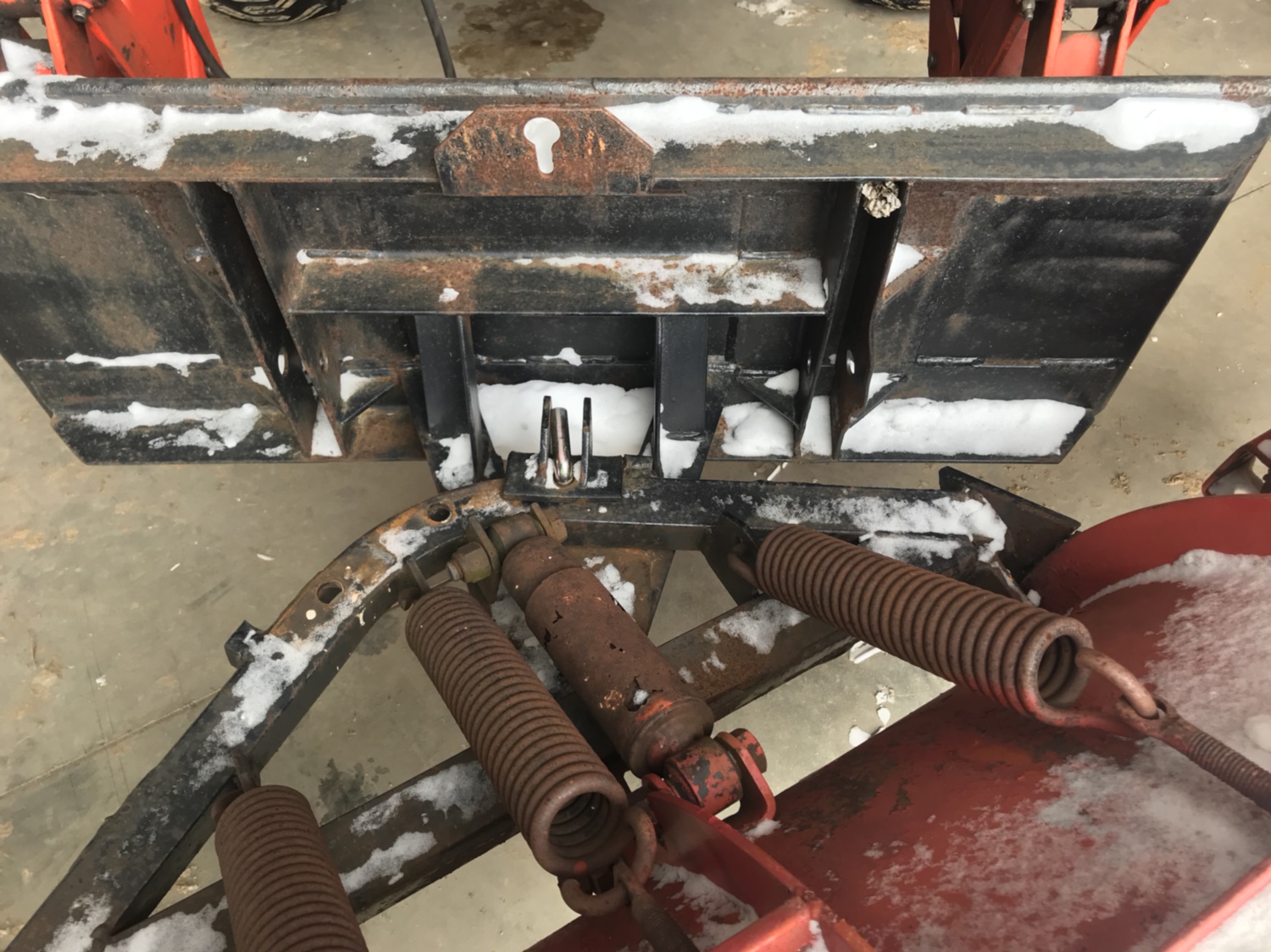

Picked up a 3 trip spring Meyers plow : 7’-6” on Saturday .... guy kept lowering his price as we talked ... think the angling pistons are seized up... the hydraulic hose couplings are rusted together... overall the plow is in decent shape... just looking for a couple local welders to call me Back now to see about fabrication of a couple brackets to weld onto the plow frame that I can then attach to the 3 point mounts. Already scooped out new pistons & hoses... just trying to decide on the 3 rd function valve assembly I’ll need if I want to power Angle the plow or just pivot the blade and pin it where I want it...

Are you looking to use this on the front or rear of your tractor? Look at my previous post, I didn't have to weld anything, I just bought the correct quick attach plate and everything connected up. I ran lines from my rear hydraulic connections to angle the plow. We got a couple feet of snow and ice this weekend and everything worked great.
The plate I used: Three Point Adapters - Quick Tach Attachments - Tractor Attachments

I have the same QA plate. Issues are that the plow mount pin is 5/8 & the 3 point mount pin is 1-1/8 .... see the problem ?
/ Plow size #16
What about using a sleeve? I have cat 2 on my tractors lower links and I use cat 1 attachments all the time

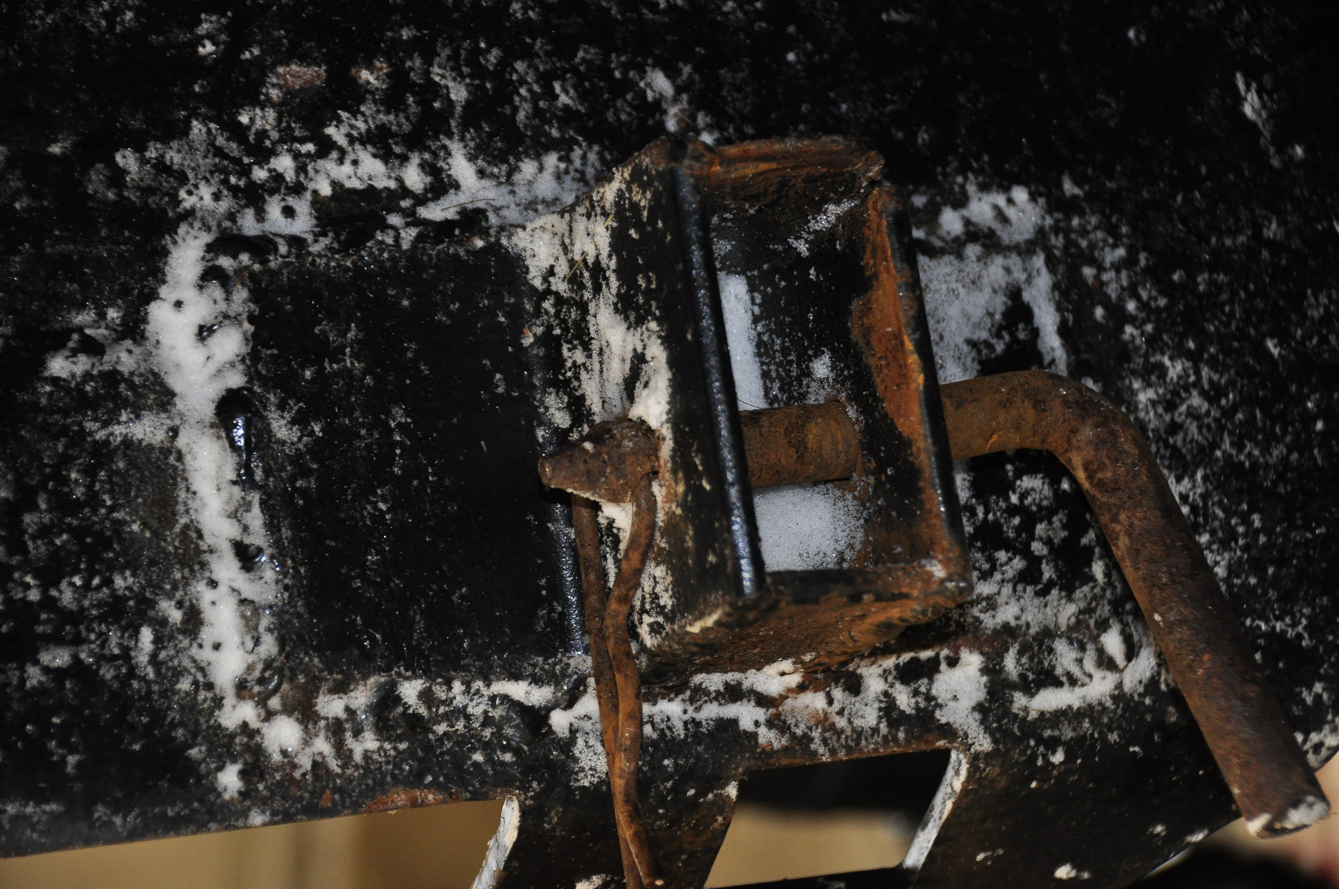

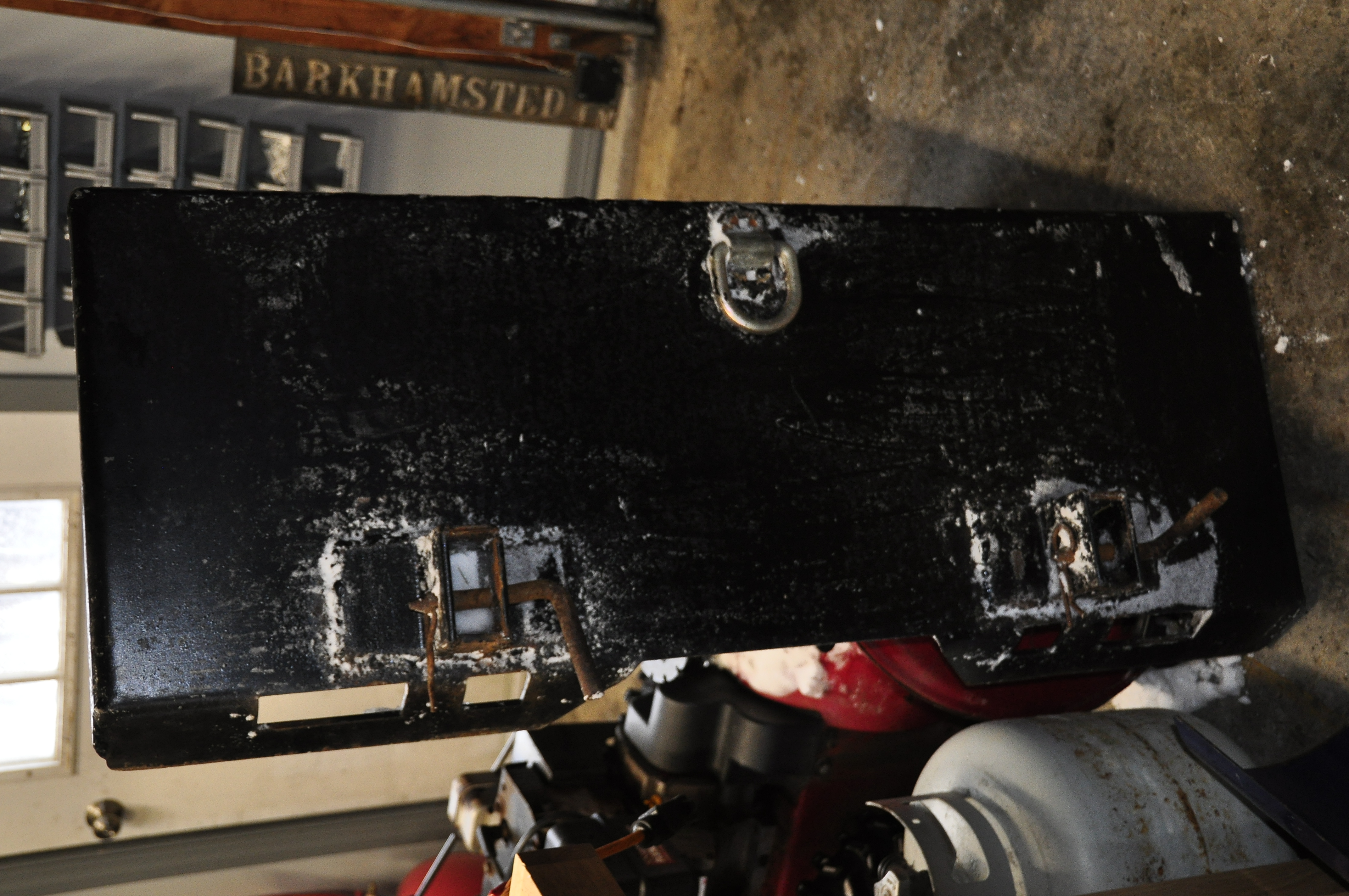

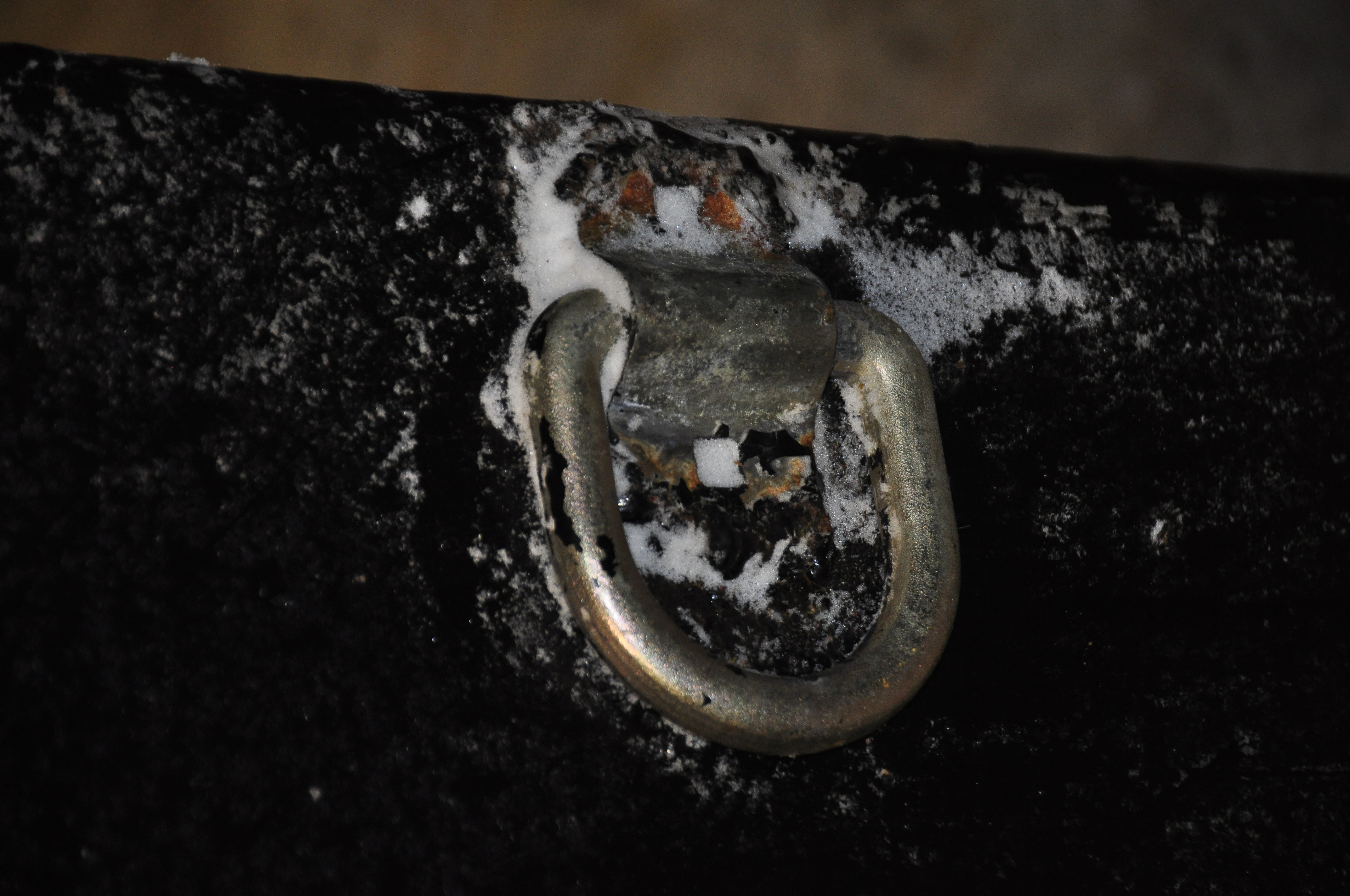

Here's how I mounted my plow. Welded on two boxes to the quick attach plate where the A frame of the plow attach via pins. Welded on a D ring to attach the plow's lift chain to. When I curl the plate backwards, it picks the plow up so I don't actually have to lift the loader arms unless I need to get the plow more than 18" high.
/ Plow size #18
That’s a pretty good design. I had a friend weld mine up. I’ll GT a photo and post it. Yours looks good
