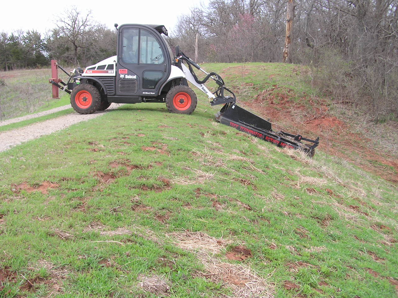

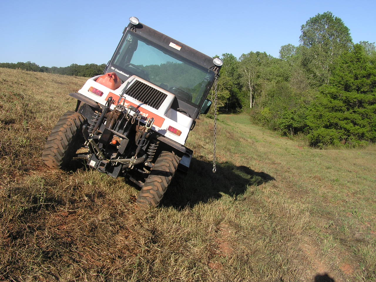

The Bobcat Toolcat is very stable without adding anything:
Look close, the 7' brush hog is on the front on this 27 degree slope:
