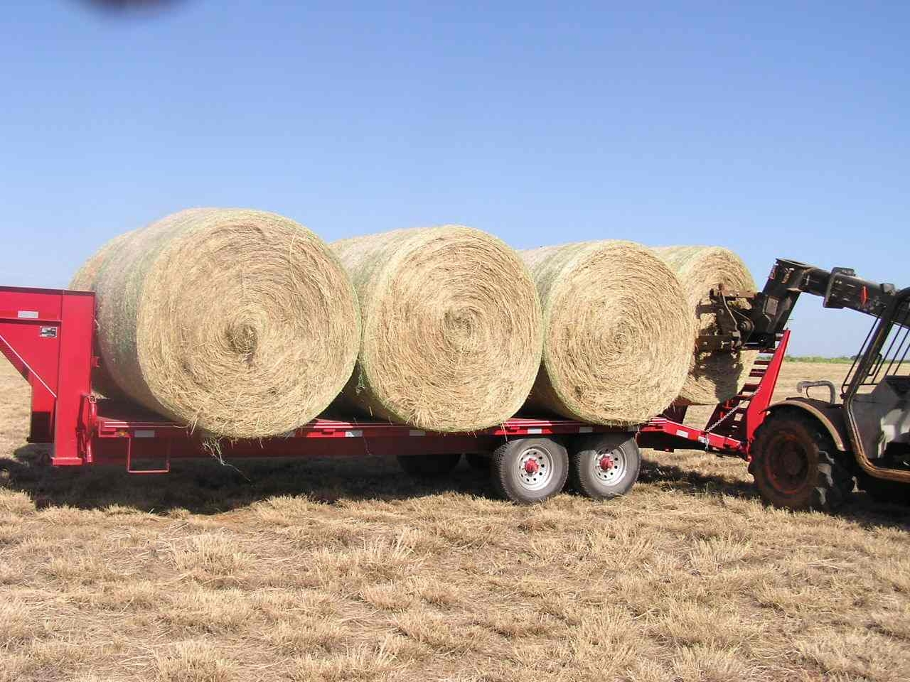

My neighbor makes 5x6 bale's. He has a skidloader and a 100hp New Holland. He estimates them at 1500-1600.
Picture from 2010, took this load to the scale at the Co-op. 5x6 bales averaged 1450 pounds each:
