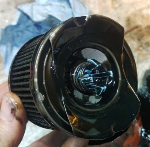

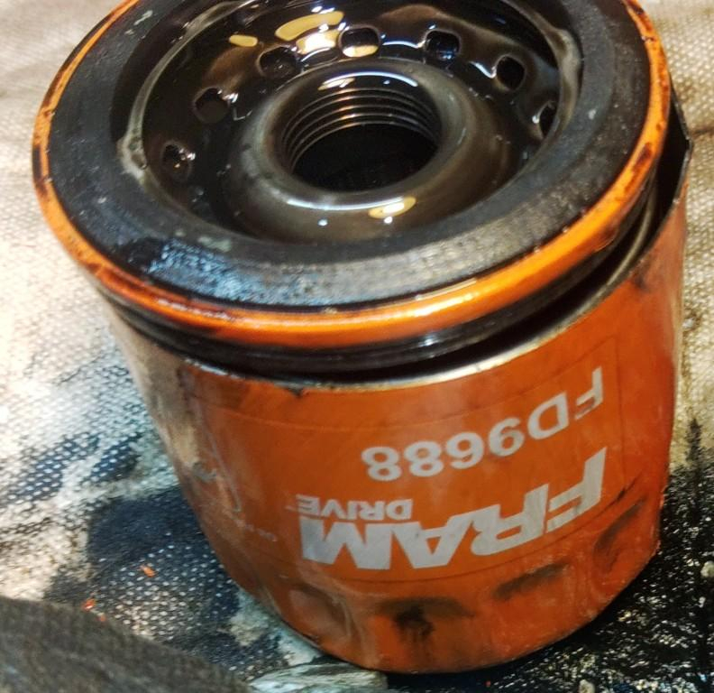

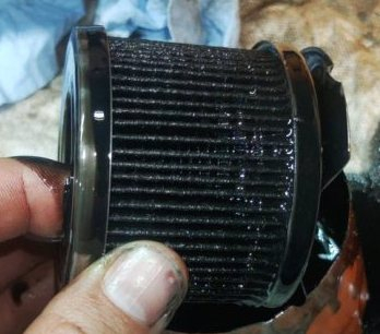

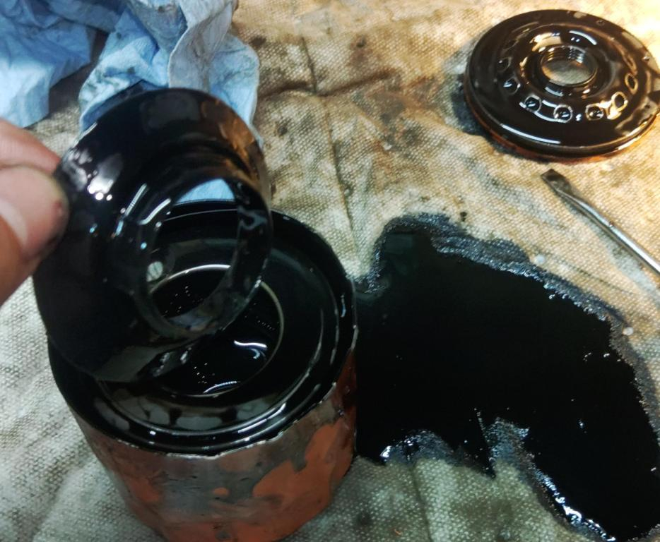

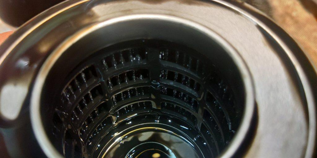

EDIT: In light of a response from user M59, I retract the following endorsement. The filter I bought, the Fram Drive FD9688, was indeed of good quality construction, but apparently they are not consistent with this and still use the paper end caps on some models. I'll leave the original post below for posterity, but wanted to give a heads up for anyone reading this that you may want to read further in the thread before deciding whether to buy Fram filters.

Alright guys, so I did get around to changing the oil on the tractor today finally and cut the Fram FD9688 model open that I bought from Advance last year. Ran it for 37 hours during engine break in (I also changed the oil once after about the first hour of running, something I do with all fresh engine builds). I'll let the pictures speak for themselves, but this looks like a well made filter to me. Standard rubber drainback valve, metal end caps with integrated spring on the bottom one, plastic cage internal to the filter media and plastic bypass valve with a metal spring holding tension. So at the very least I can say that this particular model from Fram is good stuff. In addition to working on my early Kioti with its oddball Kubota engine, this filter is also used since the '90s on most Hyundai and Honda models, so if you've got one of those cars and this filter looks good enough to you, go ahead and use it.

One more thing to note on this filter, when I pulled it off, for the first time in my life, the filter gasket ring stayed stuck to the mounting surface on the engine. When I removed it, there was a layer of rubber stuck to the surface like if you put some RTV on it (I didn't), which I thought was a bit odd. I've heard the stories of this happening but this is my first experience with it. Seems like the rubber they used in the gasket had something to do with it.

Most fram horror stories I've heard about wasn't from how the filter was assembled or the quality of those parts.. but the paper filter media itself would disintegrate...maybe they have improved the quality of the media now..
