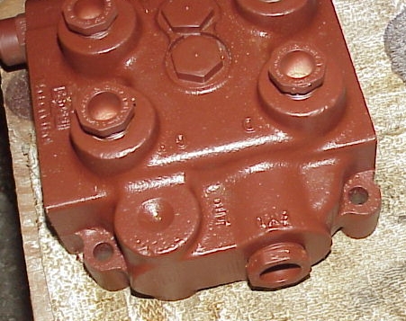

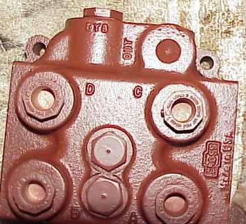

Attached are a couple of shots of the outlet side of a cross double spool valve.
There is only one port on the outlet side of the valve and I am confused about this...it also says "out" on the same side but it has "BYD" directly on the port casting. I'm looking for any insights you guys have to offer...
I'm hoping this valve does have PB...here are the pics..

from the pictures no I can not. Do you have a model number on the valve bank? Is it for for a closed center or open center system?
Can you tell if the "out" port is also connected "internally ported" to the ends of the spools? I.e. spring chambers. If yes it can NOT be used for power beyond functions unless these covers will withsatnd system pressure.

If it is a PB valve, then it should have 7 ports. One of the out ports should have a T for tank port.
Show pictures of all sides.

This is a power beyond port for sure, you would need to plumb it that way if you need it!

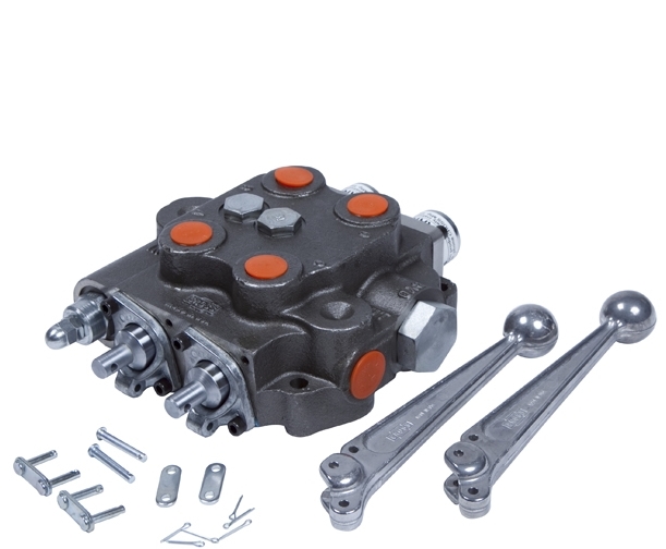

here is a picture of a standard valve with PB option...note both valves marked have the same port marked "BYD"...this (new) one has that port plugged....note the port marked "out" is not machined on my valve but is on this one...
can anyone confirm that there is such a thing as a dedicated power beyond valve?

I suspect it is NOT PB capable in it's present form.
OK I am going to take a wild entirely uneducated guess and assume that this valve is a dedicated Power Beyond valve with no other outlet port?
Never heard of such a thing. EVERY other PB capable vavle I have seen/read about has a OUT or T port for the waste fluid from the spools...That is why I suspect this valve is not set up for it. It is probably a universal casting.

Yes, it should be the last valve or by itself...
When a valve has a PB "option", there is usually a special "sleeve" that goes in the PB or BYD port to redirect the flow toward that port...so the simple answer to your question is Yes-it is plugged.

NO! When the PB plug or sleeve is installed, All the flow from the pump needs to flow out of this port so you absolutely can not cap it at all-it will deadhead the pump. The OUT or T port only carries the waste oil from the work port in a PB valve.
