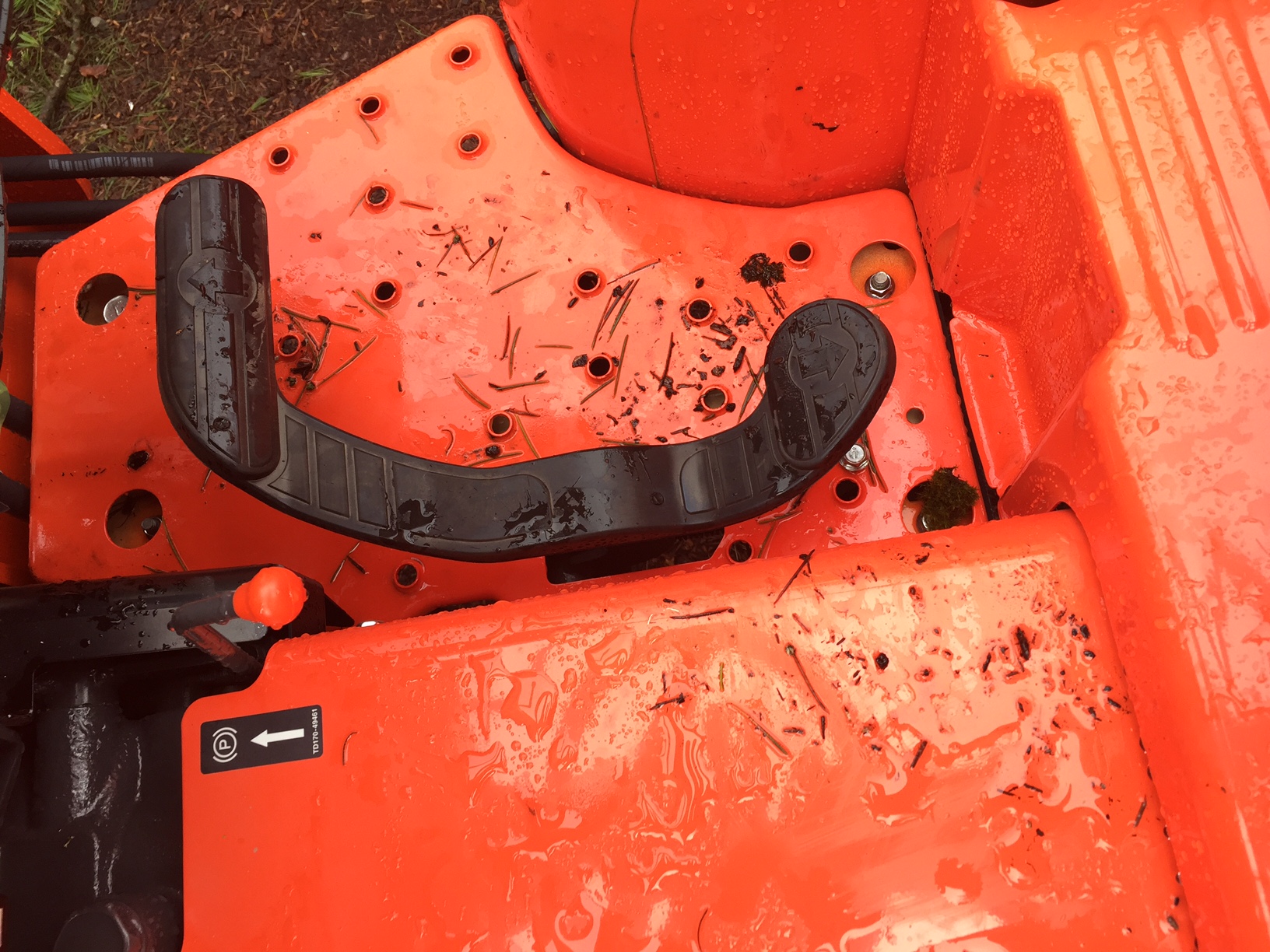

I really like the Kubota treadle pedal design compared to the two pedal design, since I've used both, and currently have a Kubota. I guess it's all in what one gets used to. I don't rest my whole foot on the pedal, but rather use a toe/heel method to cycle between forward and reverse. The treadle pedal also makes it quite comfortable to sit sideways and work the pedal in reverse with my left toe. I do this quite often when blowing snow at night when visibility is not as good. During the day, I generally just use the cab mirrors to guide me, since my driveway is straight. I guess it's never bothered me enough to want a front blower, since my driveway is only 500' long, and with a 7' wide blower, one pass down and back and I'm done. If I spent all day moving snow, I'm sure I'd want something different. If someone has the time to keep up with the snowfall before it gets too deep, I think a pull type 3 point blower would be the ticket, since it would still leave the front loader available to use a bucket, snow pusher, plow, etc.

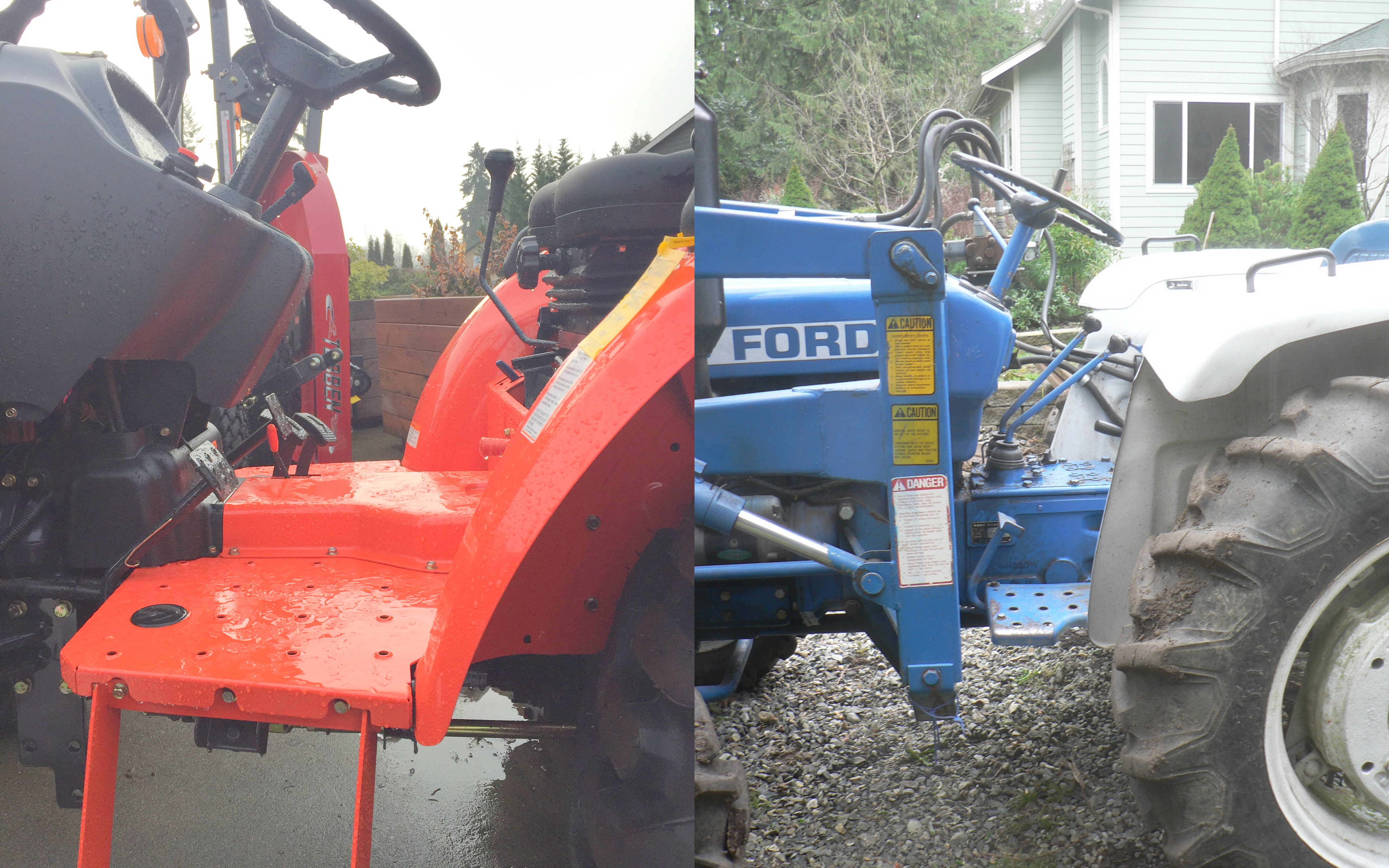

Radio1 - sorry I didn't catch your question sooner. My Ford 1700 was open station. For that matter so is my 2009 Kubota M6040. But if the snow is blowing back all over me as I plow with my rear blade on the Kubota - there are bigger problems that a driveway full of snow.
/ Please help my neck.... #33
Unless you need to get to the hospital and the driveway is full of snow!! Or that hot babe at the VFW is stuck in her driveway and needs your help and you cannot get out!! LOL
/ Please help my neck.... #34
I'm not worried about too much snow in the driveway to get out. Been out here 38 years and it's not yet happened. The closest to that had nothing to do with snow fall. We had our normal 16" on the ground and got a hellacious wind out of the SW. Drifting in two spots on the mile long driveway. Still, I was able to, quite easily, blow thru the drifts in my Jeep.
My first tractor was a brand new 1982 Ford 1700 4WD. It wasn't heavy enough to bust the berms that form from plowing with the back blade. Therefore - the 3-point blower. God knows - I learned to hate that blower. Clearing the yard, driveway and mailbox area would take three plus hours. By the end of one episode the shoulders and neck would be in pain for the following day or so. And, try as I might, I would always end up covered in blown snow.
Now my 2009 Kubota M6040 weighs 10,100# and the heavy duty Rhino rear blade will bust back any berms that may form. Plus there is no longer any blown snow to drift back and cover me.
