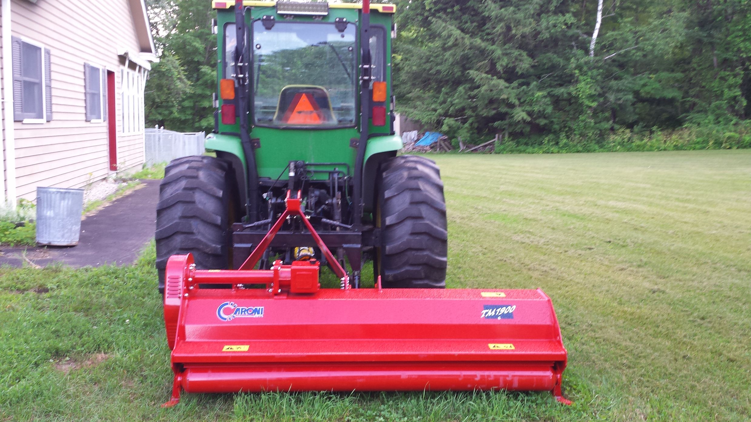

Agri-Supply offers the Caroni brand mower:
Search Results | Agri Supply(R)
The two narrower flails (59" and 47") appear to be centered behind the tractor. I know the 73" mower has two positions, but both are offset to the right.
I have mine set at the maximum offset since that best fits my needs.
If I move the 3PH frame (on the mower) to the other position, it's pretty closely centered on the tractor.
