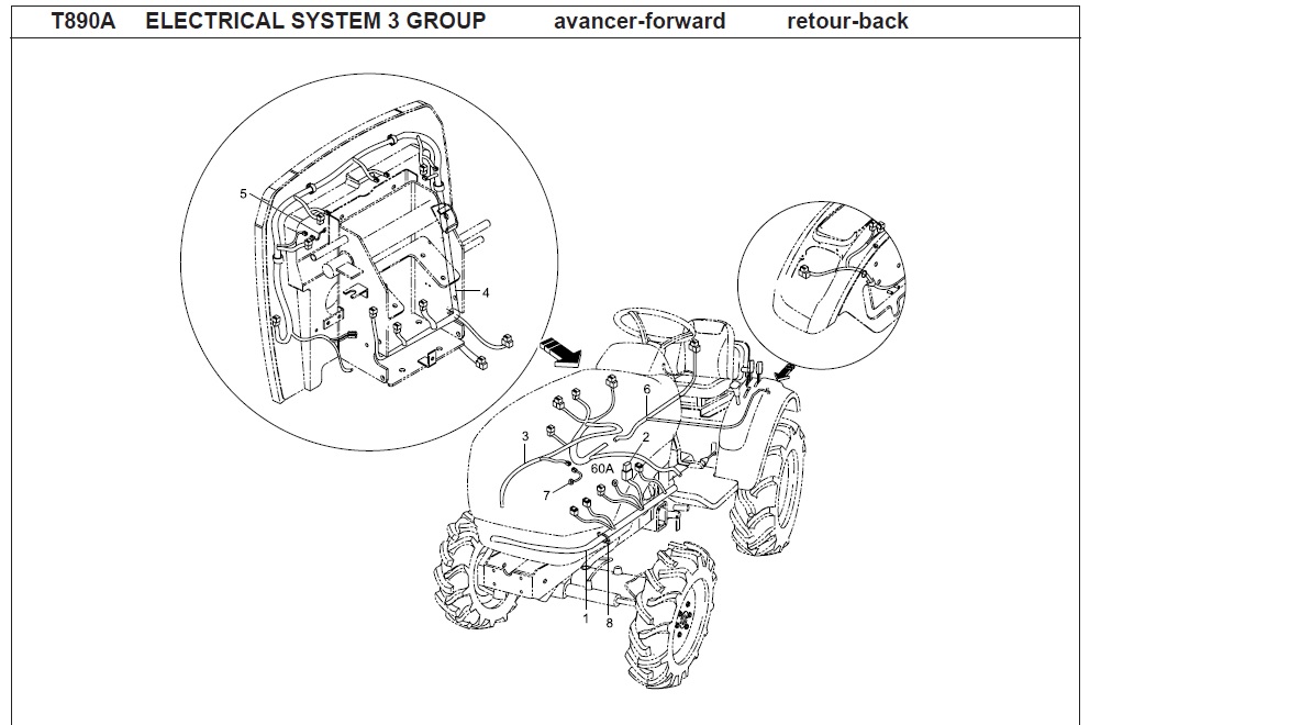

There is a 60 amp fuse on the right side of the tractor (when looking from the front) under the hood. I do not know the exact location, I have never tried to locate mine.
/ Please help! Kioti CK20 won't start
#9
I will look for the 60 amp fuse.. will it be attached to a wire or something as shown in the diagram? I really hope it's just a fuse!! All the fuses in the panel were ok.
I FOUND IT!! It appears to be bad!! What do I do to replace it, where do I go to buy a new fuse? I have never seen one like this before?

I hope this helps.
  • Section 11 Electrical.pdf
  • Section 11 Electrical2.pdf
  • Section 11 Electrical3.pdf
/ Please help! Kioti CK20 won't start #12
The part number I found is 52794-4242-1 a quick google search showed a kioti parts place on line and then a link to ezgo golf carts, so this may be a fuse you can get at a auto parts store or mower repair shop, again never looked at mine don't know anymore about it :(

I REALLY hope that this is the problem. Autozone does have it in stock I think and I am hoping it's the source of the problem. Won't know until the morening but I will keep you all posted. Thanks so much for the help! I cannot believe that my owners manuals don't mention anything about this fuse!

The fuse fixed the tractor. You are a lifesaver! Thank you so muich!
