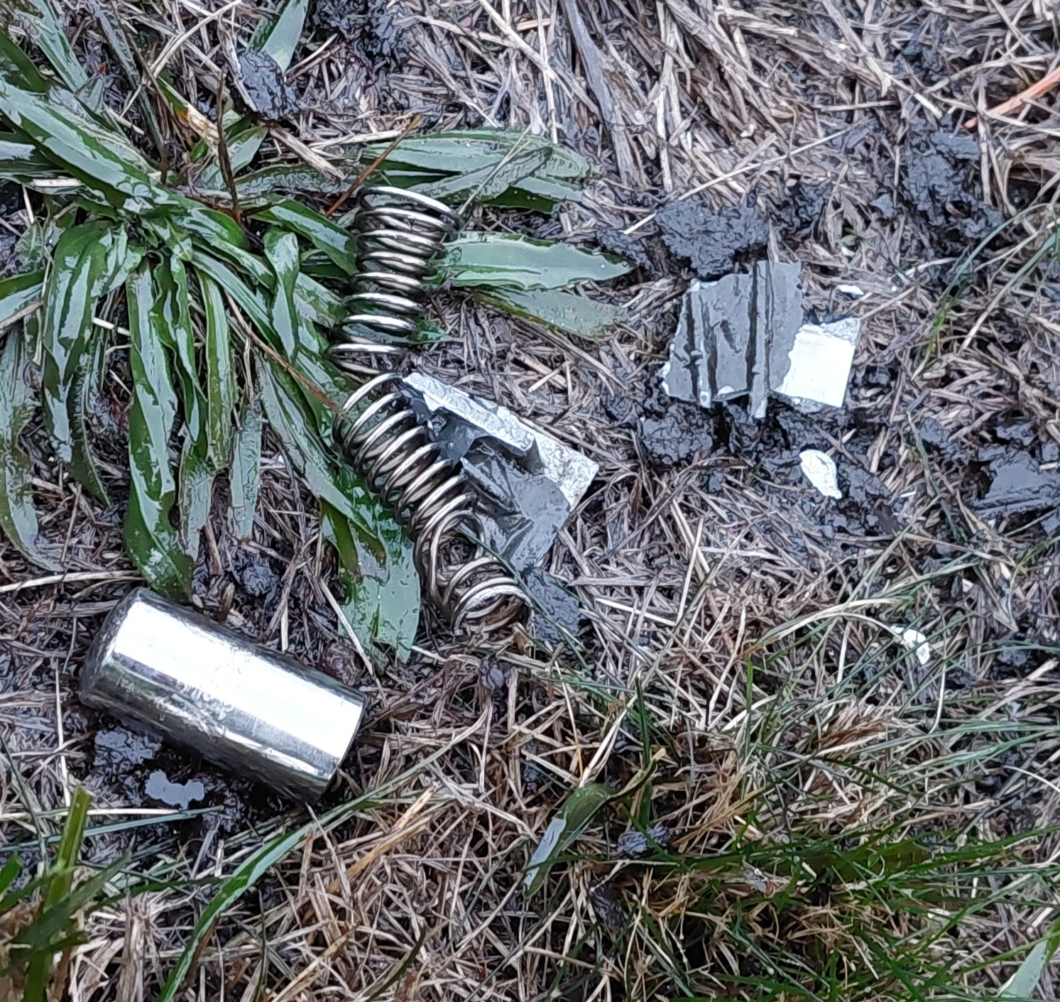

Relief valve failure? How could those parts just blow out of the bottom of the hydrostatic transmission? Was the bottom of the trans damaged by riding over a large rock?

1 spring, kinked in the middle. The HST is very unhappy.
Ya for sure! At least it solves the mystery of why the damn thing wouldn't pull a 1% incline lol.

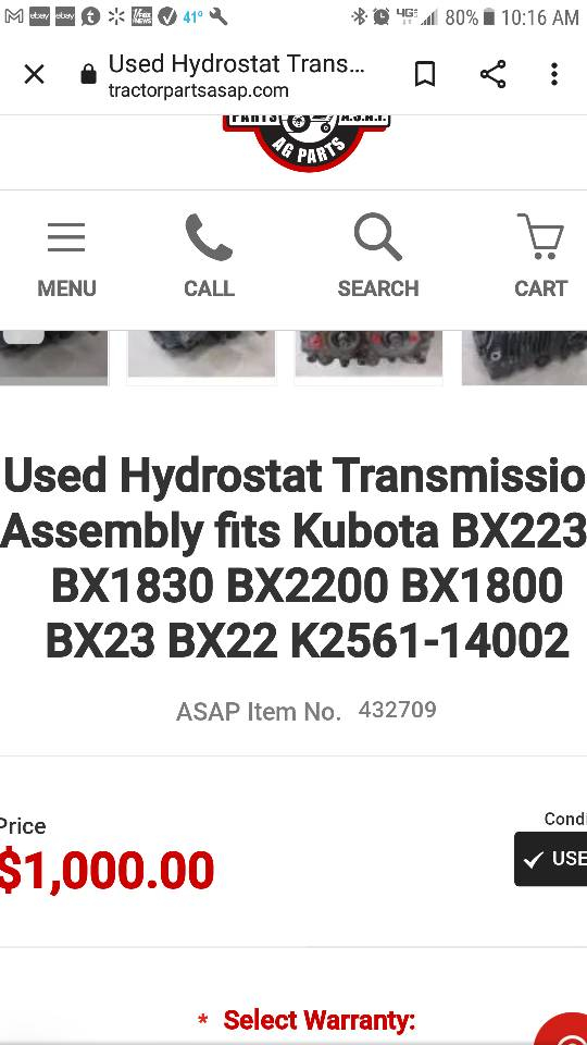

The one i posted the screen shot of is 45% of kubota price. 2yr warranty is $100, but i have no idea what it covers.

I have a 2004 BX22 Kubota that I bought used with 600hrs on it. I was very excited to use it for the first time (and stupid) even after noticing a hydraulic leak from the backhoe hose. After mowing, I got it to the trailer and it did not want to move forward or backwards but you could hear the HST pump wanting to work. I winched it up on the trailer, fixed the hydraulic line and put fresh hydraulic fluid in. I have probably put 30 hours on it since then but I have noticed it does not want to pull even the slightest of hills all that well. A few times I've actually had to pull it out backwards out of the blackberry bushes because the tractor was not seeming to transfer the power from the transmission to the wheels. I have noticed in the mornings it pulls the little hill better probably because of the viscosity of the oil being thicker.
So last week while mowing the grass and going up the lil hill the transmission made a bunch of noises and then started gushing fluid out of the bottom. If you look at the attached pics that's what I saw underneath it.
I believe the leftover pieces are from the pump off the HST? Learning about them since then, I think that is a pump piston as well as the spring that goes inside of it, with a piece of casing lol...

If that is what I think it is....It's gonna cost! It looks like a valve and spring from the HST valve blocks. I had to replace them on my BX24 a few years ago. $350+ each for the valve blocks. My question is How did it get outside the transmission casing? There would have to be a sizable hole in the HST casing to allow that valve to get out!

In looking at exploded parts diagram a possible place that piston came from is if the motor thrust bearing swash plate assembly disintegrated allowing the piston to come out of the cylinder block and thought the housing. other more unlikely option is if the motor drive shaft broke allowing cylinder block to move sideways and then piston becomes lawn ornament.
Agree will be interesting to see pictures of the casting and internals but suspect a severe depletion of cash for this project.
Other concern is where else did the debris go? Other bearings in transmission case, steering system, back hoe. Hopefully not since those are on a separate pump with filtered inlet.
Can u send me that screenshot please?
I have not been able to see that screenshot can you send me that info please.?
