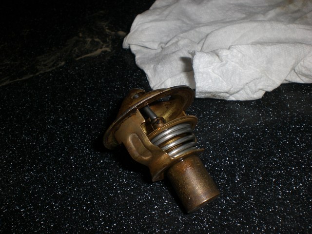

Found the problem...The thermostat had popped open and the guide pin got logged at an angle.

Something fishy going on here? If the top radiator hose was cool to the touch, but the temp gauge was in the red, we would expect to find a CLOSED T-stat. A possible situation that might have occurred is that the t-stat was closed when you felt the top hose, but after you shut off the engine the T-stat popped open suddenly and then got jammed OPEN. Note: Engine cylinder head will gain/rise in water temp after an engine is shutdown ; due to lack of water flow (no water pump rotation).
/ Please check my troubleshooting on overheating issue. #14
Catman has a good point.
Stuck open means that it would be running cold (also a bad thing, but not as bad) not over heating. Could the tractor be "smart" enough to detect a faulty open thermostat and send a signal to the guage as an over heat condition?
