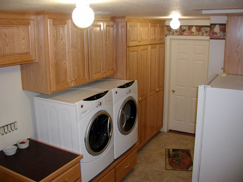

i had a local cabinet maker build me a set with pull out drawers for mine. was cheaper and better than home depot set. Gives great storage for soap, etc. laundryafter1.jpg

We had cabinet shop make and install a base with drawers with Formica top as you will have water sooner or later on it. Yes if you need to move them out for service it will be some pain but you could set up temp platform to slide them onto. 3.4 plywood is all used in ours and it is at least two years old. But it has plywood sides and back and front and also one divider between the drawers giving support to the top.
