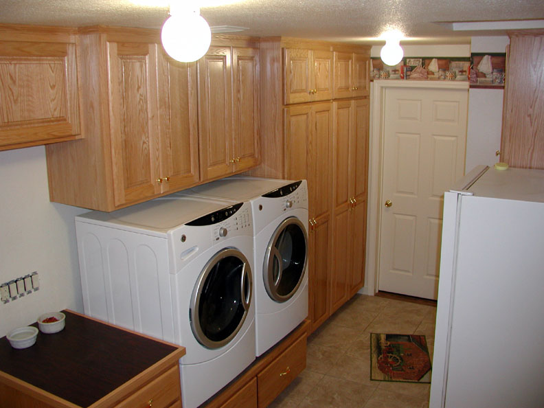

i had a local cabinet maker build me a set with pull out drawers for mine. was cheaper and better than home depot set. Gives great storage for soap, etc. laundryafter1.jpg
