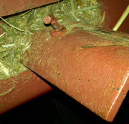

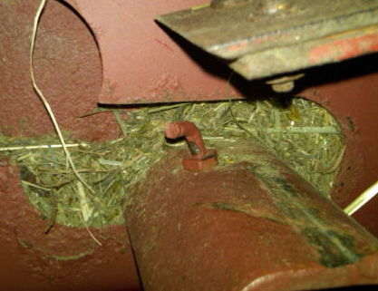

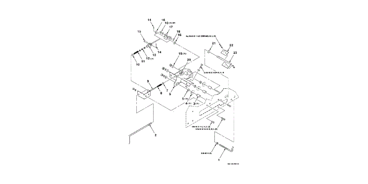

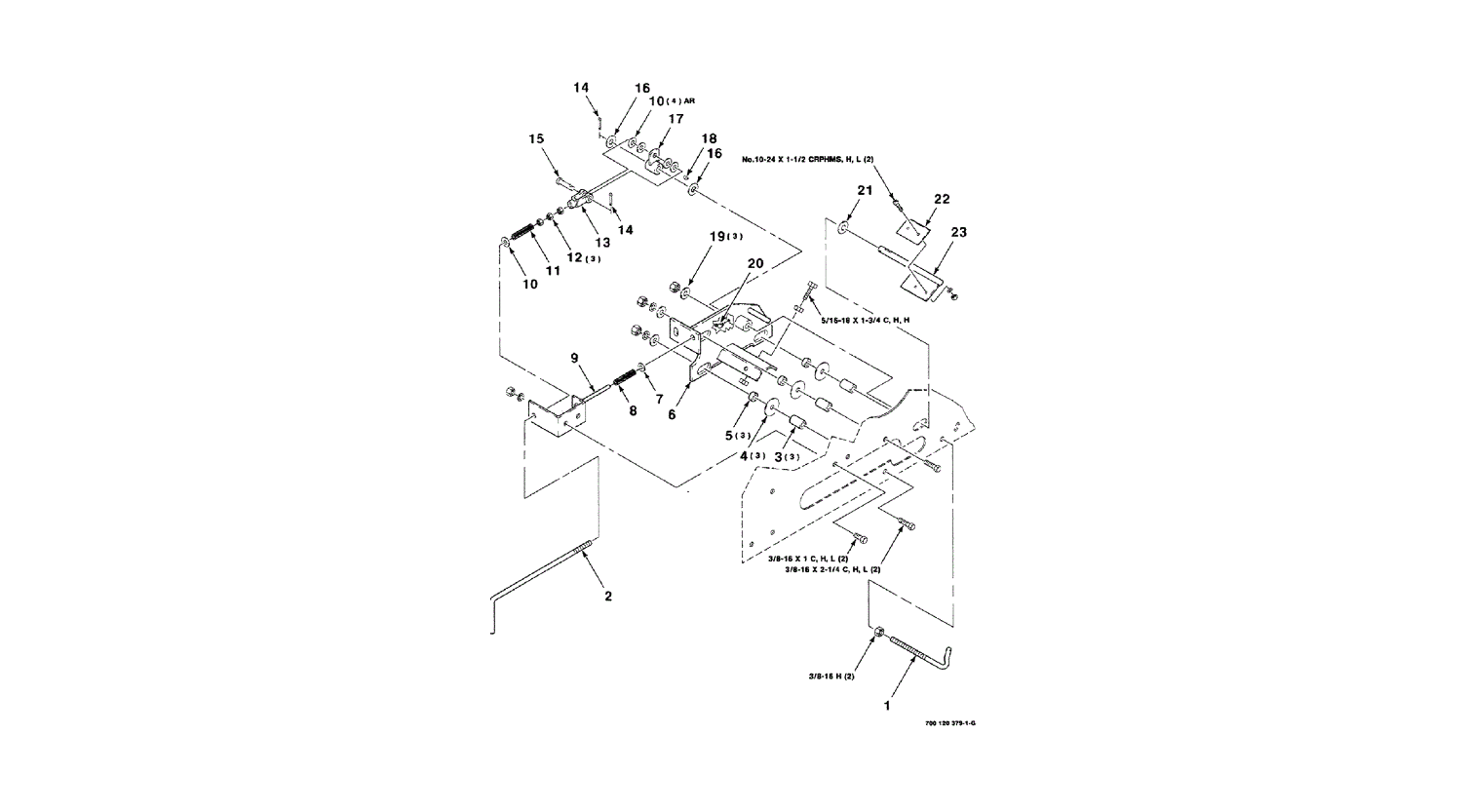

If yours is the manual twine tie like our 8420, then the cutter is not very reliable. You're right that the twine doesn't stay on the anvil. I made a hook to keep the twine where the knife could cut it, I posted pictures here some where. But later I found that Case/Hesston actually made one too (much more expensive than mine!) - part #700117238, "ROD - twine, guide" in the diagram below. If your baler doesn't have one, that could help. (Sorry, that's a crappy picture, the guide is in the lower right - you can see the full size picture on Messicks parts site)
Here's a couple shots of the fix I made. Pretty simple, you just have to make sure the twine arm clears the hooked pin...
