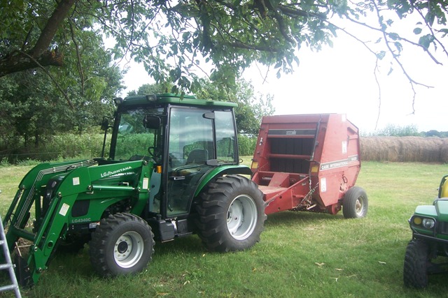

Thats the same baler I have and you will love that little baler. I use the 110 lb (plastic) from tractor supply ... always works well.
Keep the cutter blade clean and sharp ... sometimes the residue of the twine will biuld up on the cutter. Also never twine wrap all the way to the end of the twine marker ... for some reason that misses the bale edge. I stop at the second mark on each end.

Forgot ... that tractor is 43 hp engine ... your baler is designed for 40 hp

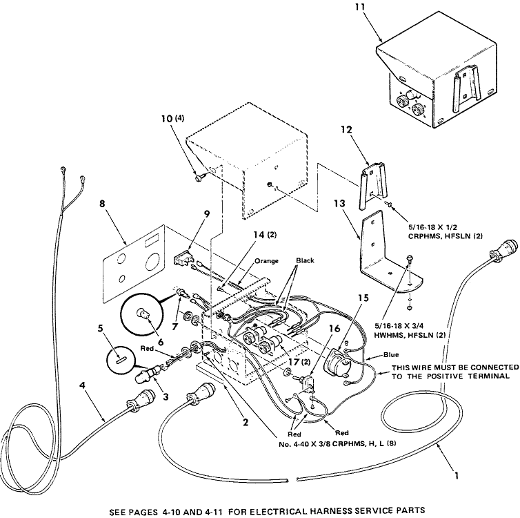

For curiosity sake, I went to Case/IH,and looked up your baler. In the exploded view in the pic below, it shows an audible alarm (#15).
Might be an idea to get a manual for your baler through Case/IH. I've referred to mine more then several times for adjustments, belt repair, etc. Well worth the money...

No audible alarm, but the previous owner said the baler starts to "sound different" when getting full.
I did get a manual from eBay, got it yesterday. :)
