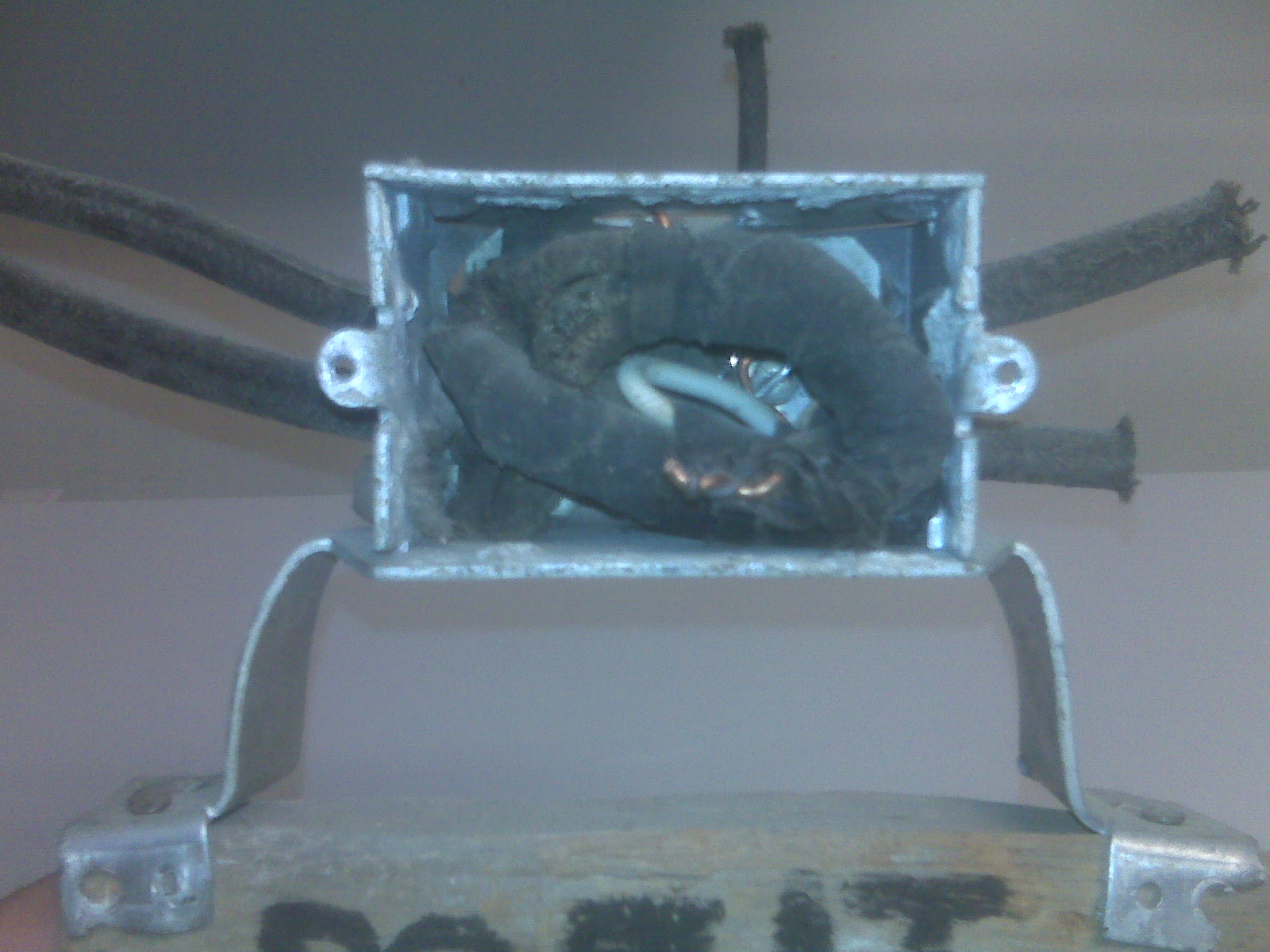

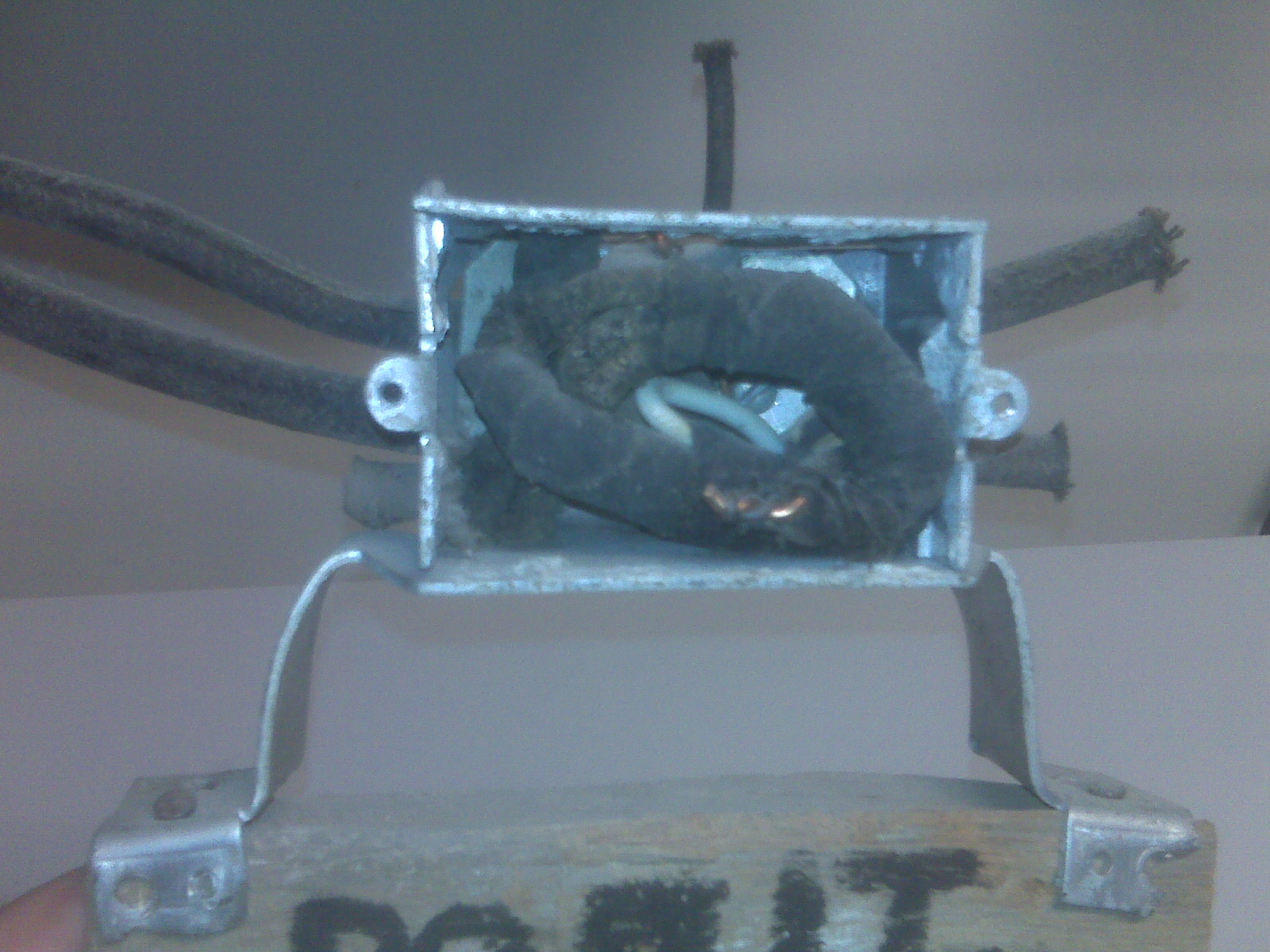

ive found some old work where someone ran a ground to some water pipe. absolutely useless. the ground HAS to run all the way back to the point of origin to allow stray voltage to make it back to the breaker and trip it.
that is one ugly picture there. In the old days, before wire nuts. people crimped the wires together and taped them.
I thought the way that you were supposed to retrofit the old 2 wire romex to ground each outlet was to run a seperate ground wire for each outlet to a groundrod under the house. I swear i read or was told that. May be wrong to, again. By me saying this im not saying i would ever do it or that it was right, but isint the pipe the same thing? This obviously is not right as it will electrify all the drains and faucets.
