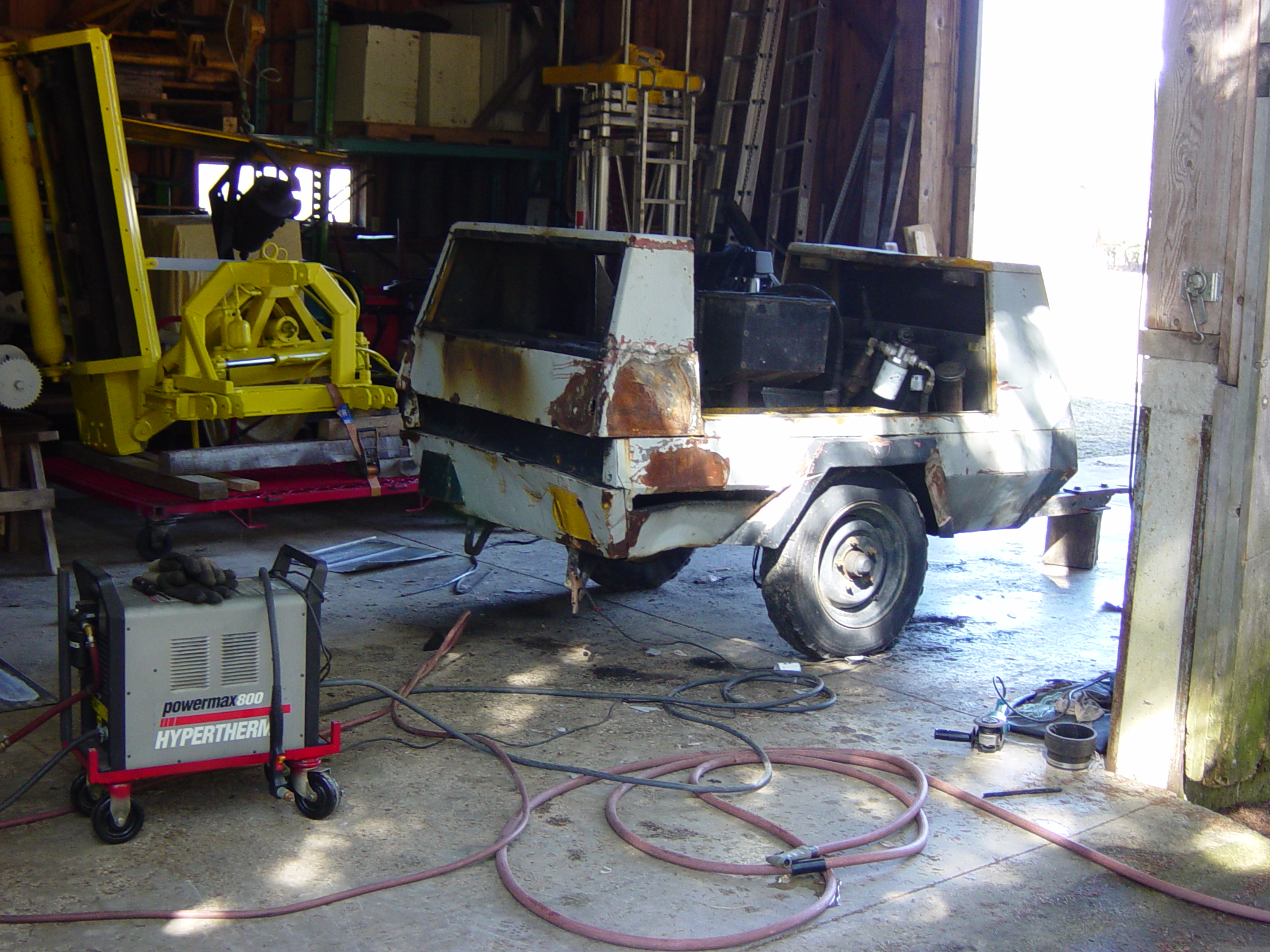

In truth, wrecking something like this is about the only thing where I have ever been totally satisfied with the plasma. Sure beats setting fire to the barn with a torch. I just noticed water hose in picture for safety.
