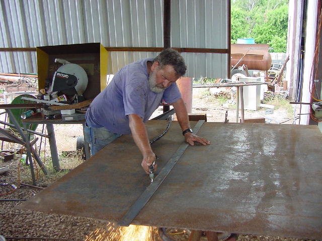

This is three sixteenths plate that started out five by six. I picked it out of drop cause it was odd shaped, weathered aka patina or character, for making some plates for trusses on an open cedar ceiling a friend has.
Ignore the hansome operator of the torch. But do notice there isn't any clamps on that quarter by two straight edge. And please everyone don't try this at home. You're watching a professional in action. /w3tcompact/icons/laugh.gif The camera operator has the safety gear. /w3tcompact/icons/laugh.gif/w3tcompact/icons/laugh.gif
What I've found works best for cleaning slag after a plasma torch cut is a chisel. Not sharpened like a cold chisel where both sides come in to a point. But like a the edge on a wood chisel where one side is flush flat and the other is sharpened down to it.
I'm not saying to use a wood chisel. What I have is a cold chisel I've reshaped in the form of a wood chisel just for cleaning slag. If you slide the chisel along the face where it contacts the slag pushing it back towards the cut you will be surprised how fast and clean it all happens. It's faster and safer than using a grinder. It's also cheaper since all you're spending is energy and an edge of the chisel you need to refresh once every generation or two.
If you look behind that fine figured man with the great personality you will see a chop saw. It isn't just an old chop saw btw. It's welded down into place where it cuts perfect forty fives each and every time.
Now if you can't dedicate a chop saw to just forty fives then you can do what I did before I could dedicate one just for that.
I found the perfect forty five on the saw. Then I drilled through the fence and frame on the saw so I could bolt it when I needed a forty five cut.
You can't trust the marks on the saw. And if you don't have it welded or bolted in place the fence it's going to crawl. Your forty fives are going to become forty fours or threes and then twos. I use a speed square against the blade to orient the fence. It just makes things easier.

Don this cut is being made with a steady fast pull. What I've got going is first and foremost I'm not exposed to the light from the torch. I am dragging the tip against the steel. So I have that and my hand shielding my eyes. All I'm doing is trying to keep a smooth movement.
I'm only using the straight edge as a guide. I'm not putting any pressure against it at all so I don't have to clamp it.
Another thing that's really nice about a plasma I've found is I don't have to worry as much about torch speed. If I hit a corner and I need to reorient my body to continue the cut I keep the torch going and do so. It isn't like with a gas torch where you change the whole dynamics of the cut with a change in torch speed.
Another thing some of you might like is my sawhorse. It's made of lightweight round pipe. The top is thirteen inches wide and it's six feet long. There's a shelf underneath for holding things when the job requires for the work bench to also be a tool holder for the tools you're not holding at the moment.
Sitting on it in this picture is a piece of five feet by six feet three sixteenths steel. I'm not sure just what it weighs but when bro in law helped me put it on the horse he got that look in his eye like he'd just lost six years of good *** life when we lifted the plate.
I have two of them, saw horses, not *** lives, and find them handier than a pocket on jeans.
