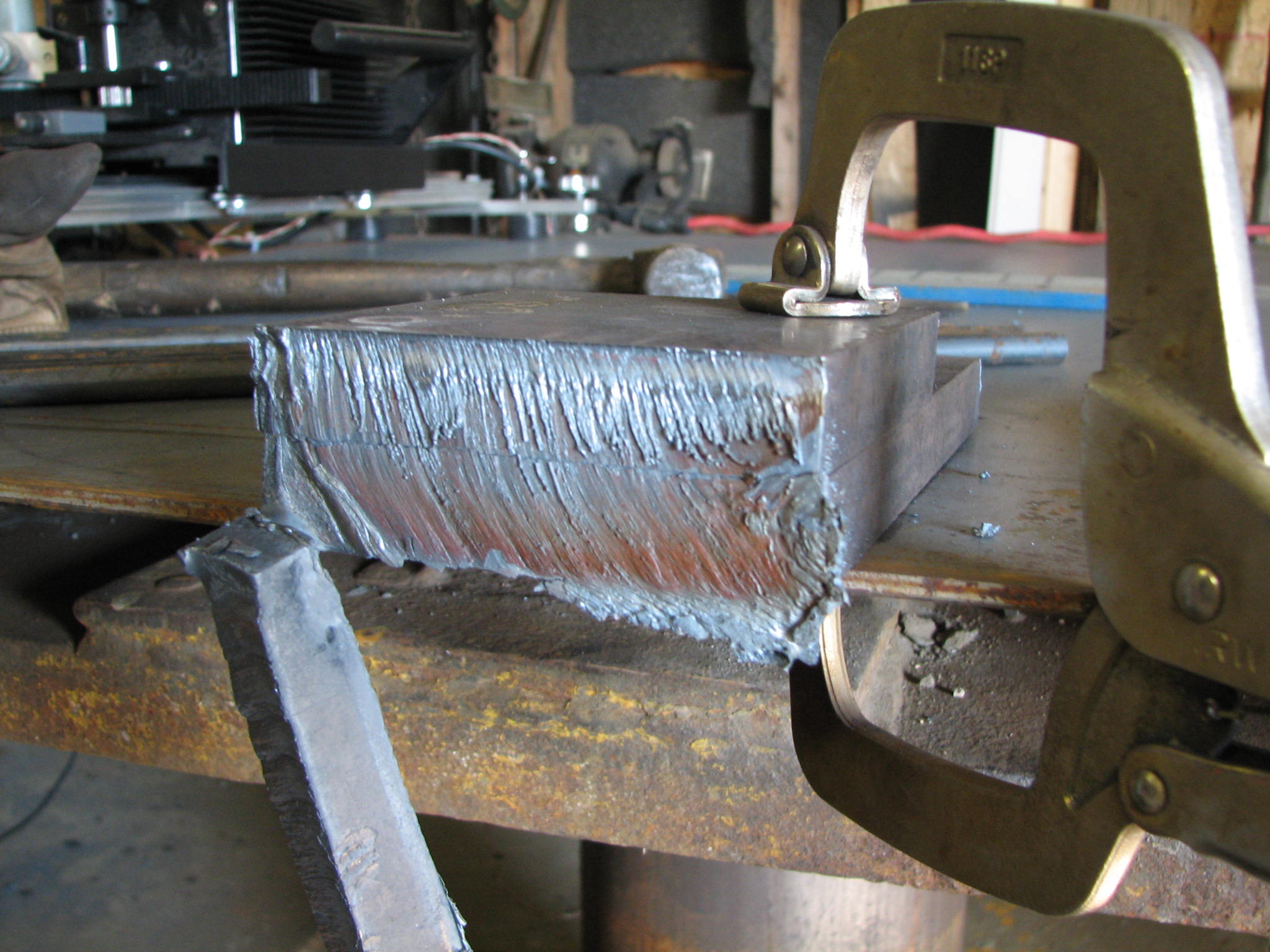

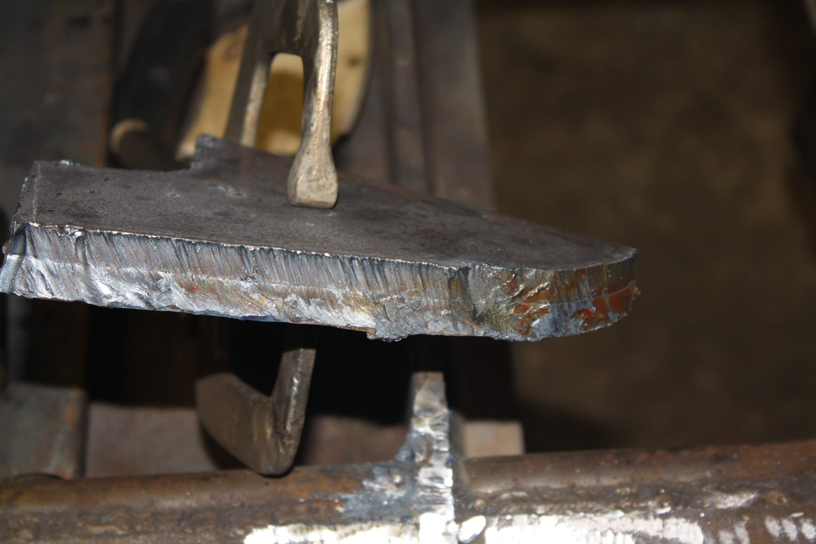

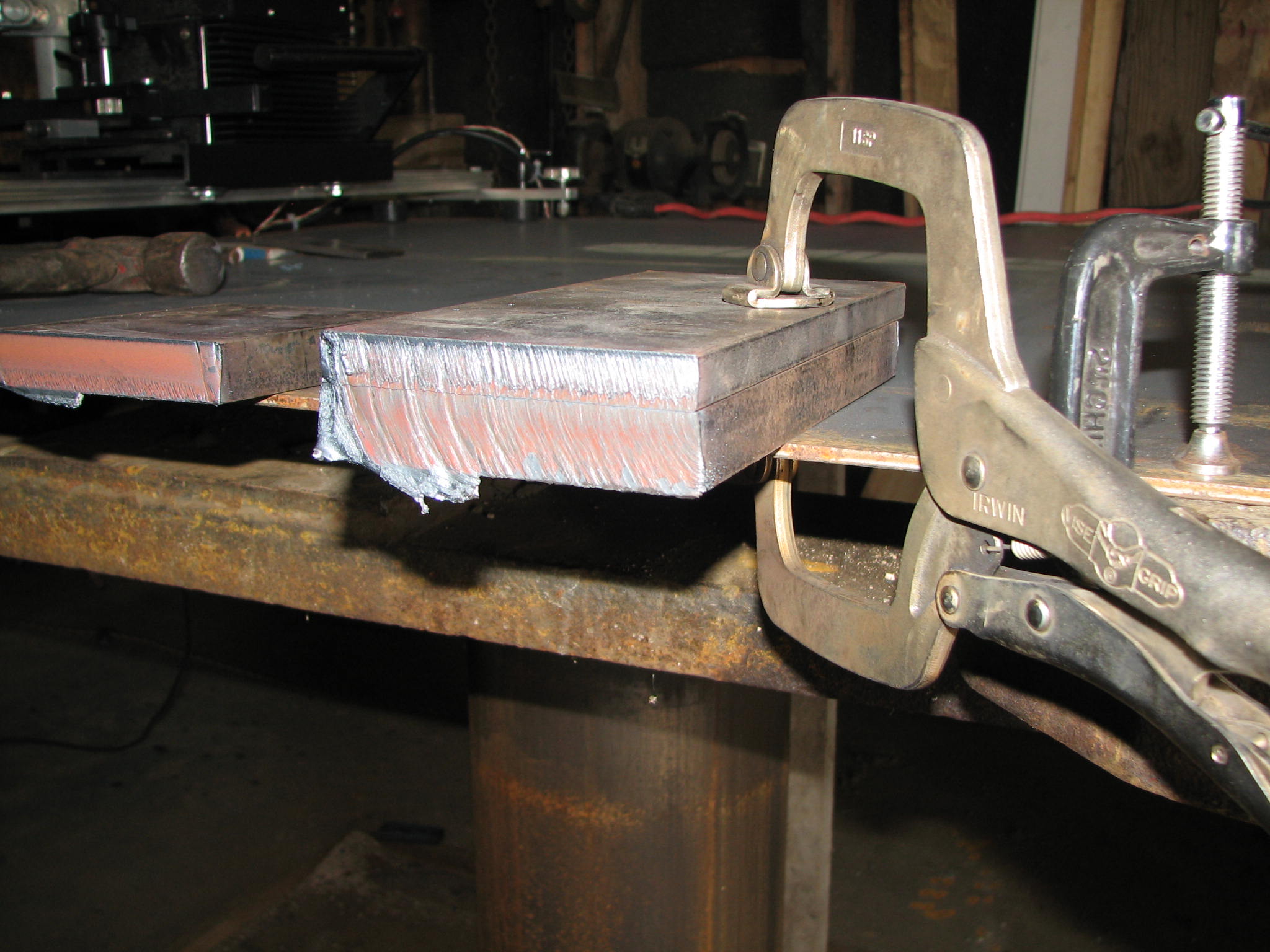

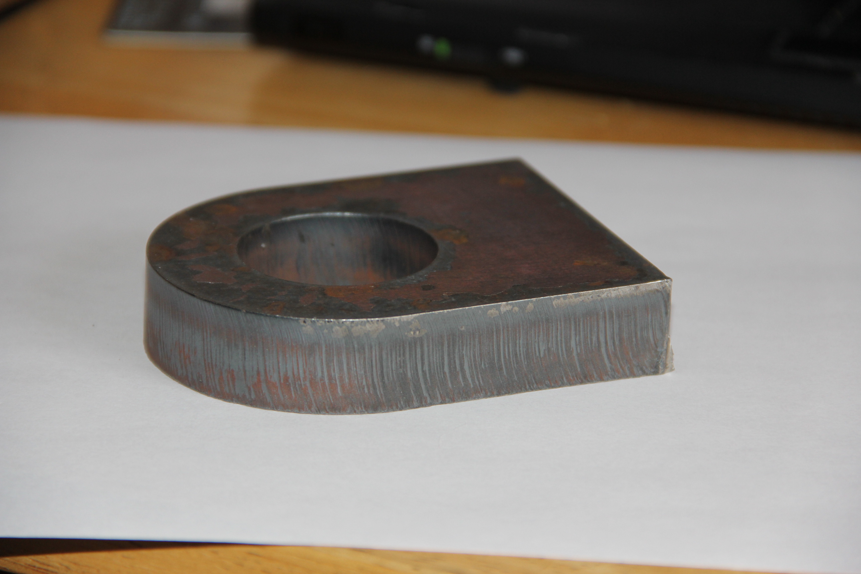

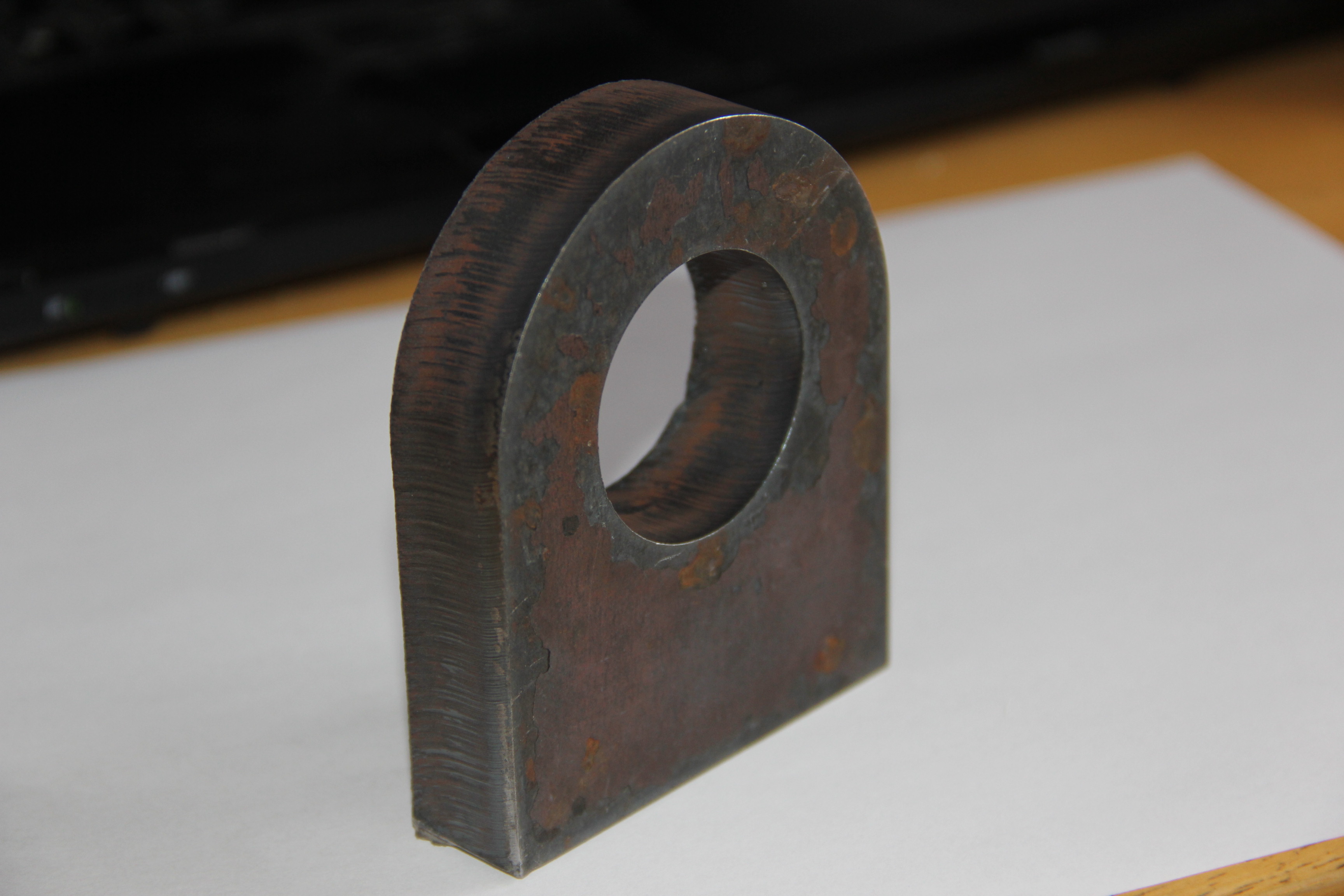

Here is a picture of 3/4" steel that was pierced and cut with a Hypertherm Powermax85 on a cnc machine (PlasmaCam). The torch pierced from .25" off the plate, took 1.2 seconds to pierce through, then automatically indexed down to the cut height of .06" off the plate. The cut speed was 33 inches per minute.
A good quality 30 amp plasma will pierce 1/4" and sever 1/2", a good quality 45 amp plasma will pierce 1/2" and sever 1". When I say pierce...that is the maximum that the unit can pierce without consumable parts being damaged by the molten metal blowback. Severance is the maximum thickness cut where the cut speed drops below 10 inches per minute. Generally...if you want a productive plasma you should get one that will be used at its pierce thickness as a maximum production thickness for best results.
Jim Colt Hypertherm

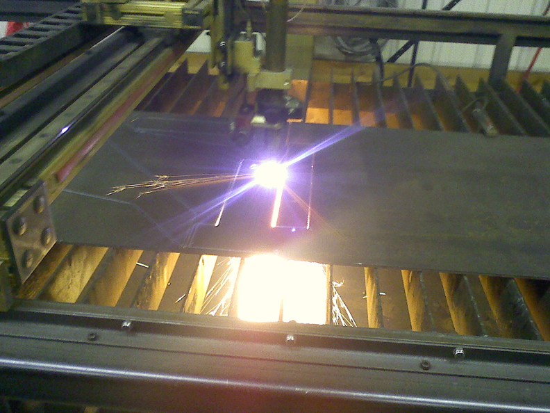

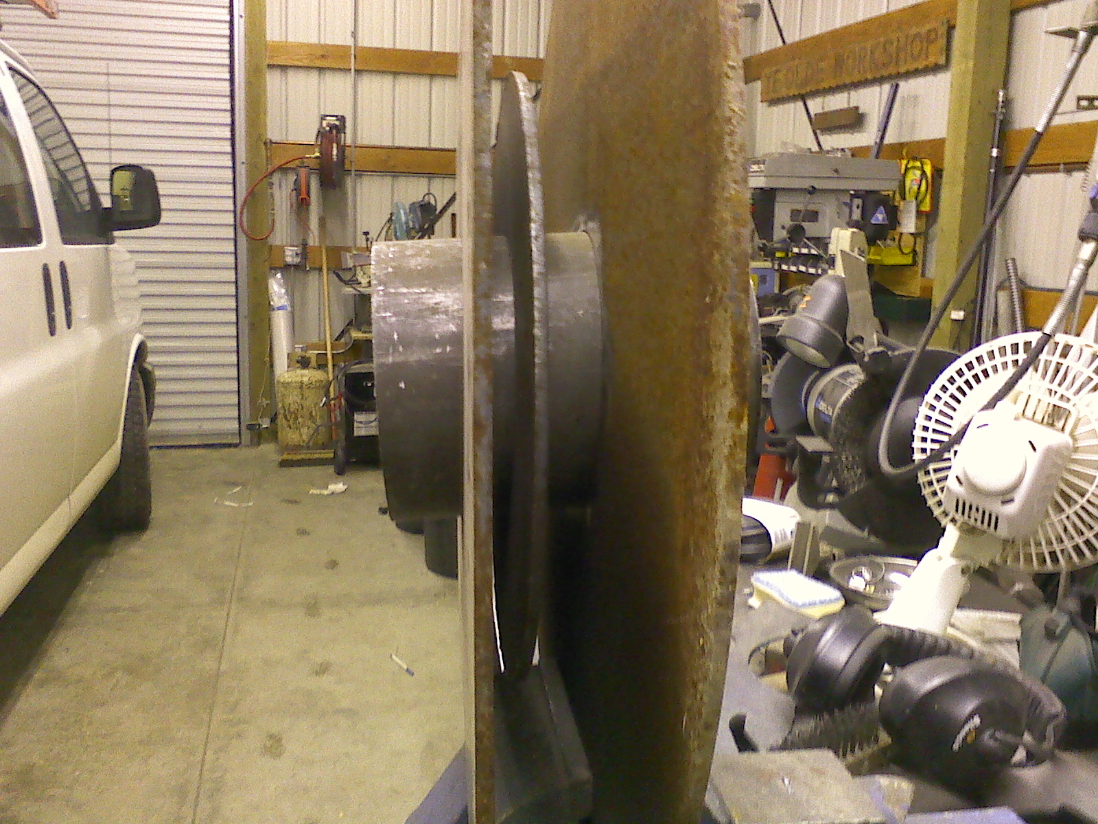

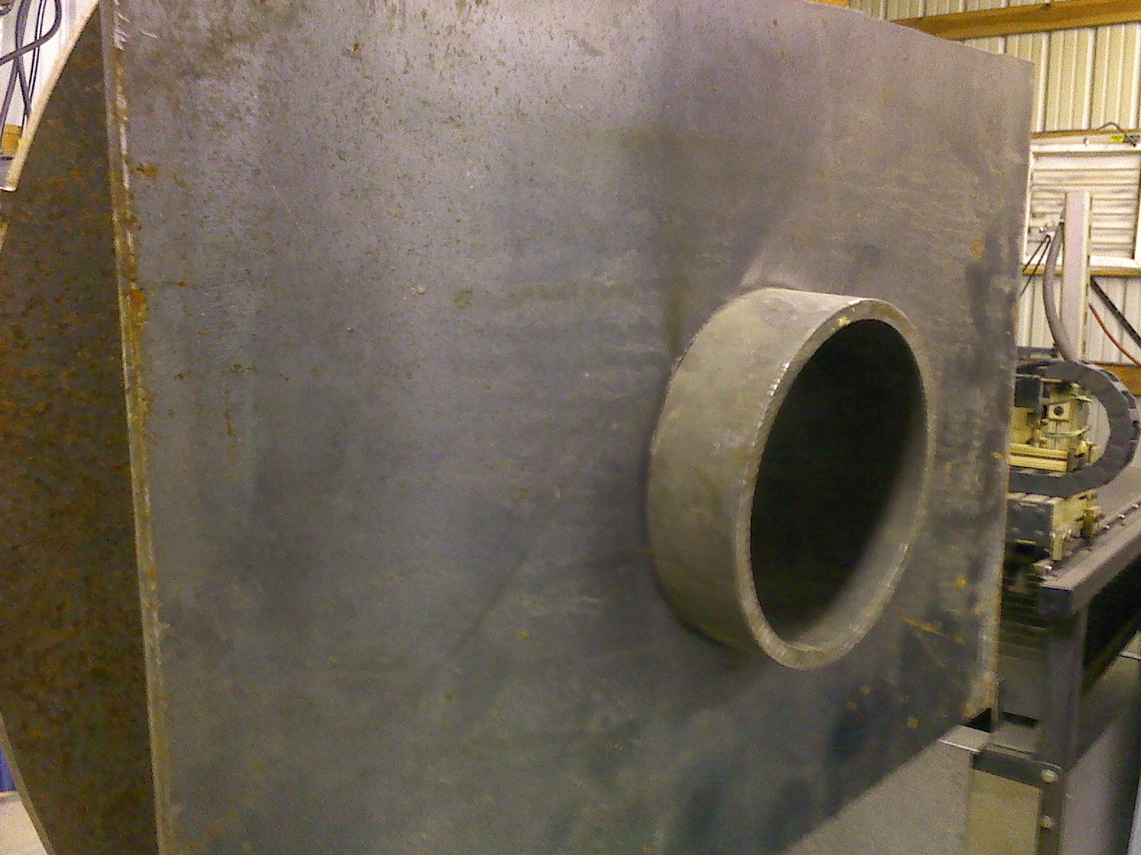

i just cut 3 scrap 3/16 plates for a friend of mine thats going to make a 5th wheel for a horse carriage. heres the fit. mines a cnc machine also (dynatorch). im real happy with the cuts. it does each circle in about 30 seconds. 60 amps hypertherm powermax 1000.

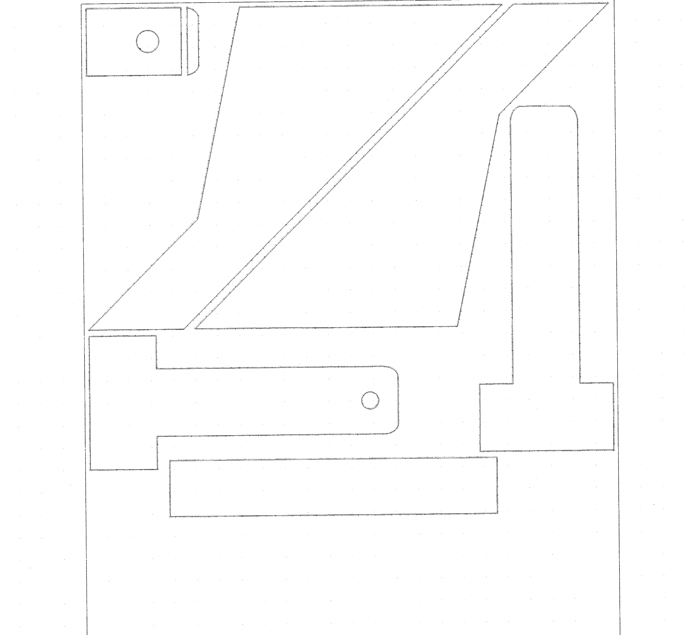

I'm making a bucket mount trailer hitch for the new Kioti tomorrow. it took about an hour to design the thing with auto cad/coral software. i scanned a rough picture of the cuts.
i have to design it first, then convert the drawings to a Vextract (outside line drawing), then convert this using a program called Enroute. The Enroute program sets all cut parameters, feed in and outs, etc. It also nests the cuts to minimize loss.
Ill cut these on my Dynatorch system today or tomorrow. All the drawing and computer work for this design took about an hour and a half ( as i was playing with a few different possible designs). the cutting will take 5 minutes.

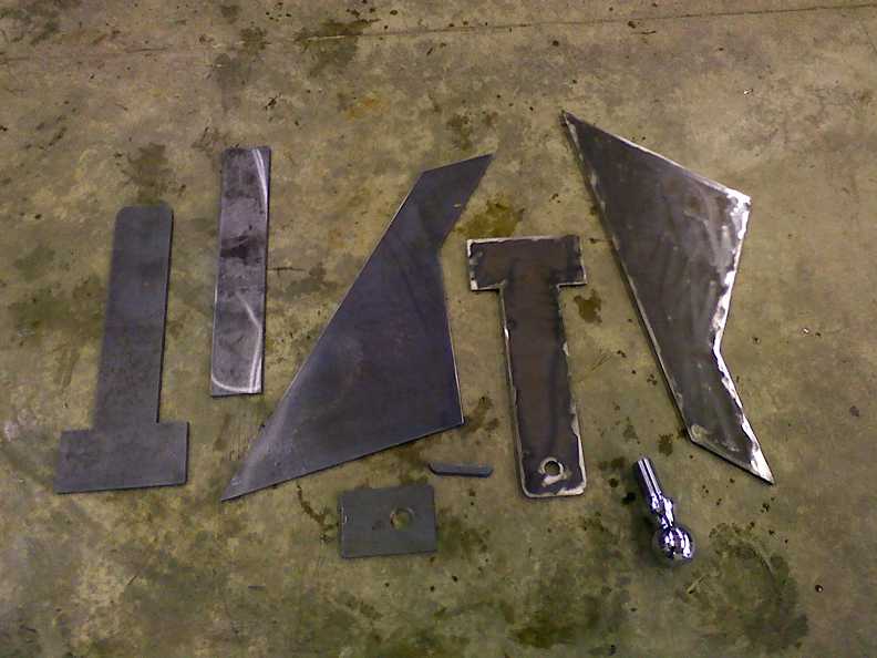

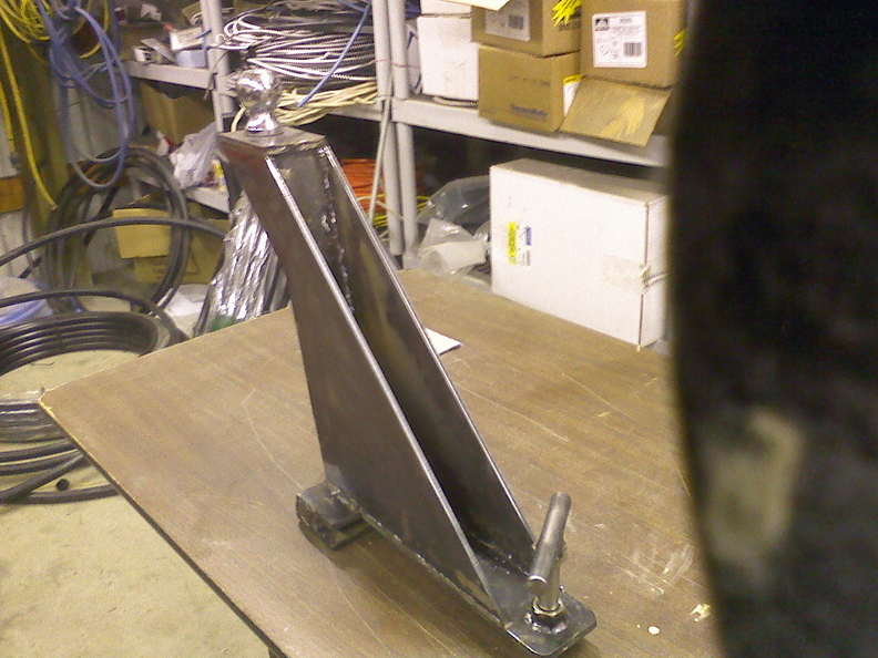

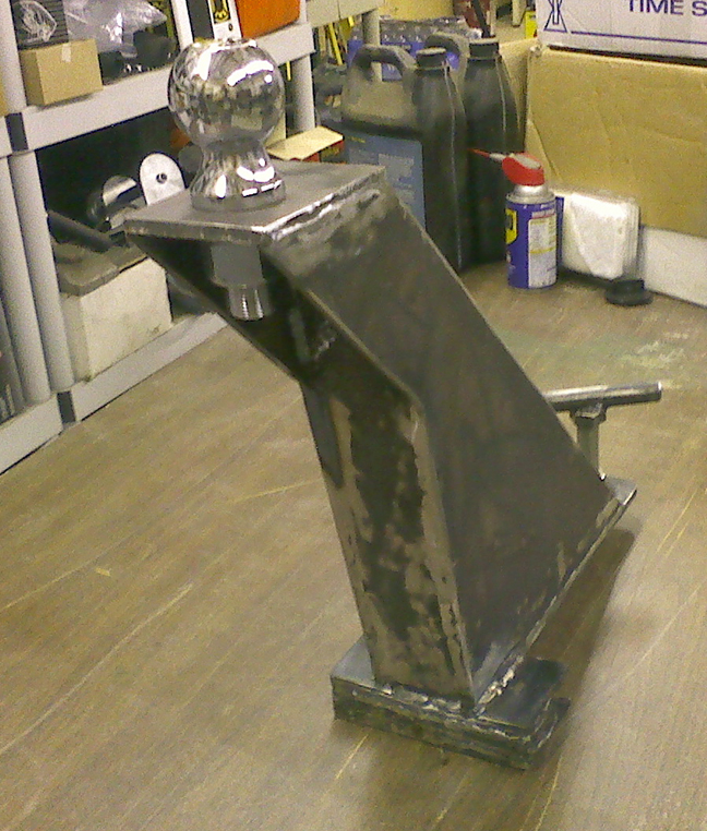

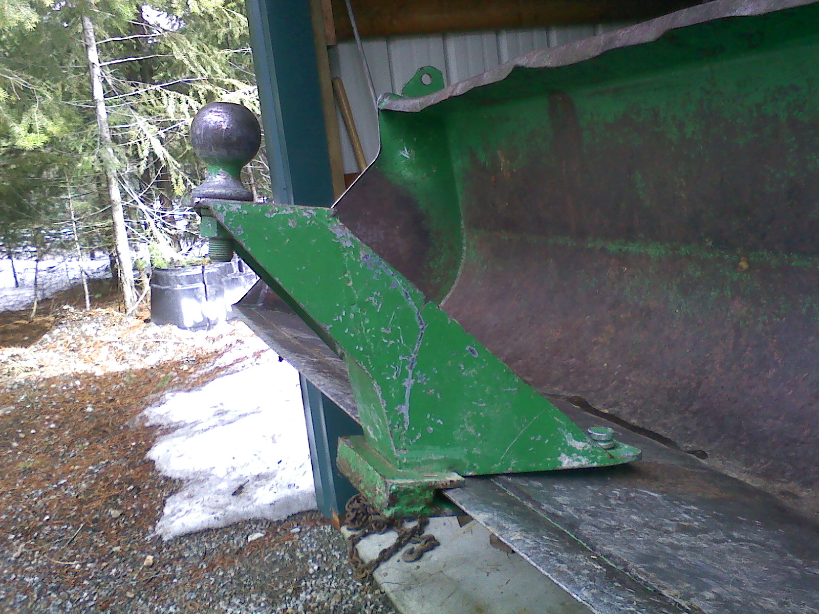

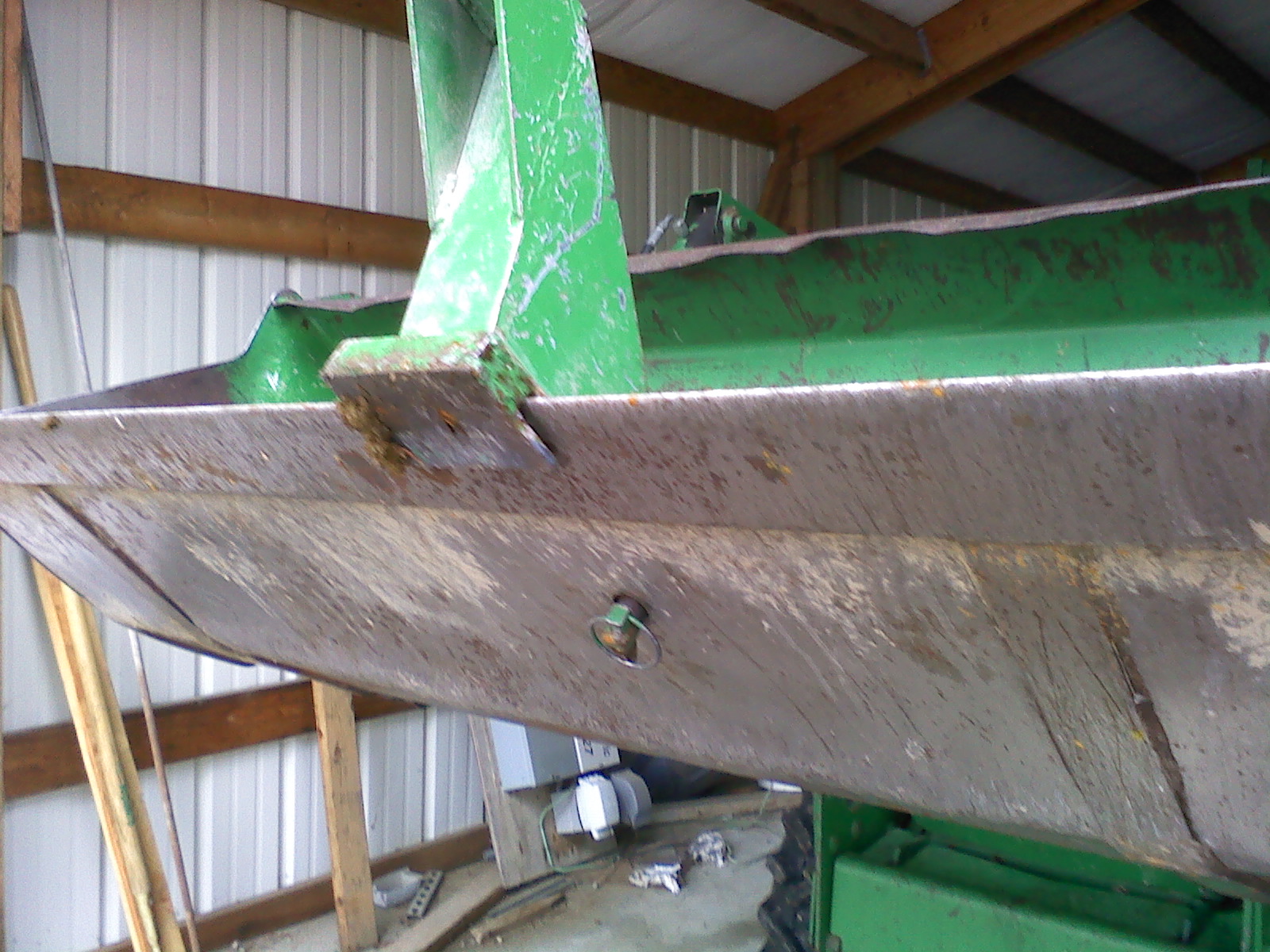

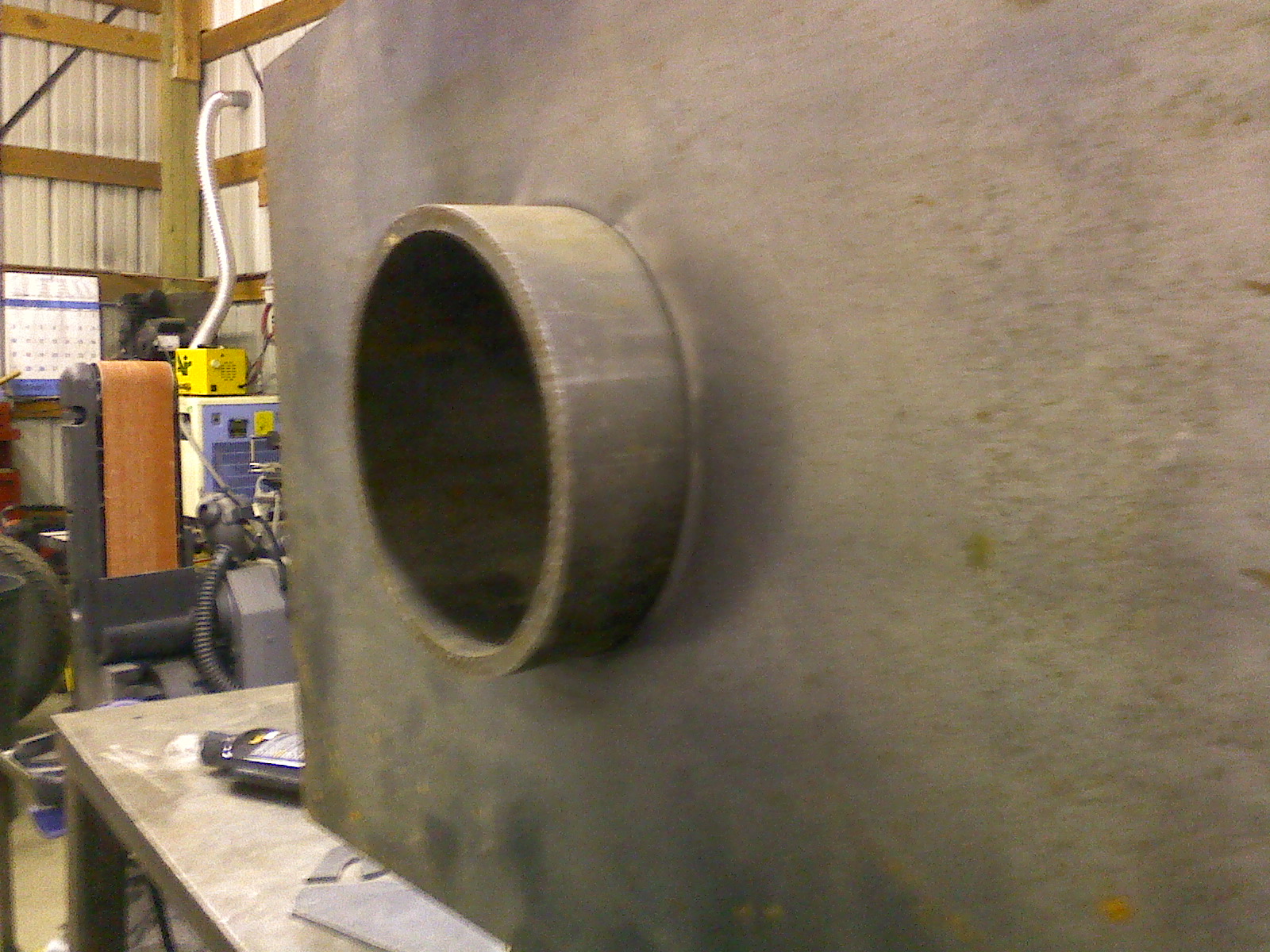

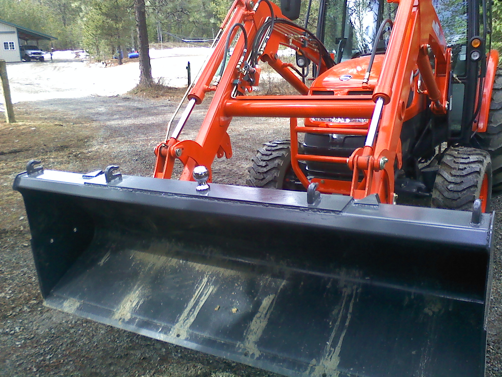

made my little bucket mounted trailer mover on sunday....i do love playing in the shop.
heres a few pics. have to still paint it. I set it up with a rear t shaped bolt in back that i will pass thru hole in bucket and attach with either a latch pin (most of the time) or have option of 3/4" nut and washer for loaded trailers for added security.
It mounted to lower lip of my bucket, and i can see the connection point where the ball meats the trailer hitch so i dont have to get out of the cab.
I added a 2-5/16 ball to top of re-enforced area on my bucket to move gooseneck horse trailer.
This is a larger version of one i made years ago for the JD.
