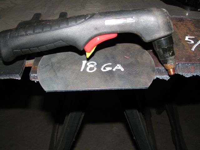

I didn't say originally which cutter I got, as the discussion had gotten pretty acrimonious at the time. I didn't want to fan the flames, so to speak. Now that things seem to have settled down, I can say that I got a Hypertherm Powermax 45. It was comparatively expensive, but after reading all the reviews and comments, I figure it's money worth spent. It's now sitting in my shop, awaiting my attention - when I have the time and it's not eleventy-billion degrees outside :p
I'm in exactly the same position as perplexed, regarding the Hypertherm Powermax45
Hopefully in the the next week or so., I'll get her up and cutting.

From the pictures the Harbor Freight looks very similar to about 6 or 7 other brands of Chinese built plasma systems....but I honestly have not looked at their latest offering. In my opinion...one of the issues I have with these iumports is that they change their designs very often....instead of settling on a good design with minor engineering changes. I'm concerned that when parts and repair become necessary a few years down the road that it will be difficult to get the correct parts or service. A lot of these manufacturers are riding the bandwagon of "New IGBT technology", when in fact it is not new...and will not solve all reliability issues...although the IGBT units definitely should have better reliability than MosFets.
When you are looking at the low cost imports I would recommend buying fom a reputable supplier with good customer feedback...poll the end users on this site and others to see what kind of experiences they had with performance and support. Also, remember that plasma systems are not all created equal...there are reasons why the lower priced units are lower priced! Any sales person will tell you that their product is as good or better....the differences are outined in one of my previous posts.
