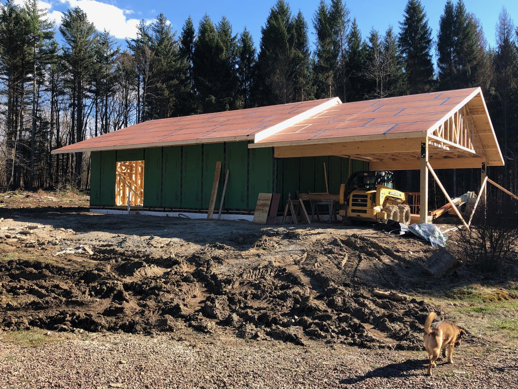

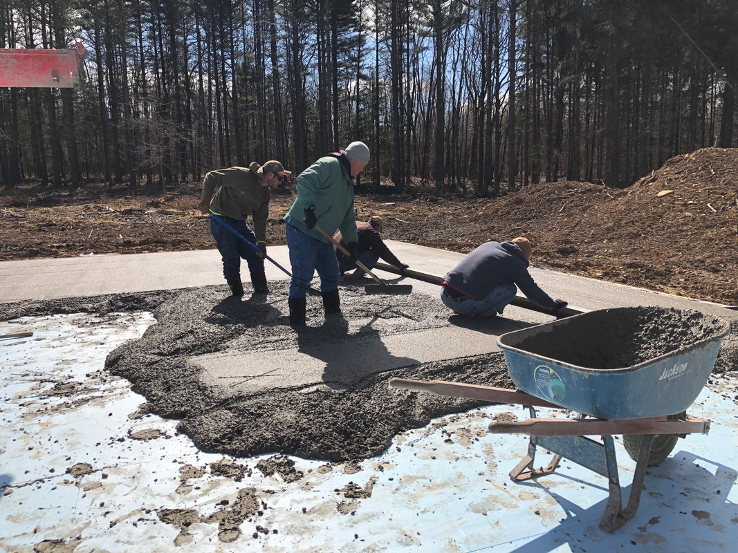

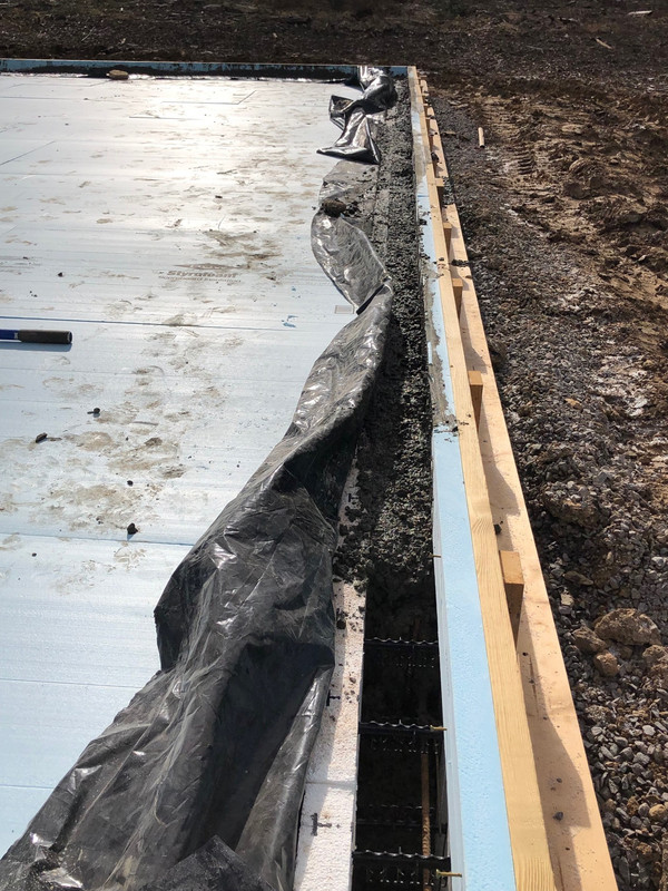

Well they had the plastic *under* the foam and were ready to pour when I got there. They said that's the way they've done it and never have had a moisture problem with a basement or slab since doing so, so I reluctantly let them continue. They also had screw heads 2" exposed into the concrete side that had been screwed through the foam into the treated band board. The idea was the poured concrete would compress the plastic through the screw heads so the heads would be imbedded in the concrete which would secure the band board to be followed up by using Tapcons. That didn't work out as the concrete did not force the heavy plastic to be penetrated by the screw heads. The band board was attached to the edge of the slab by Tapcons the next day before the supports were removed. It made me feel a little better that compacted gravel would have a difficult time puncturing through that tough plastic.
Filling the ICFs first so plastic could cover the stem wall and up the edge.
5 1/2" concrete floor poured.
Framed and braced.

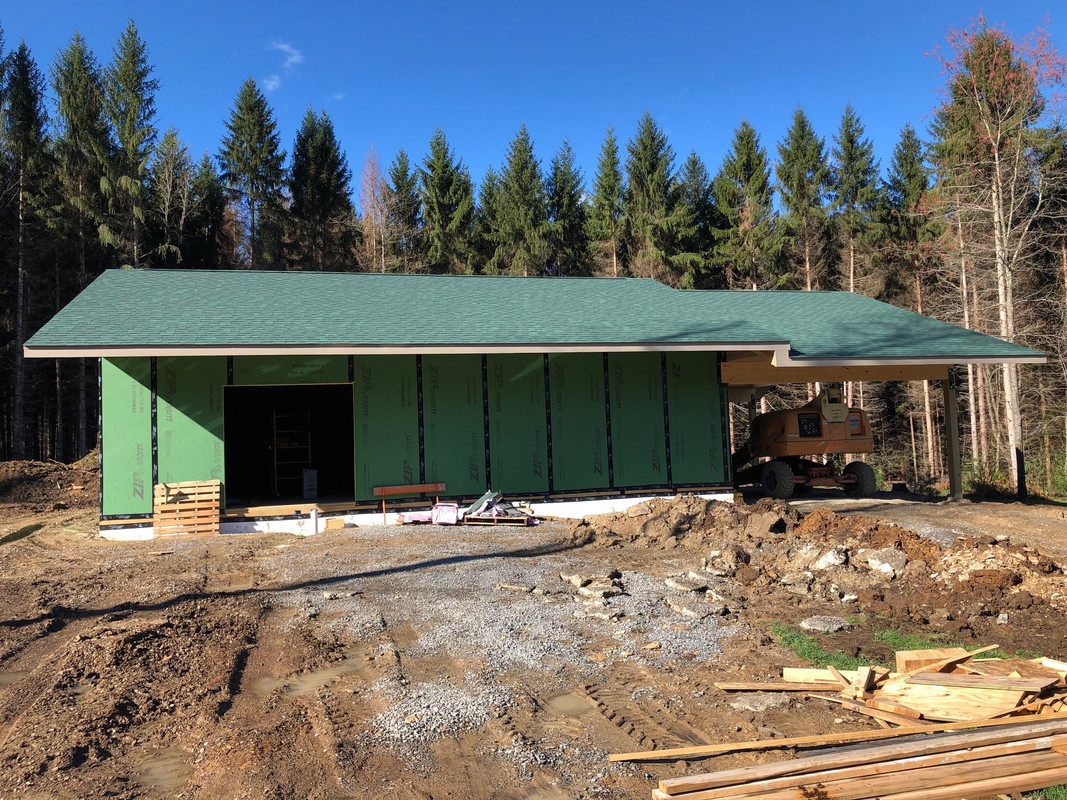

Sheathing on and carport piers and beams done, trusses next.

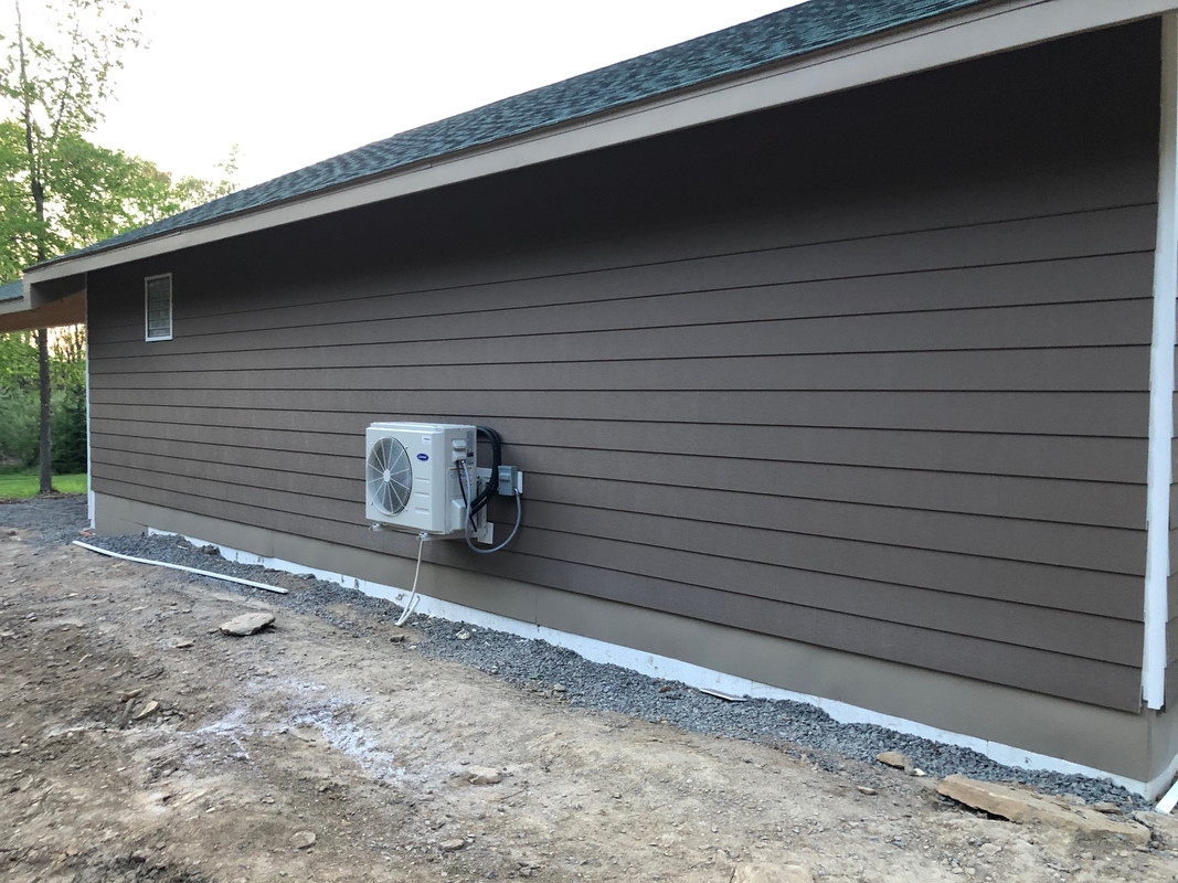

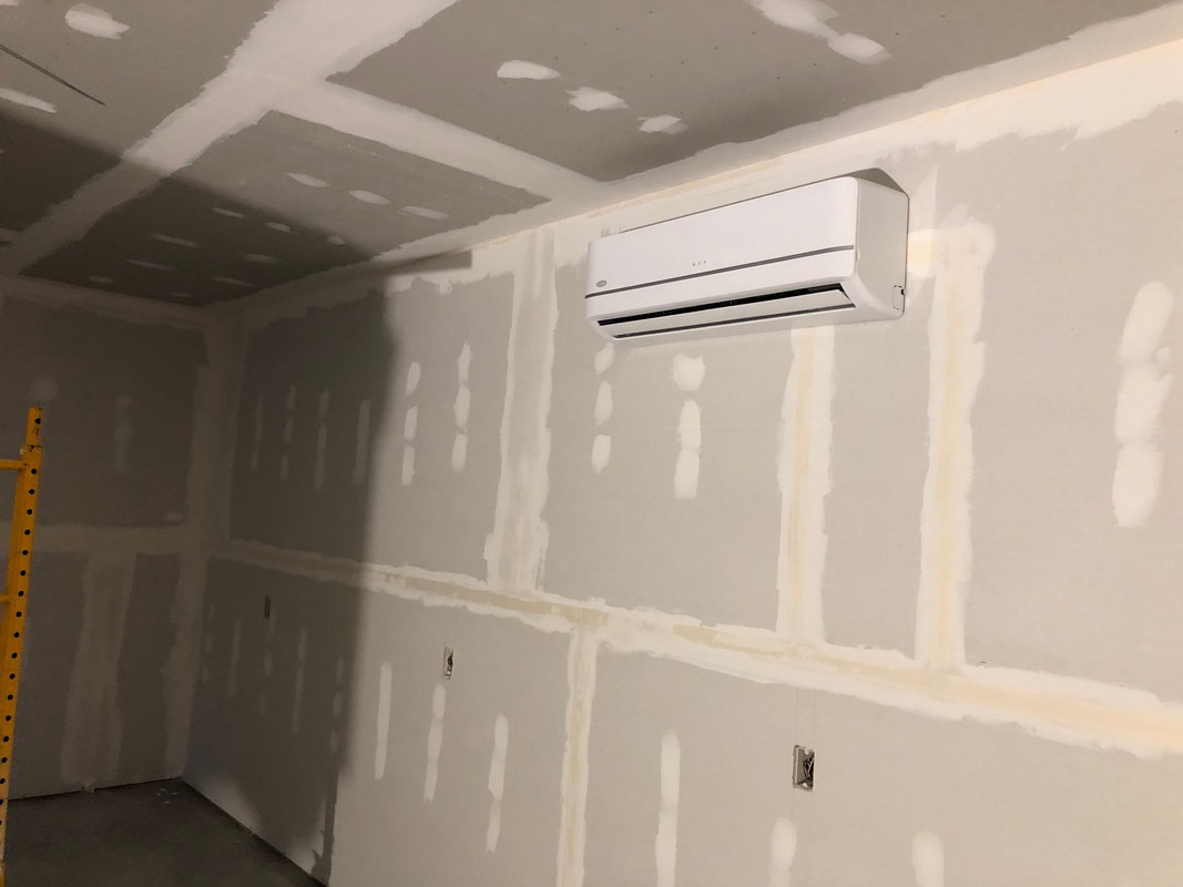

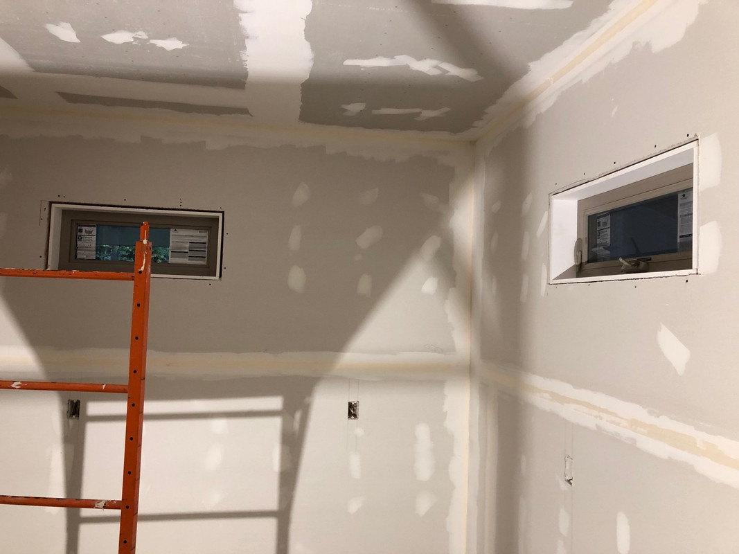

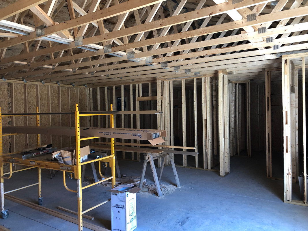

Some more pics to catch up to where we are.
The siding is Celect by Royal and interlocks together.
Still waiting on the door so they can finish siding the front then put the trim on. Drywall should be finished today.

Wet and cool today so they're using a portable heater. Rain is supposed to be over for a few days.

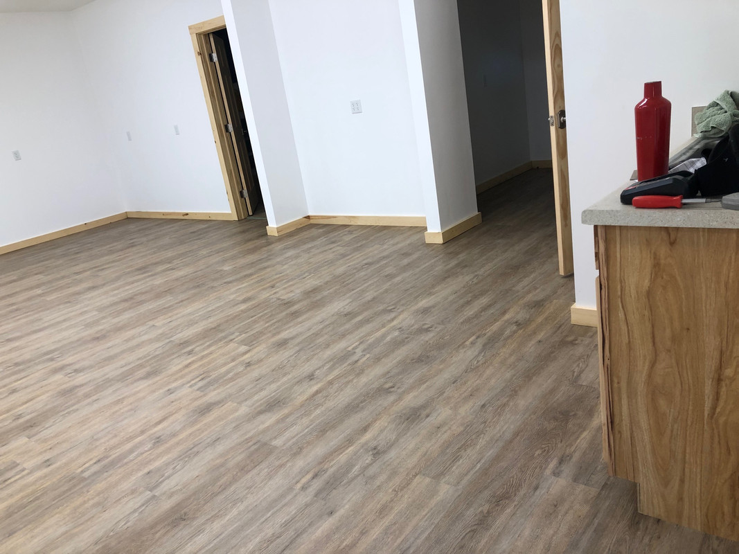

Finished and very pleased, final pics.
