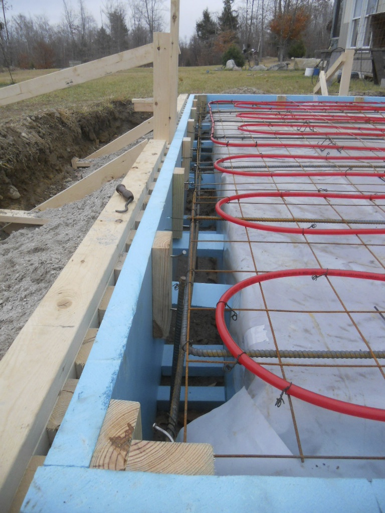

Here's a detail of basically what I have in mind as far as insulating the slab. The only differences was to have one course of concrete block exposed above the slab with the stud wall setting on it. Then attach 1" foam board to the row of block and studs on the inside from the slab up, before drywall, to add a thermal break and function as a vapor barrier.
But the more I think of it the way this is insulated It makes sense to just make sure the floor level is minimum 8" above outside grade and start the stud wall right on the slab. I would still like to use foam board on the inside.
If you are pouring the floor, compact the dirt then put plastic down as an vapor barrier.
Thanks I plan to use 4" of gravel covered with rigid foam, then plastic before pouring, Bob.
