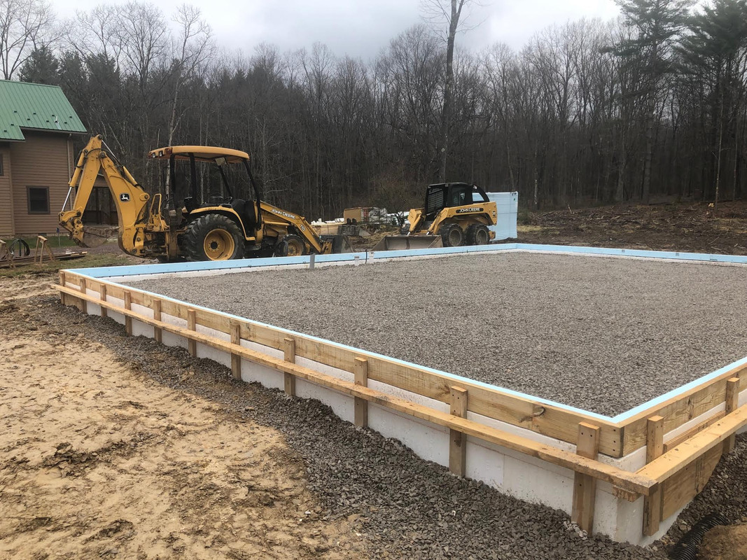

Re: Planning To Build a Shop/Garage, Insulation Question. Update
Her's the progress to date, pouring concrete Monday. Decided on ICFs for stem walls. I'm thinking the plastic should go down on the stone first with foam on top, correct?
   / Planning To Build a Shop/Garage, Insulation Question #28
If you tape all the seams of the foam boards, technically you don't really even need plastic. But I put my plastic on top of my foam because it was easier to adjust for perfect grade/level going one board at a time (I did not tape the boards). It doesn't really matter. Just need to keep most of the ground water from ever having a chance to come upwards.
#29
At this point I don't know what could be done to keep any potential water/moisture from getting up to the slab other than the plastic? We have drain pipe on the outside of the footer and lots of gravel there. Also 5-6" of compacted gravel for the slab to go on. Thinking if any water/moisture did get up through that it'd be better to stop it before it reached the foam.
And since the original topic pertained to insulation in addition to 2" foam board under and around the slab I decided to go with 6" walls then foaming them and the ceiling.
   / Planning To Build a Shop/Garage, Insulation Question #30
Thats exactly what the plastic is for, under the slab: keep the concrete isolated from ground moisture. XPS foam wont care about being damp all the time, though. I guess if I had the choice again, I'd put plastic underneath the foam too. But I was hand excavating the compacted sand under my slab to get each foam board to sit at the perfect grade for an economical slab (4-5" thick) with a pitch towards a center drain. If you plan a dead flat slab, and have a laser level, I'd get that rock perfect, and throw the plastic down first, for sure.
A spray foam ceiling and 2x6 walls full of foam will be a very well insulated building!
