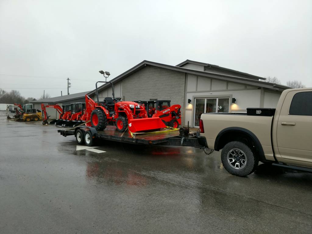

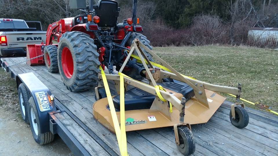

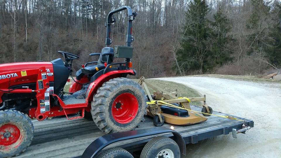

I recently sold a job to a guy who is a PJ Trailer rep. He told me he'd give me wholesale pricing on a trailer, so that seems attractive. Their promo material sounds great (as expected!). Any real world feedback out there?
FWIW, I would be looking for a trailer that could handle my Kubota B3030-Cab with FEL and Woods BH. I'm thinking a tilt-bed (for clearance issues with BH attached) at 7000 Gross would be a good option. Any comments?
I have had my bumper pull PJ 20 ft trailer (14,000 lbs)for about 5 years with no issues.If I were offered wholesale I would jump on the biggest PJ trailer my truck could handle.I wish i would have went 22ft instead of 20ft with my 6ft brush hog and front end loader it gets a little tight.
