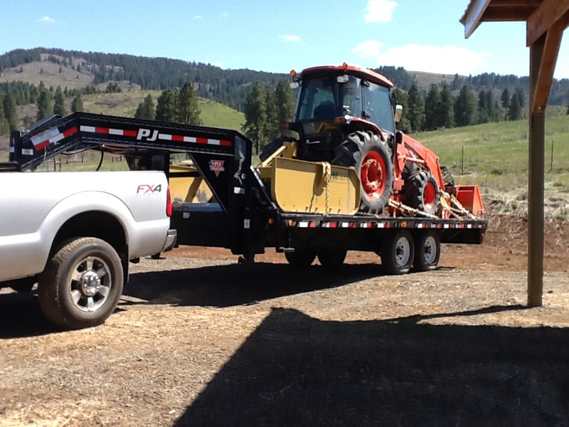

My situation is the exact opposite from Diamond Pilot. I have a PJ 20 deckover GN with slide in ramps. The load angle has never been a problem, but because I am rural and enter undeveloped sites (pastures, etc), the trailer angle of departure is critical. The deck over works well for that issue.
