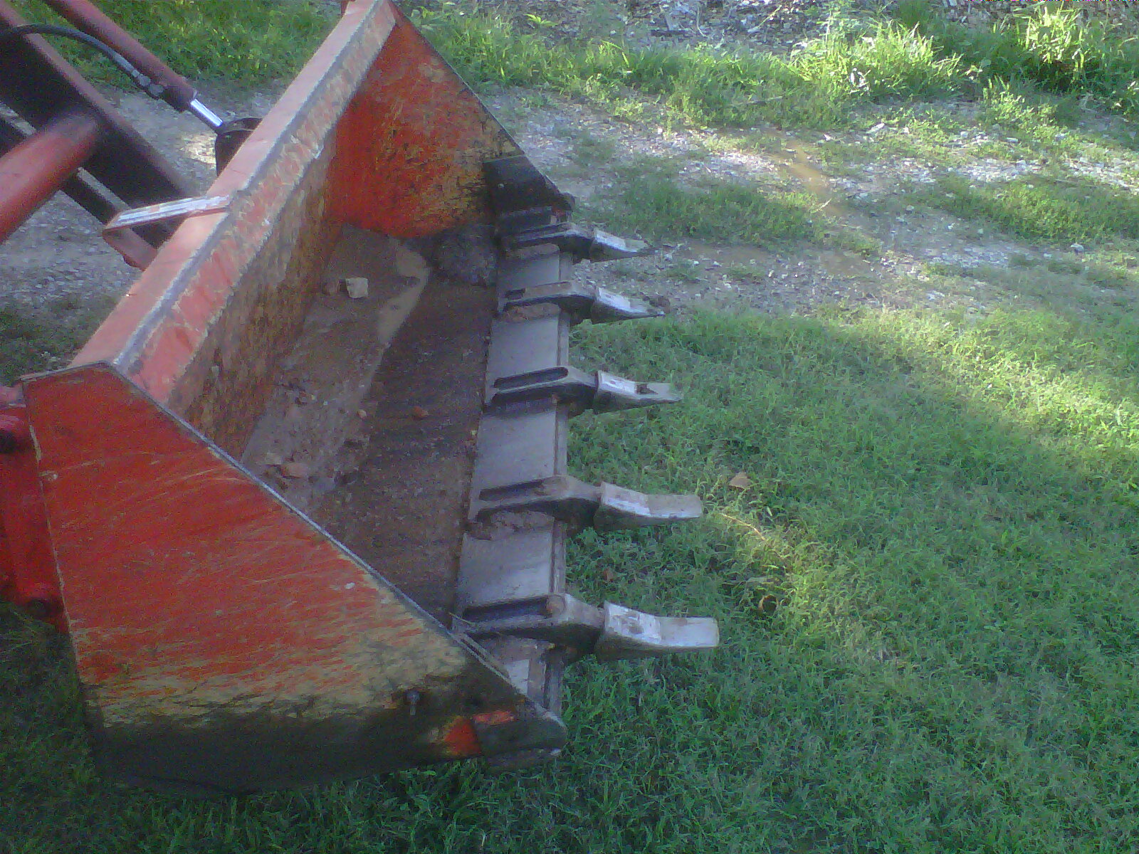

/ Piranha tooth bar!!! #92
All that and no pictures??!
---------- warning this post has nothing to do with the Piranaha tooth bar----------------:confused2:
here is the one built, the length of the teeth helps in almost every situation. The only down side of the length is the weight is now transfered past the cutting edge when picking up heavy items.
