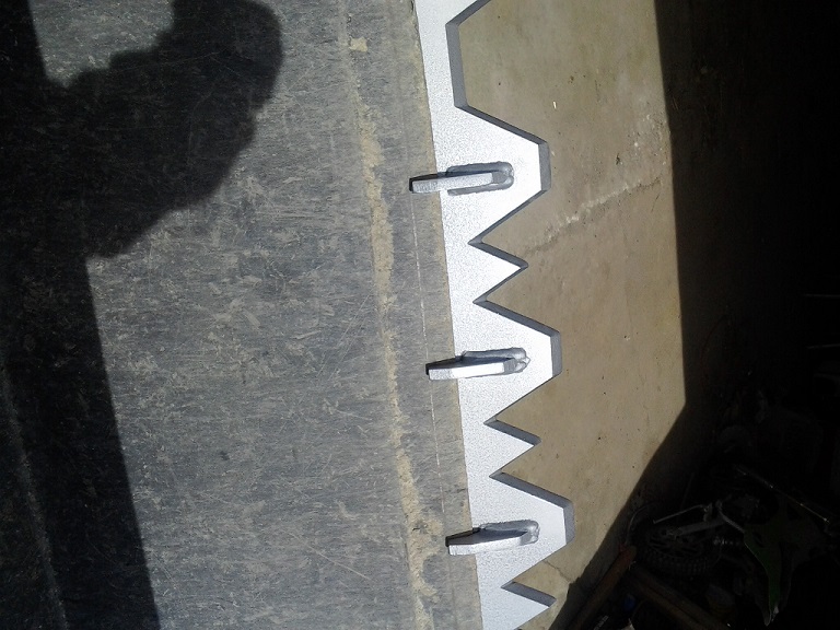

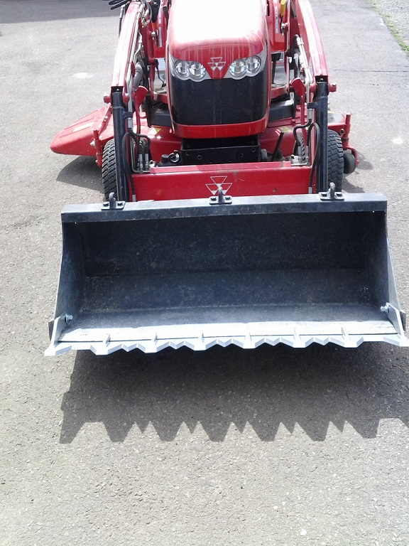

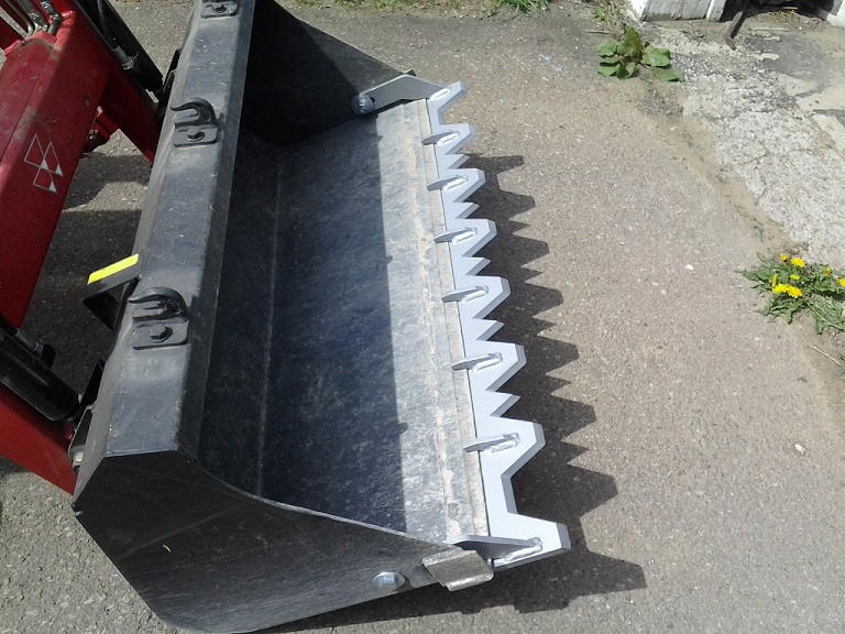

I also purchased the PTB.
I have found(like others on here), that it works great for cutting off brush just below ground level. I've been able to cut some bushes in half(leaving half to continue growing), by using the toothbar to cut through the roots.
Mine came sharp enough to cut through the shipping box, and I received several small cuts on my hands just carrying it to the tractor and installing it.(wear gloves when working with the toothbar)
It works great for spreading gravel from a pile. And after spreading soil, if you backdrag on an angle, it makes nice grooves in the soil to minimize water runoff and hold seed in place(much like the ratchet rake)
It doesn't dig in my hard ground as good as I was hoping for, but it works much better than the flat bucket edge.
I won't include video(not that I have any), but the request was made for BX video only. :)

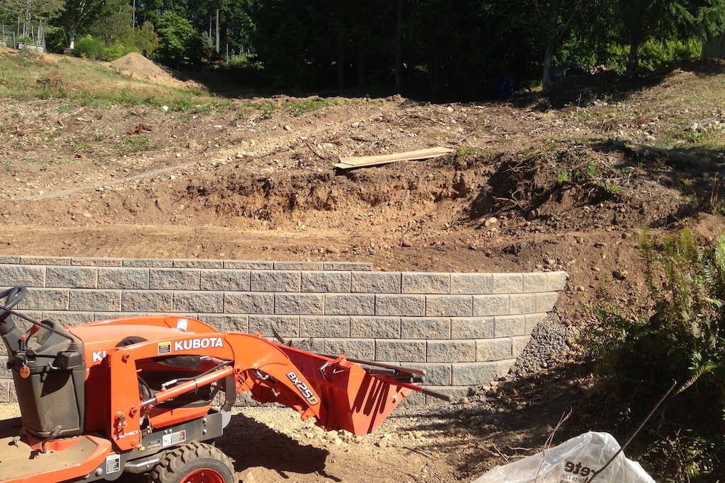

I can't speak for price and I can't speak to your soil but I just finished cutting into my rocky hill more than four feet with the PTB and I know I could have never, and I mean never done it with my FEL without teeth. The bucket was absolutely useless for digging before PTB. Maybe hard to get some perspective in this photo but I cut into the into the 20degree slope, the area behind/above my new retaining wall. If you look close, you can see some 2ft by 8ft plywood forms I was using to hold back gravel/fill on retaining wall. Point is you can see the relative size of the cut. I used the spoils for backfilling behind the wall.

Dude, the perspective is clear, nice digging! Nice wall too! You do nice clean work with that little monster.
Keep up the good work!
Thomas

Thanks for the input. I have the same rocky issue, mine are a bit larger with a greater likelihood of large flat ones. Problem with the straight edge is the bucket will hit a rock about 3-4" in diameter in hard soil, then the bucket will want to walk up towards the surface, lifting the front wheels off the deck. It typically takes a few shots, articulating the bucket to get any bite to dislodge the rock, then naturally, there is another one 3 inches behind that...LOL.
It can get rather interesting on a grade with trees nearby, particularly on uneven ground.
Rock piles with various size rocksare also interesting, as they used an excavator hammer to remove a ledge where I am working, then they piled it. during the pile making, all the large flat rocks slid down the pile with each heaping, so they all typically lay against the bottom third of the pile, in layers, so you could imagine how it must be trying to get any bite with the BX. The pile is over 200 ton, and no I am not moving the whole thing, just need to build access areas in the excavated area and working the new driveway fill.
Nice job on the wall, good tie in's and overlap, looks like someone won't have a hillside to weed wack any longer....
