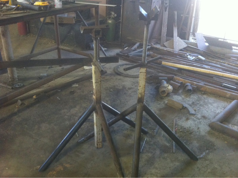

jw3
Member
Oct 29, 2006
26
I was in the shop this evening and had to move them put of the way. Thought y'all might get a kick out of them. I know that this something I could've bought, but none of my lws are open normally we I need them to be. The shaft is 1" allthread , the legs are 1 1/4" sch 40 pipe, and the body is 2"X2" sq tube. So far they have worked well. I might have to buy a store bought one to compare it with one of these days.

Crazy Al I didn't use any bearings. I'm in the plumbing business so I keep all my drop pieces of black iron for projects and such.

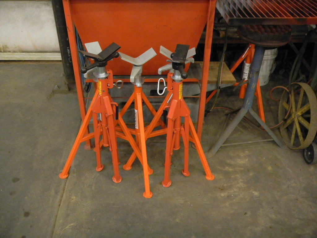

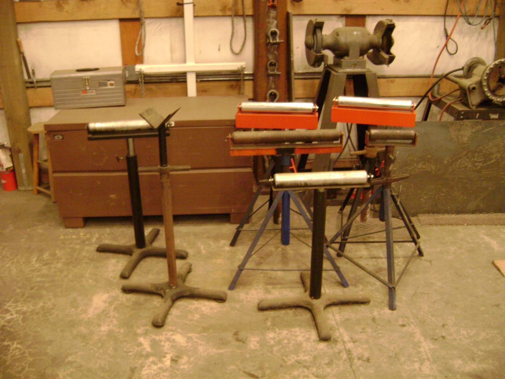

Jack stands are as handy as a pocket on a shirt;). I've made several, and bought a few.

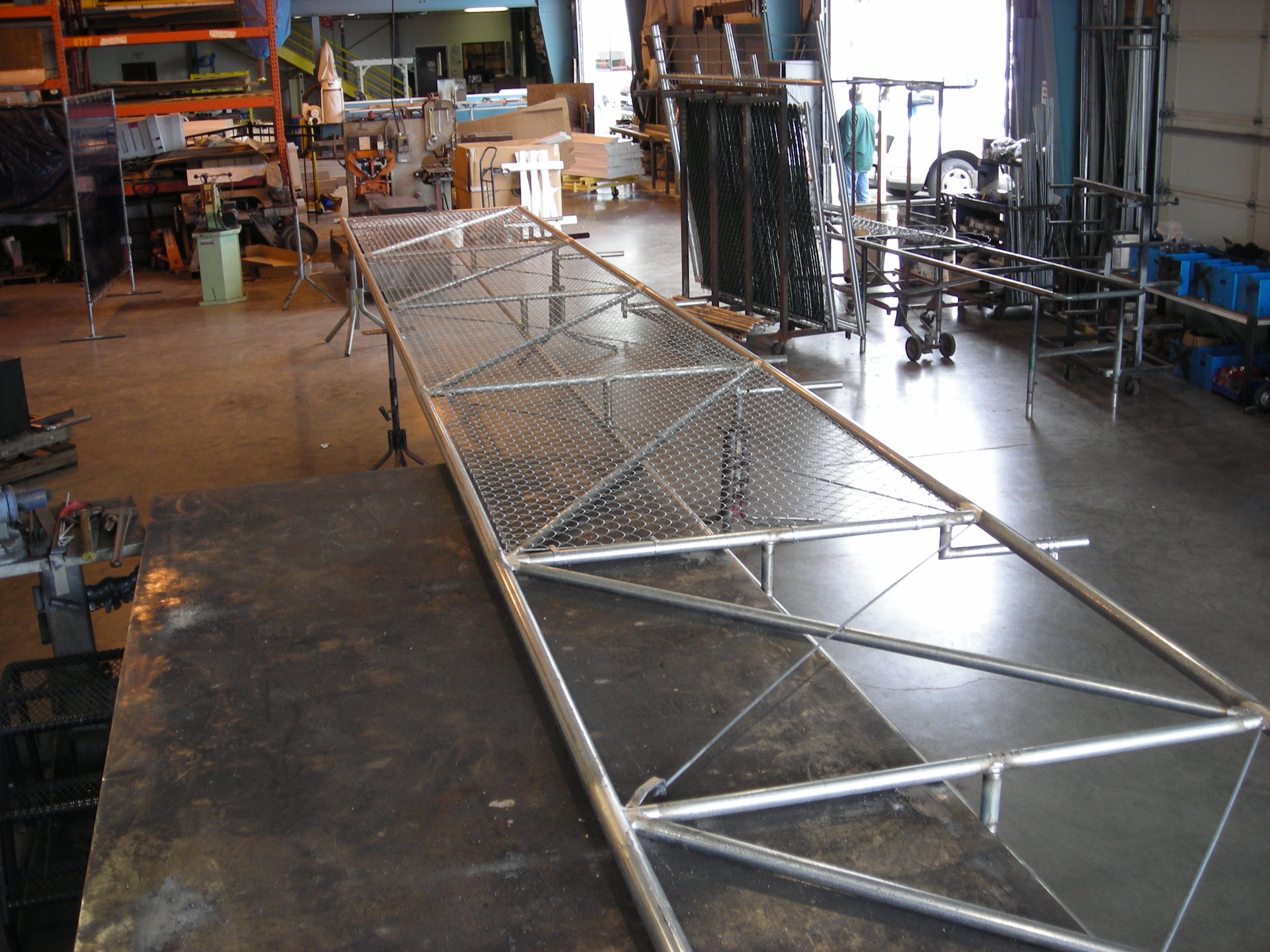

I used to build some really big gates that were a bit longer than my 20' table would handle (up to 54') and adjustable stands worked fine for keeping everything straight and level.

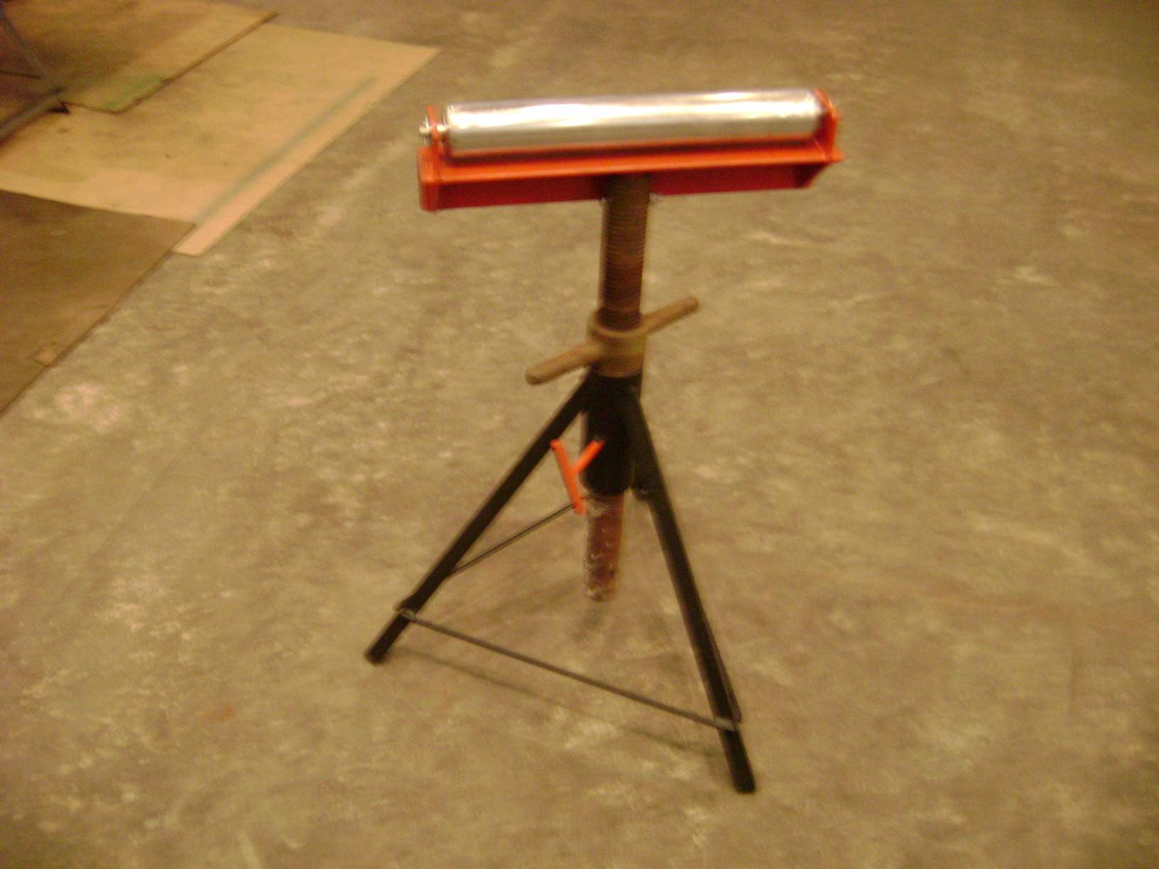

A friend who owns a sprinkler business made some using steel wheels from a car as the base and two pieces of pipe, one slid inside the other with a nut welded to the outside of the outer one and a bolt to tighten it up.
