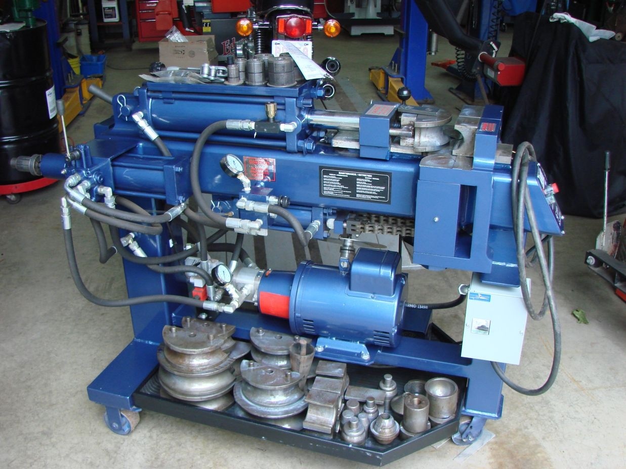

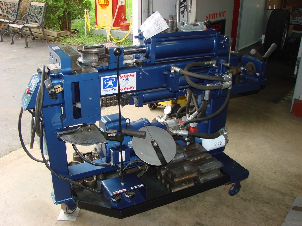

I've made many tools in my day including tubing notchers, hydraulic press's and press brakes but found when it came to benders it was cheaper to by one rather than build it. I have at least six different types of benders ranging in price's from $99. To $10.000. Those 16 ton Chinise benders are actually really good. I've made heavy roll bars with them and they make great bends. Yes they are slower than the more expensive ones but they can still get the job done.
Here's the cheapie one that I've owned for years and the most expensive one I own is pictured. I still use the Chinise one on mobile jobs. These go on sale at time's with $100. off

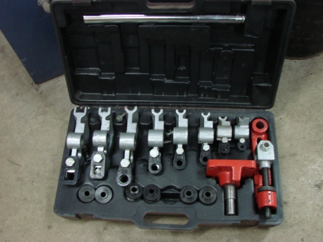

Here's another example of a pipe bender I have here. This one bends from 1/2" -3/4" plus it will bend some square tubing. Less than $300. To buy.

Wow 4 shorts that blue on is nice, but that's out if budget. Although I would like to have it , I think I'm going to order the one from princess's tools, it looked pretty good for my purpose. Thanks everybody.
Thanks. I realize its not what your looking for. It's just to show what can be spent on this sort of thing and even higher than that. That large one is Canadian built. It can bend up to a 3" pipe but so can the princess auto one and the HF one. The 16 ton will last you for years. As I said. I still have mine and use it from time to time. Good luck.

I dont think that 16 ton princess bender is going to do much good on 2in sch40 pipe. I have one and quite frankly, for anything more than muffler pipe or thin wall stuff, its a real pain to use. Only thick stuff I have tried has been 1in boiler tubing and I had to lay the heat to it to get it to bend.
Somethings wrong. I used 2" schedule 40 pipe when I made the pipe rack for the Miller trailer I built and It bent it for fun. Yes it's slow going and your better off making a stand to put the bender on but it's a tough old bender.
