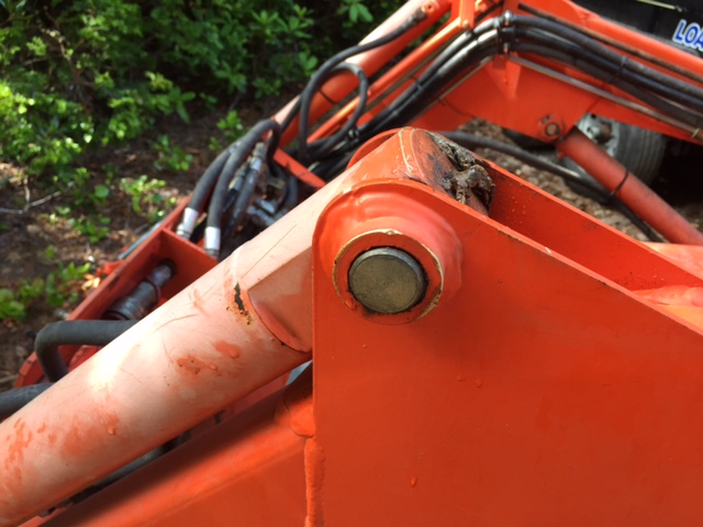

/ Pins and Bushings #10
This is a loader bushing on my B21. They all look pretty much the same. The loader pins are all 1", the backhoe pins are 25mm.

/ Pins and Bushings #11
Those pins do not rotate so they are locked in with a bolt usually. The wear in the view shown must be in the bore on the end of the cylinder. At least they are say to get onto a drill press to bore out and then press in a bushing matching the pin. Have you pulled the pin to check if wear is on the pin or bore?

/ Pins and Bushings #12
Sorry for the confusion. That photo is my B21, not boomologist. I do not have pin or bushing problems. I keep everything greased. I put the picture up because there was some discussion of what a B21 might have for pins/bushings.
