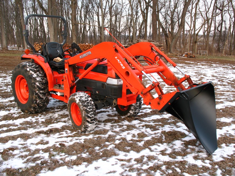

I designed mine. It would rip your roots right out.

I have 16 acres of pines. Largest are maybe 8 inches. The area burned about 20 years ago so most of them are small. The ones less than 4 inches I can just pull out whole with little problem. The larger ones are more than my tractor can handle (LS 3040 about 2 tons with loader and hitch weights and filled tires)
Can't afford a ready made root bucket so I'm thinking of a homemade root cutter.
I'm thinking of a plate of 1/2 inch steel. Maybe 12"-18" wide that will bolt to the bottom of the loader bucket and extend maybe 18" past the lip.
Use a grinder to put a sharp bevel on the edge then use the bucket to push it into the soil a foot or two from the truck/stump (my soil is almost pure sand, only 2 miles from the shore) to cut the roots making it possible to pull the stumps.
Comments? Suggestion?
