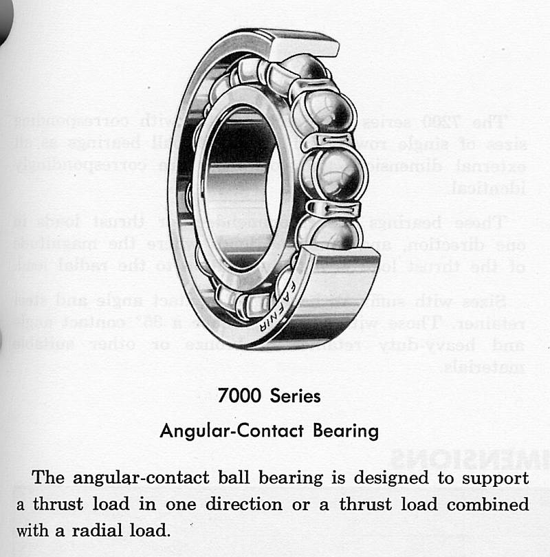

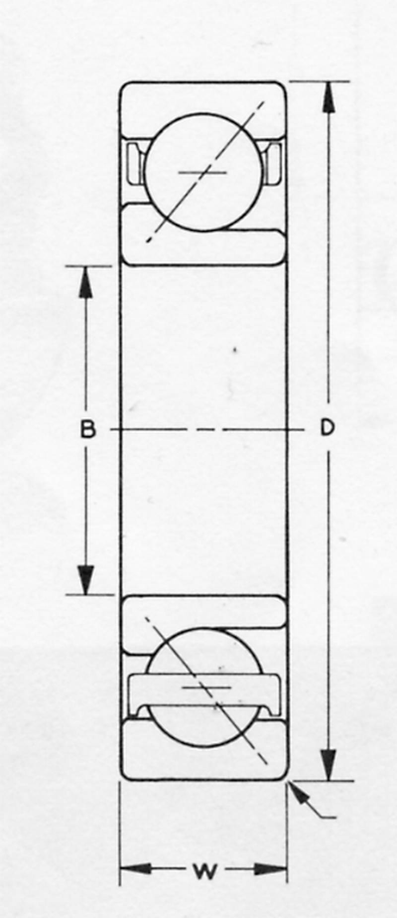

Pillow blocks come in several designs and how much laterial load they can support will depend upon the design and how the shaft is retained on the bearing.
Many pillow block bearing housings take std ball bearings with a spherical OD. Also common is the shaft is locked to the shaft with a rotating collar held in place by a set screw.
For a stump grinder there will be applied side loads so you need a design that can handle larger loads than just the weight.
Bearing capacity will depend upon bearing size and design. Some BB's are designed to handle higher side loads and the typ BB (see pics). I'm also thinking it is going to take better support than a twist lock collar with a set screw to handle the side loads.

/ Pillowblock Bearing question #7
They won't last very long. There will be a lot of shock loading.
You need angular roller brgs as in the disk brake rotors in a car.
