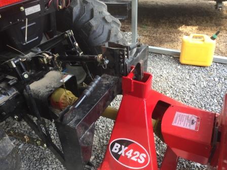

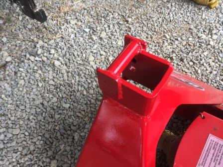

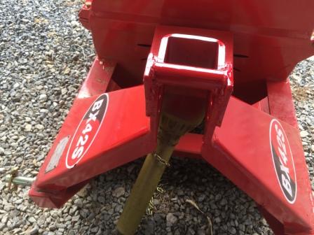

I did get my set up done for making the chipper QH compatible. it was soooo close, if I set it up on blocks, I could get it under there. but the top hook would only utilize one bolt, with it as low as it could go, and the pin in the chipper in the top hole. I fixed that today, and since I was making it fit, I figured I might as well make it so I don't have to change the top hook, it's now set up to use the same configuration as everything else.
I took a piece of 3/4" black pipe, notched it to fit and welded it in place. Then I took some flat stock, and welded over the edge on each side, to give it even more 'hold', as I'm not a welder who would do anything for anyone else, :cool: then painted it with some paint I had that was really really close. I plan to paint it to match the tractor, as well as a couple of other 'older' implements I have. I'll buy a quart of paint and get out the gravity feed sprayer one day.
ok, here's a few pics.

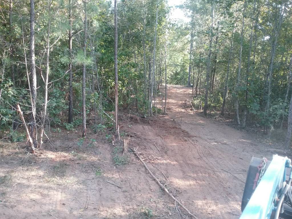

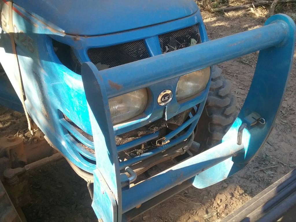

New battle scar 293 hrs on meter. Was doing some more clearing20180921_172824.jpeg20180921_172418.jpeg20180921_172353.jpeg

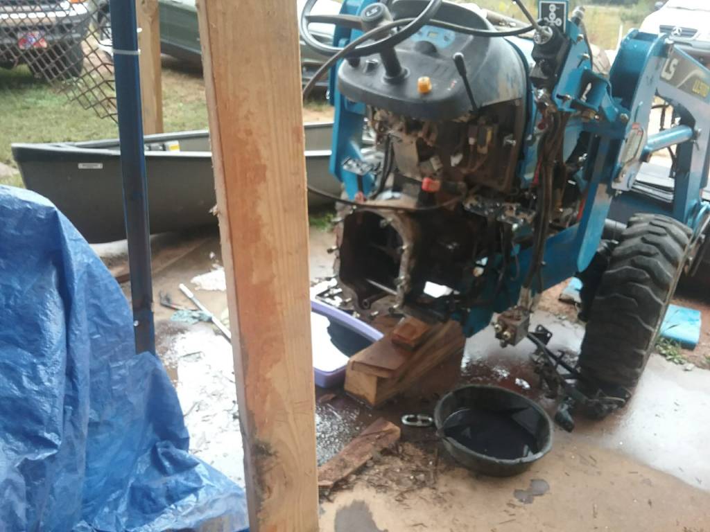

Should be back together Saturday. The detent spring on forward/ reverse was weak letting it jumping out of forward trashed some gears20181020_142435.jpeg

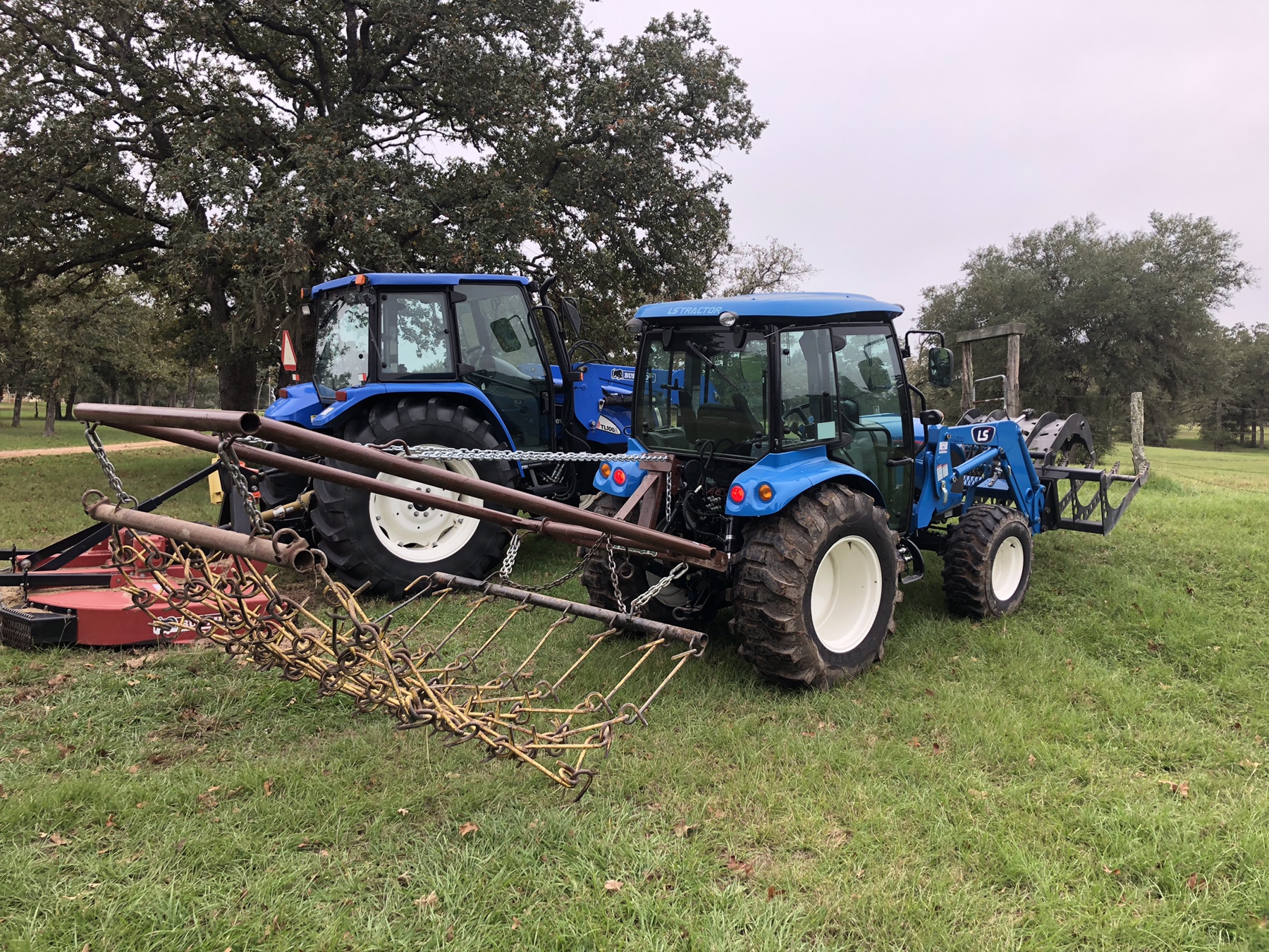

Knocked down old gopher mounds in pastures today.

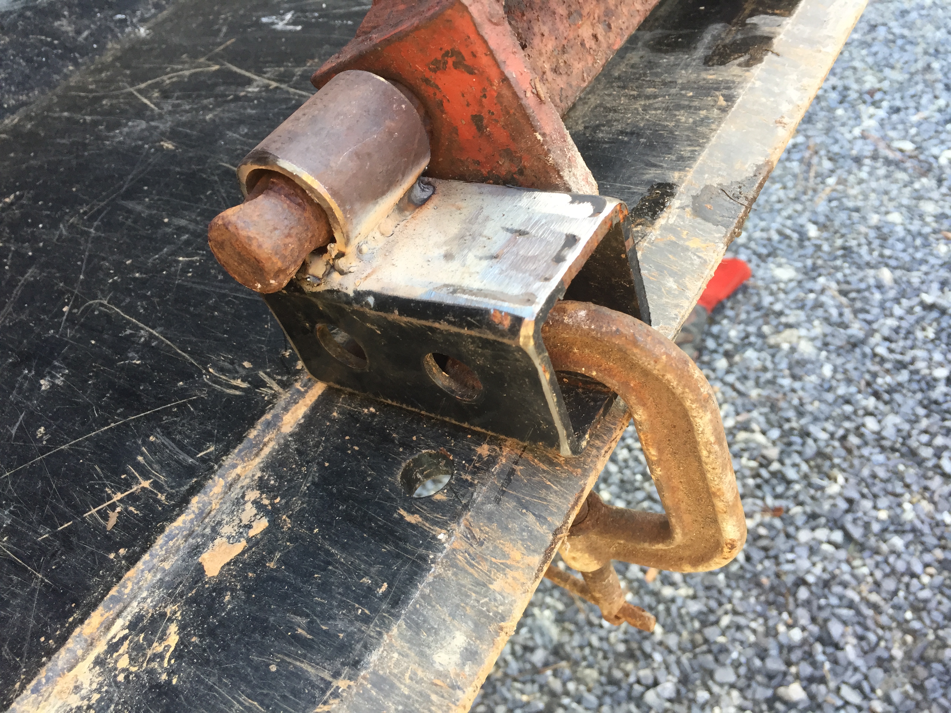

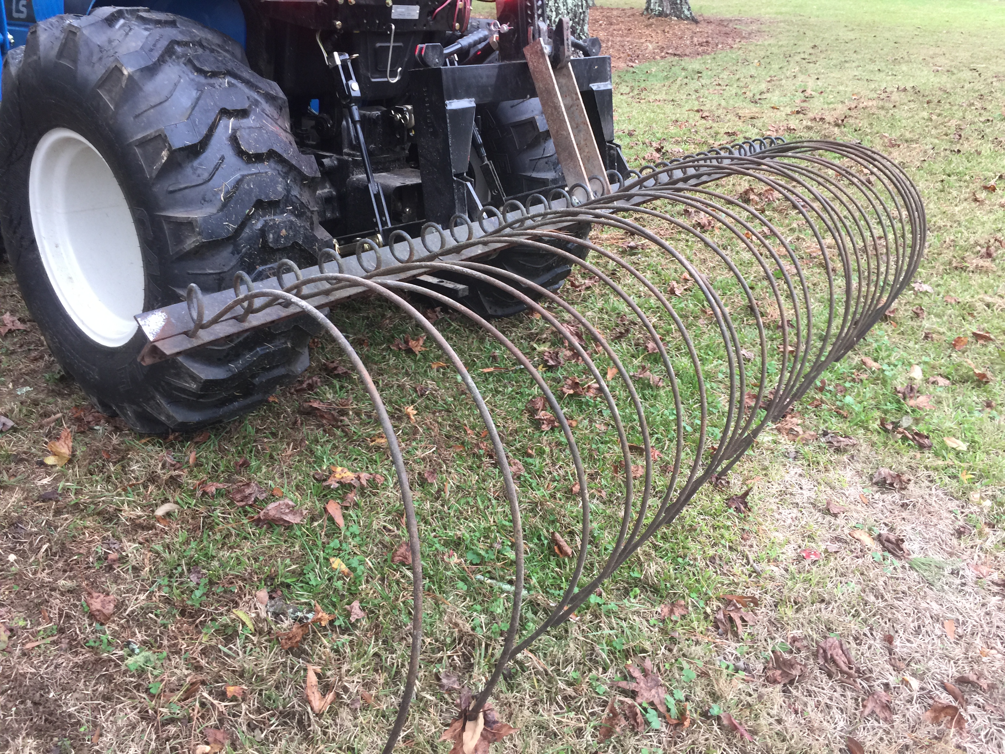

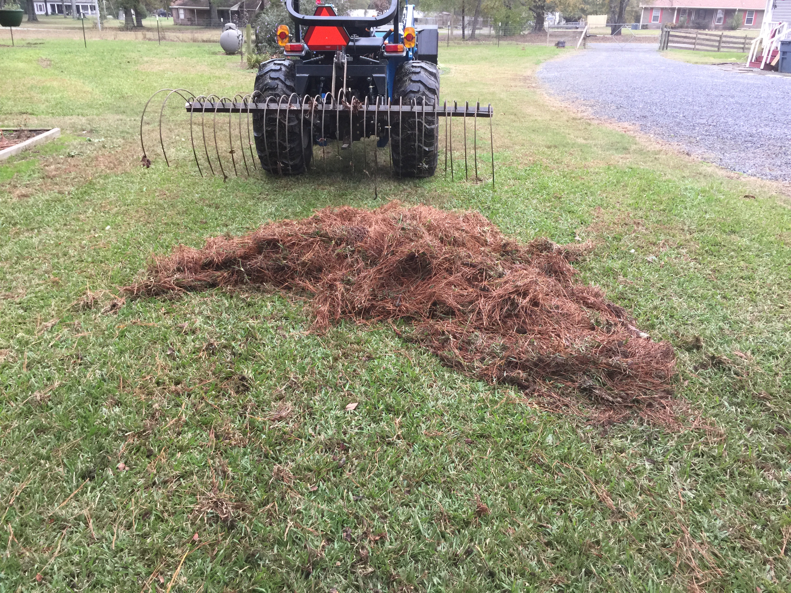

I remanufactured the 3 pt hook up on an old hay rake to work with my quick hitch. This thing is good for dry leaves and great for pine straw....

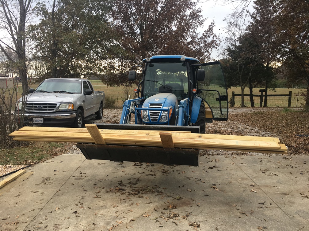

Moved some lumber left over from our deck project out to the barn yesterday.
Put the rear blade back on as well, as we're expecting some snow today.

I 'remanufactured' an old hay rake to work with the 3 pt hitch. makes an excellent rake for leaves, but ESPECIALLY for pine straw! IMG_9068.JPG
