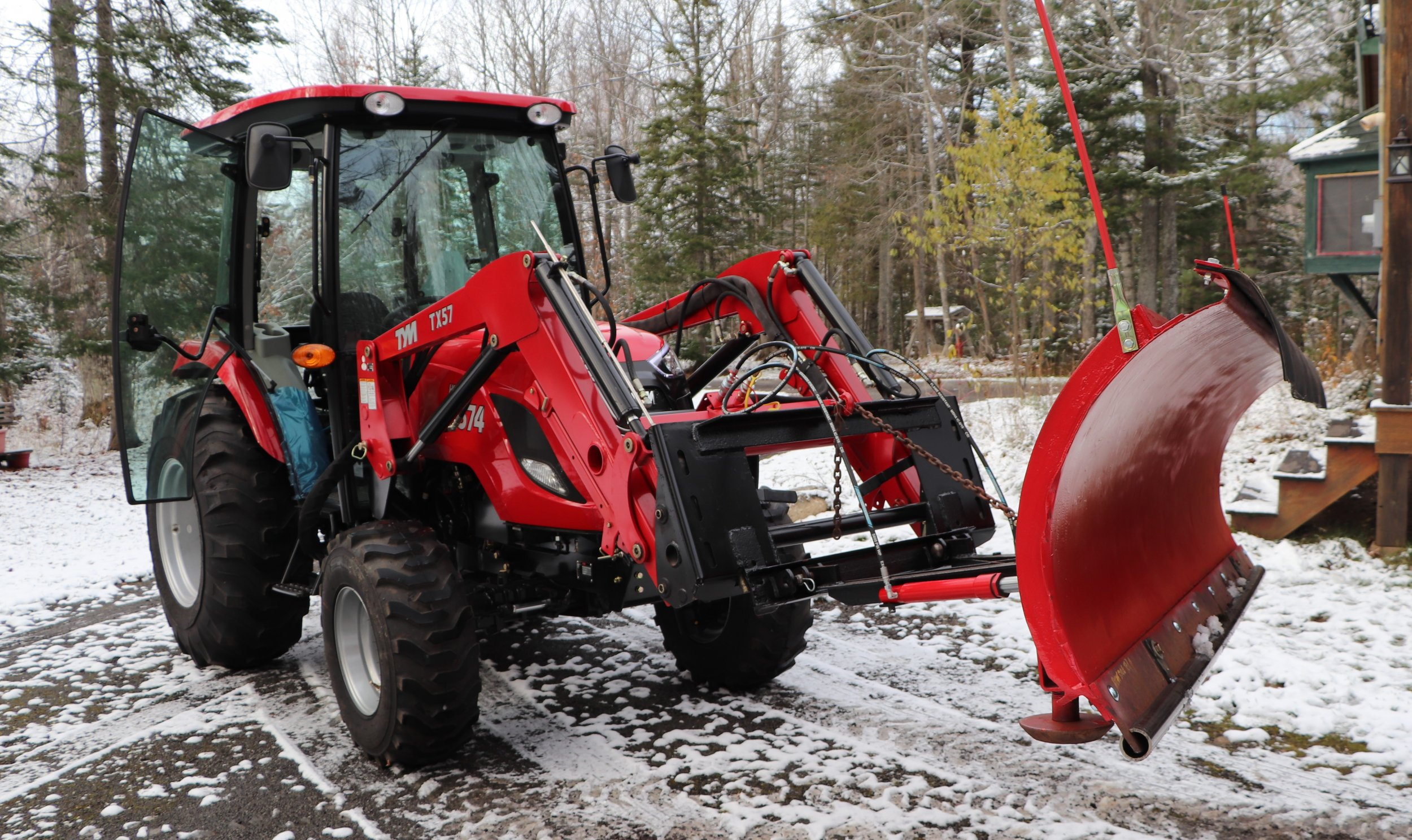

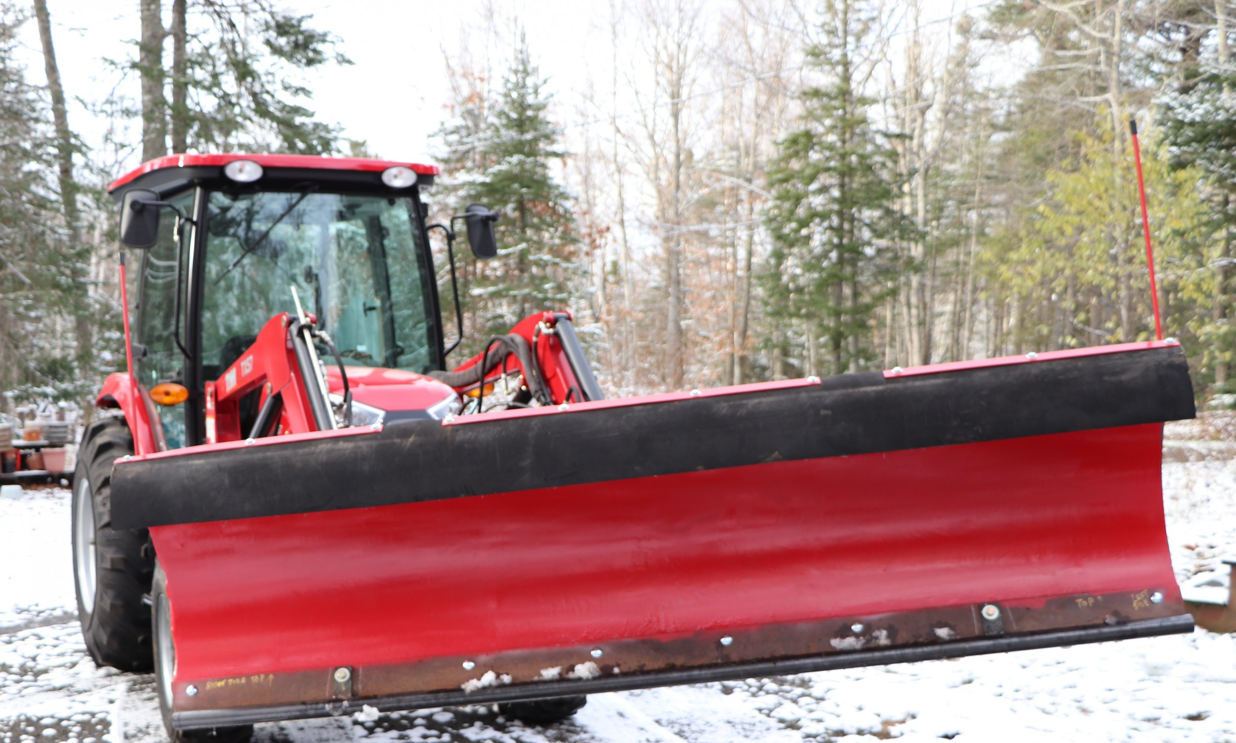

Finished my snowplow build today.
   / Pictures of your snow weapons #6,282
That's almost too pretty to use.
   / Pictures of your snow weapons #6,283
The split pipe on the cutting edge is a great addition. Best thing I did to my plow.
   / Pictures of your snow weapons #6,284
That's pretty much the same as mine, except mine isn't nearly as pretty. There is one thing I'd recommend, add some sort of bar to the mount plate to be able to apply downforce on the A-frame when you need to, but let it float from the chain when you don't. Sometimes the plow isn't heavy enough to cut through the snow and just rides on top.
   / Pictures of your snow weapons #6,285
Looks like old man winter in for BIG surprise. (y)
   / Pictures of your snow weapons #6,286
Yes it is, I have one on my loader bucket just for clearing snow and it is a life saver, especially for the first few snowfalls before a good base is established. Easily one of the best mods I have done to my tractor

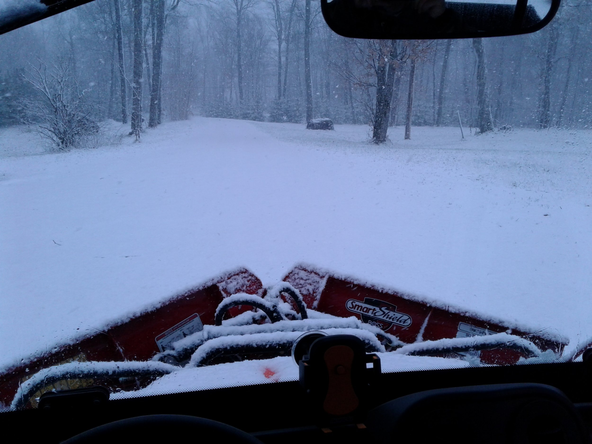

Patiently waiting. Not enough to plow. Had the RTV out to haul some firewood and got a blast of snow but not enough yet to worry about.
