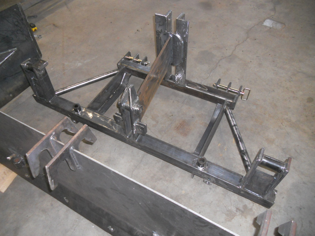

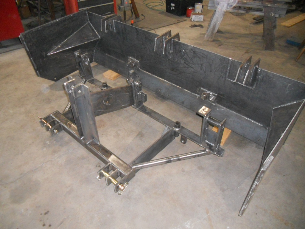

Tatch all carrier? Did I inadvertently copy something that exists?:laughing:
I'll post a picture of the linkage when I'm back on the computer.
Airbiscuit wrote something and the word 'Attachment' in his comment was darkened. Click on it and it brought me to a website with an attachment that looks very much like what you created. I thought that part of your setup was store-bought
   / Pictures of your snow weapons #5,702
The Tach-all carrier is supposed to lock in via a lower pin. I don't see an attachment point on you Box. Do you just grab under the upper hooks and let the box pivot on that?

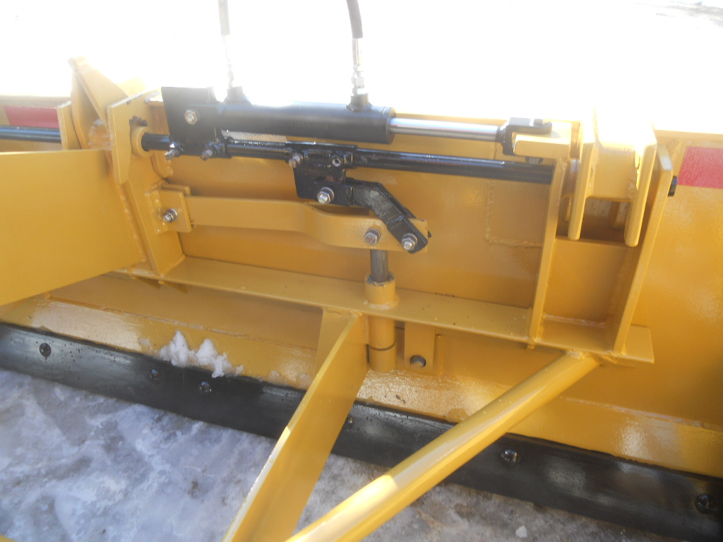

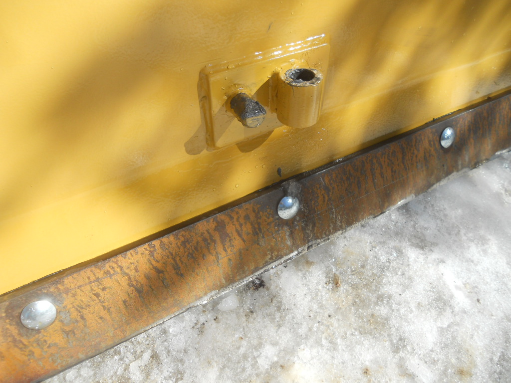

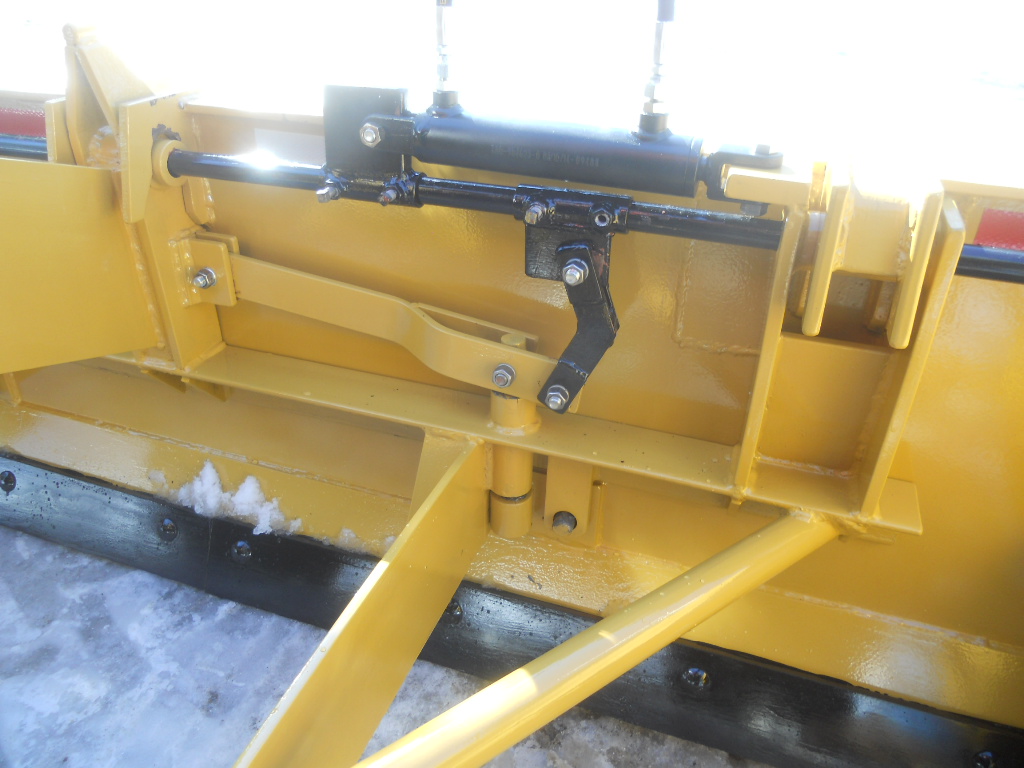

As promised Tony.
These are without the tractor in the way but not being painted does not help the view much.
DSCN9358.jpg DSCN9363.jpg DSCN9398.jpg the other side is the same.
Open & closed or locked and unlocked
I didn't want the cylinder oriented vertically, thought it would be prone to damage and just look goofy sticking up in the air. It was a head scratcher (for me) to have a vertical "pinning" action as a result of a horizontal motion.
I can switch side without leaving the seat.

It works for my purpose, but it's got it's shortfalls. I could see bending of distorting the lower pins if I jammed something hard while pulling (forward). Pushing (reverse) it's fine because it's up against the framework or the tractor side of stuff. In a dirt situation the pin "receiver" could fill with dirt. I tend to use what I have on hand if I can make it work reasonably. Simulating the "euro" design that most of the world uses on buckets, forks, etc. would be much better.

Ahh, I see the vertical attachment now.
A nice couple of pivots to get you from horizontal piston to vertical pinning. Your original pics had the attaching mechanism looking very must like the accidental Link. Really nice gussets on the inner angles. I used to have access to big steel. Now I struggle to find bed frames for my tinkering. Trying to make dollies for my V plow and FEL bucket. At about 1000lbs each, I need 'real' metal. Thanks for the clarification. Nice job
