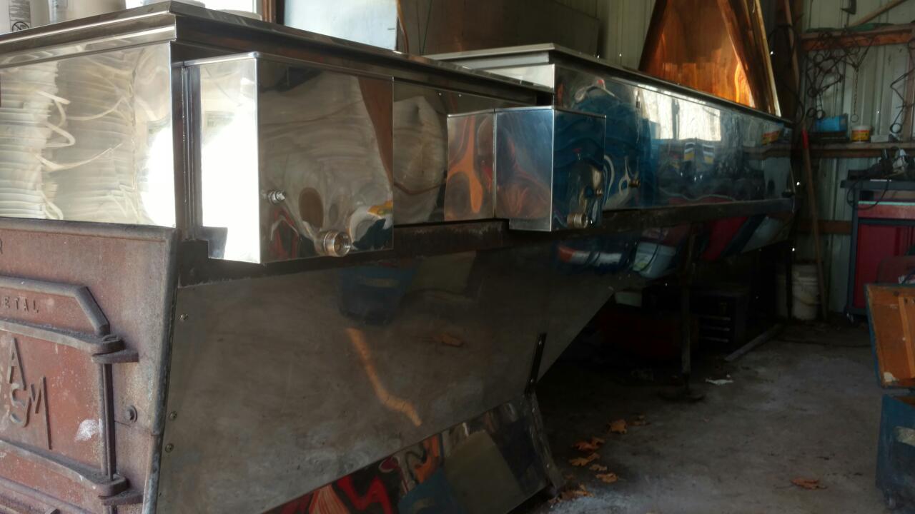

Before deciding to pursue this idea, I was not hopeful for the future of our maple syrup program. Now, I can't wait for next year! In addition to the new collection system, we decided to buy a bigger evaporator. We should be making quite a bit more syrup, and we'll have a 15 month old next season. I can't afford to be cooking syrup for 12-16 hours a day, so we're upgrading from our 2x10 evaporator that does 70 gallons of evaporation per hour to a 4x14 that'll do 200!!
I'll have to take some better pictures of the new rig, but here's a teaser. rps20160328_053550_101.jpgrps20160328_053648_820.jpg
