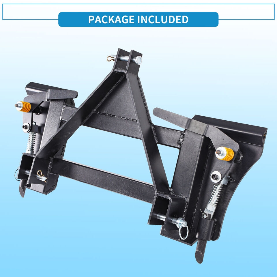

Actually the easiest way would be a 3point to ssqa adapter, then it can be used for forks or anything else. Otherwise, these are the deluxe way to go;
WIFO Farm Equipment | Forks - Forklifts
or these,
https://www.palletforks.com/tractor...t-i-and-ii-tractors/3PTFRLDRECWSHR-FORKS.html
3 point to ssqa;
3 Pt Skid Steer Quick Tach Conversion Adapter for Cat 1 Tractors Heavy Steel US | eBay

Interesting concept, Looking at the 3 point pins and the ssqa slots I have to wonder how easy it will be to use the ssqa part of if the 3 point pins would have to be removed to connect using the ssqa.

Good call out. I'm going to call or email them and will ask that question. I could kill two birds with one stone with this set up as I wanted a set of forks for the front anyways

Shout out to Good Works, sent them an email using their online question form, got a reply within 10 minutes from the President. Pretty impressive.
The pins are not used when the forks are used on the front end loader, only when they are used on the 3 point hitch

It does look like an interesting concept. It appears as though the conversion is quick and easy, with pins and hairclip pins.
