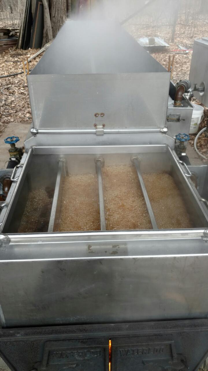

Since all of us TBN members don't live in syrup country, I thought I'd share some pictures of my syrup operation. My dad's been cooking syrup on our property since the mid-seventies. I grew up doing it and in 2012 updated our equipment and increased our tap count by about 50%. Prior to this, we cooked on 3 flat bottom stainless pans with a total area of 30" x 10'. This setup boiled off about 25 gallons of sap per hour and used a full cord of wood to make 10 gallons of syrup.
Maple syrup production is basically a two step process, collecting sap, and removing most of the the water from it. From the tree, the sap is between 2-4% sugar. In the bottle, syrup is 67% sugar. Removing the water is a very energy intensive process. In the late 1800s pans were developed with flues in the bottom to increase surface area. For example, our new evaporator has a 2'x8' flue pan, but rather than 16 square feet exposed to the flame it has close to 100 square feet due to the incorporation of flues. Our new (used) evaporator is 2'x10', boils off approximately 70 gallons of sap per hour, and makes about 25 gallons of syrup per cord of soft wood. As you can see, the increase in efficiency is substantial.
Here's the new setup: rps20160309_110610_271.jpg

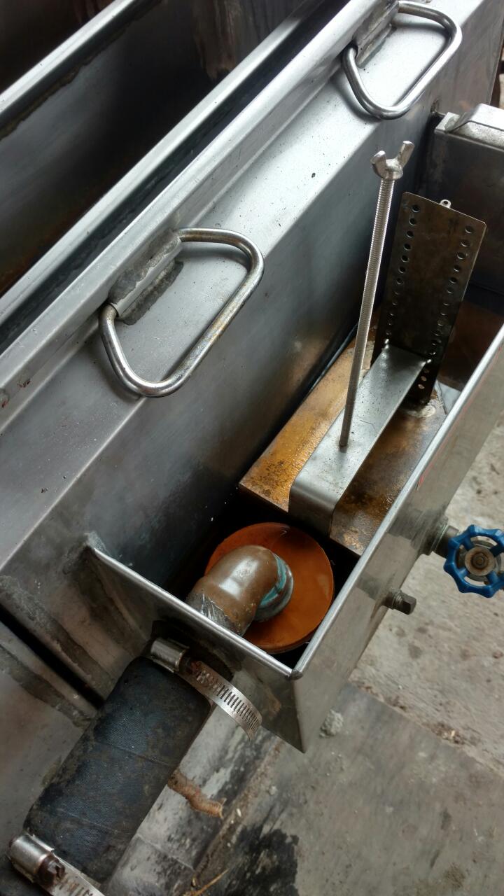

The syrup enters the flue pan from a "head tank" which is elevated to provide positive sap flow. The level in the pan is regulated by a float box. You can see the head tank in the first picture. Since we are in Wisconsin, there is a good supply of old bulk tanks available. We pay about $1-1.25 per gallon for stainless bulk tanks. The head tank is 400 gallons, and the other tank in the picture is 250 gallons.
Here you can see the flues in the bottom of the pan.
As the syrup in the front pan, which has a flat bottom, evaporates, it is replaced with sap, called "sweet" now, from the flue pan. This is regulated by another float box on this evaporator.rps20160309_111206.jpg

Yes, it's a continuous flow type system. Sap enters from the head tank, flows into the flue pan, then into the syrup pan. As fresh sap replaces what's being evaporated, the sweetest syrup ends up near the draw off. A large evaporator may actually be constantly drawing off syrup, but in our system, we take off about a gallon and a half every 45 minutes. So that part does consist of batches, but the rest is continuous.
