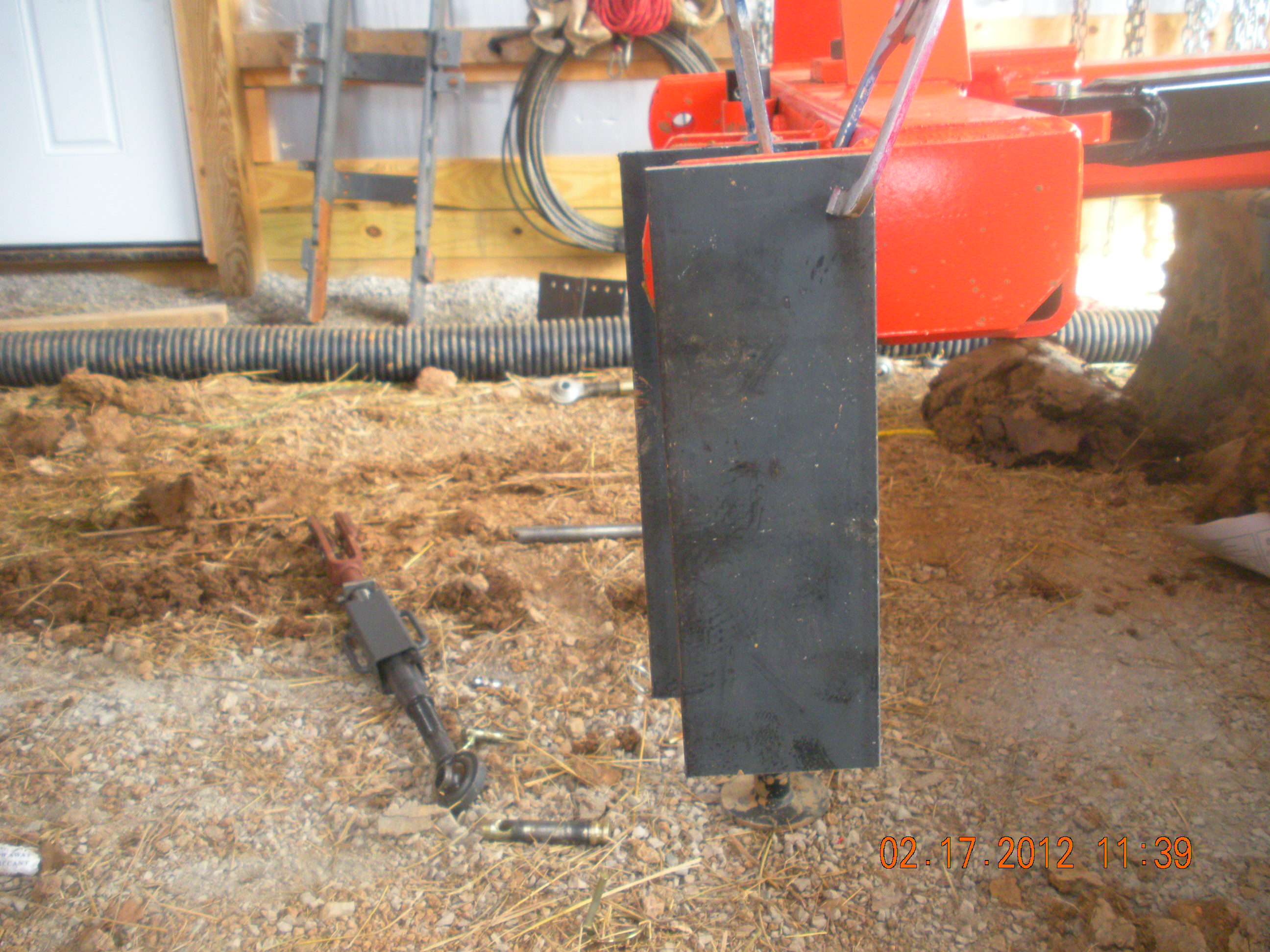

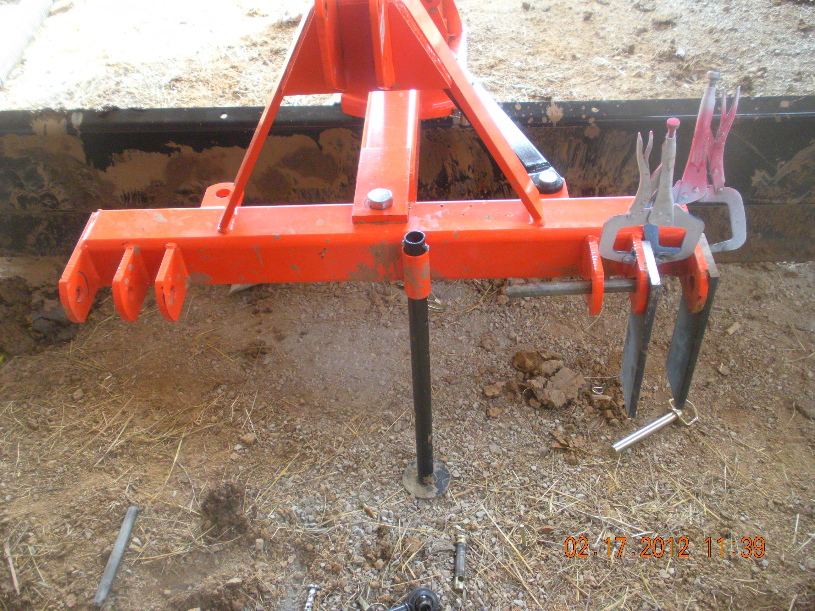

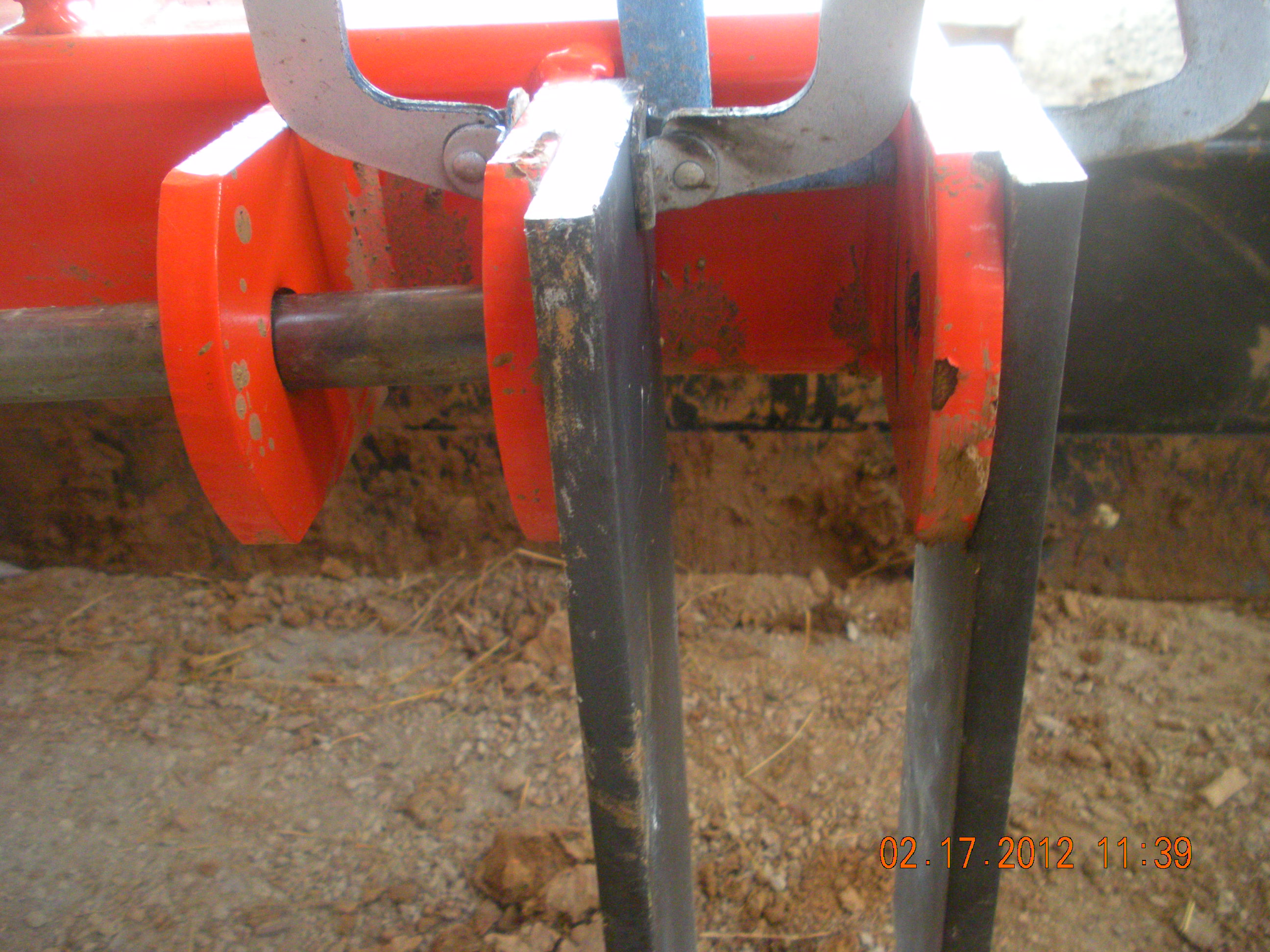

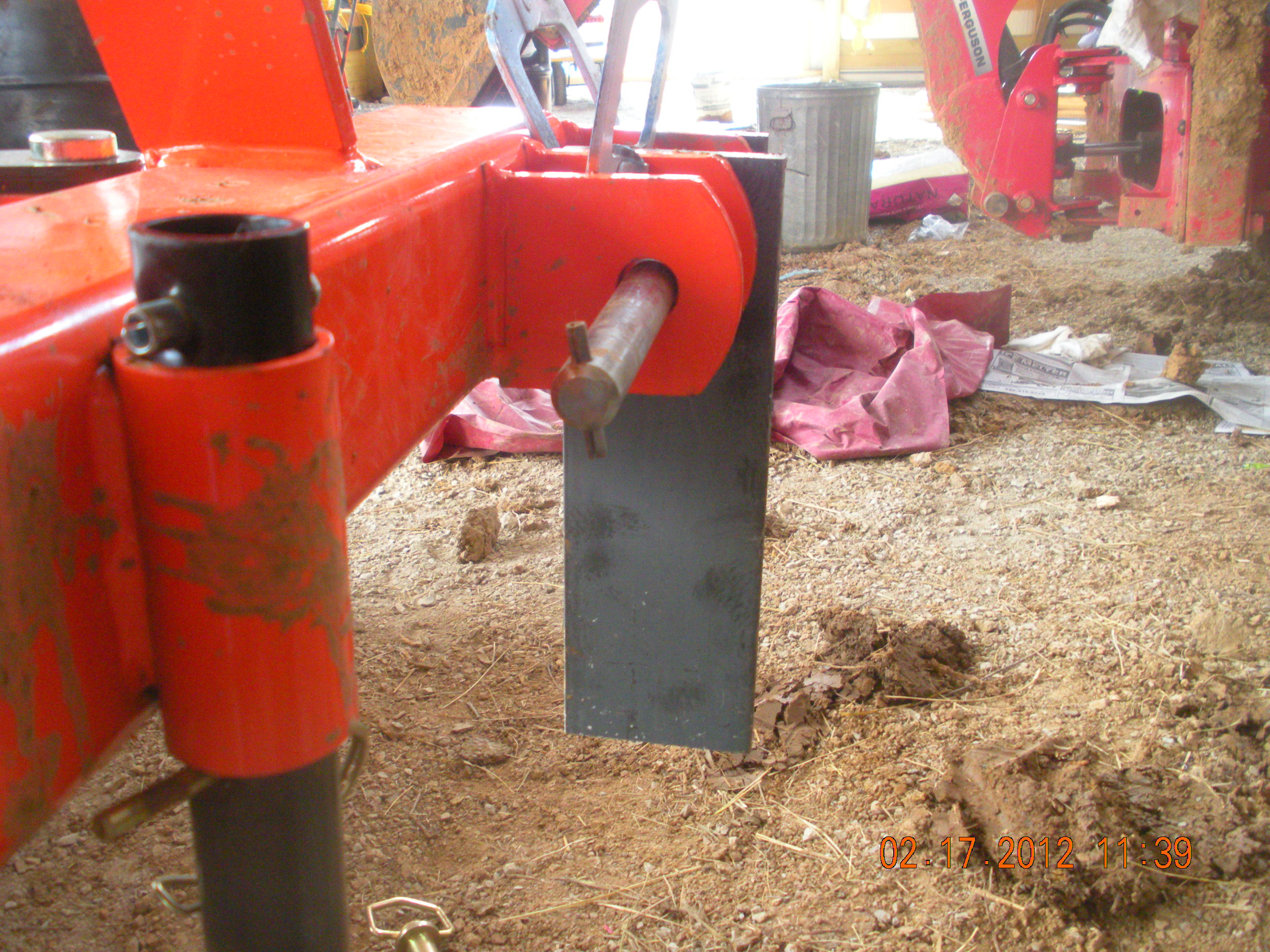

suggestions on how to weld this together, the holes have to be drilled today & then i`m ready to weld.
by drilling holes every 3 or so inches i will be able to lift the blade higher, now for the welding what rod do i use. it`s all i/2 metal. the holes will be 7/8, plates will be on both side of the blade.

Well I am not sure why you need to lift it higher than the lift point designs. If needed the blade to lift more, just shorten the top link and it will raise higher.
Now as for welding those plates. IF you really need to make an extension bracket, I would just buttweld them to the bottom of the existing brackets. Bevel each side from centerline so you have a V to the edge of your extension plate on a 37+or - degree and just leave the top bracket plate a square edge (remove the paint from the bracket before welding. When welding weld one pass on one side then switch to the other side and weld a pass. Clean each pass well with grinder. Try to keep about the same amount of weld on each side. Watch for the metal drawing to one side or other and if it does, weld a pass or two on the opposite side of the draw direction until it is straight again.
The way you have it in your photo, it will be nearly impossible to weld the back side. Welding from the bottom as I suggest, the welding will be all horizontal which is much easier than vertical. When welding horizontal, keep your rod pointed toward the top side with an incline of about 30-45 degrees up and about 20 degrees toward the puddle. I would use 3/32" 7018 rods all the way given your welding skills. Make your first pass then grind from the back side to sound metal and weld the other side. If you put about a 1/16" -1/8" gap between the pieces, it will allow for better penetration.
