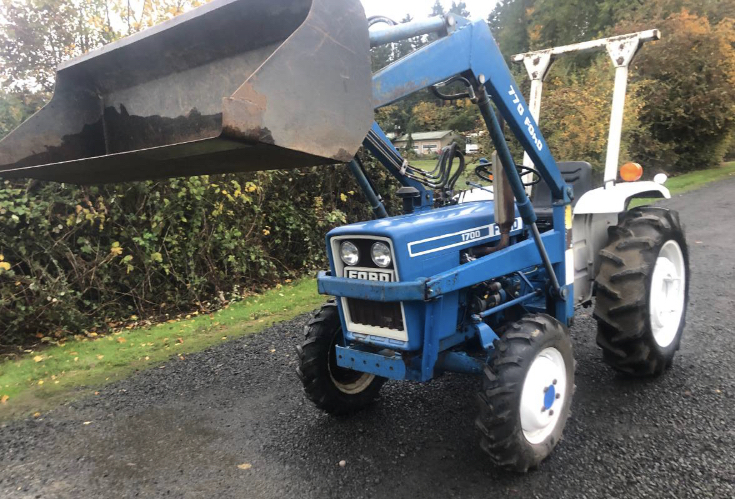

Sitting at my desk, the Ford appears to be in excellent condition for $7,000.
You will need to learn hydraulic repairs long before you need an engine repair.

The ford is 4x4, with fel, about 400 hrs. I will need to learn on how to wrench an old diesel.
Looks nice. If you are the kind of guy who changes his own oil, I'd say jump on it. Those Fords were and still are dandy tractors. Several people on this list own them and I've driven them myself. Older gear drive compact tractors are the financial "sweet spot" for tractors right now.
A good old gear tractor with 400 hrs is unlikely to need any repair. You can expect any used tractor to need attention to maintenance items.

I have come across a
1)Massey gc1715 (sub-compact) almost brand new for 11k, or a
2) older 800 hr L3410 for about 15k or
3)a more beatup L2600f w/o fel for 7k,
4) old Ford 1700 low hrs for $7k.
Didn’t know if i should look for specific weight/hp class? Is it better to have a newer model with less hp or an older one with more hp/more weight?
For almost all tractor tasks, except mowing lawns, wore weight and a wider stance are beneficial.
/ Picking a first tractor #36
i can see the correlation between weight and stability, strikes a fine balance between able to work safely and efficiently, vs small and nimble enough to get in and around between obstacles…
Tractors are inherently unstable operating on sloped ground. Tractor rear wheel/tire spread is a critical factor increasing compact tractor stability working sloped or uneven ground. Rear axle is the tractor component on which rear wheels/tires mount. A 4" to 6" wider rear axle substantially decreases tractor rollover potential. Tractor width is an approximation of rear axle width.
The Ford 1700 (unusually) has an adjustable rear wheel/tire spread from 43" to 58".
