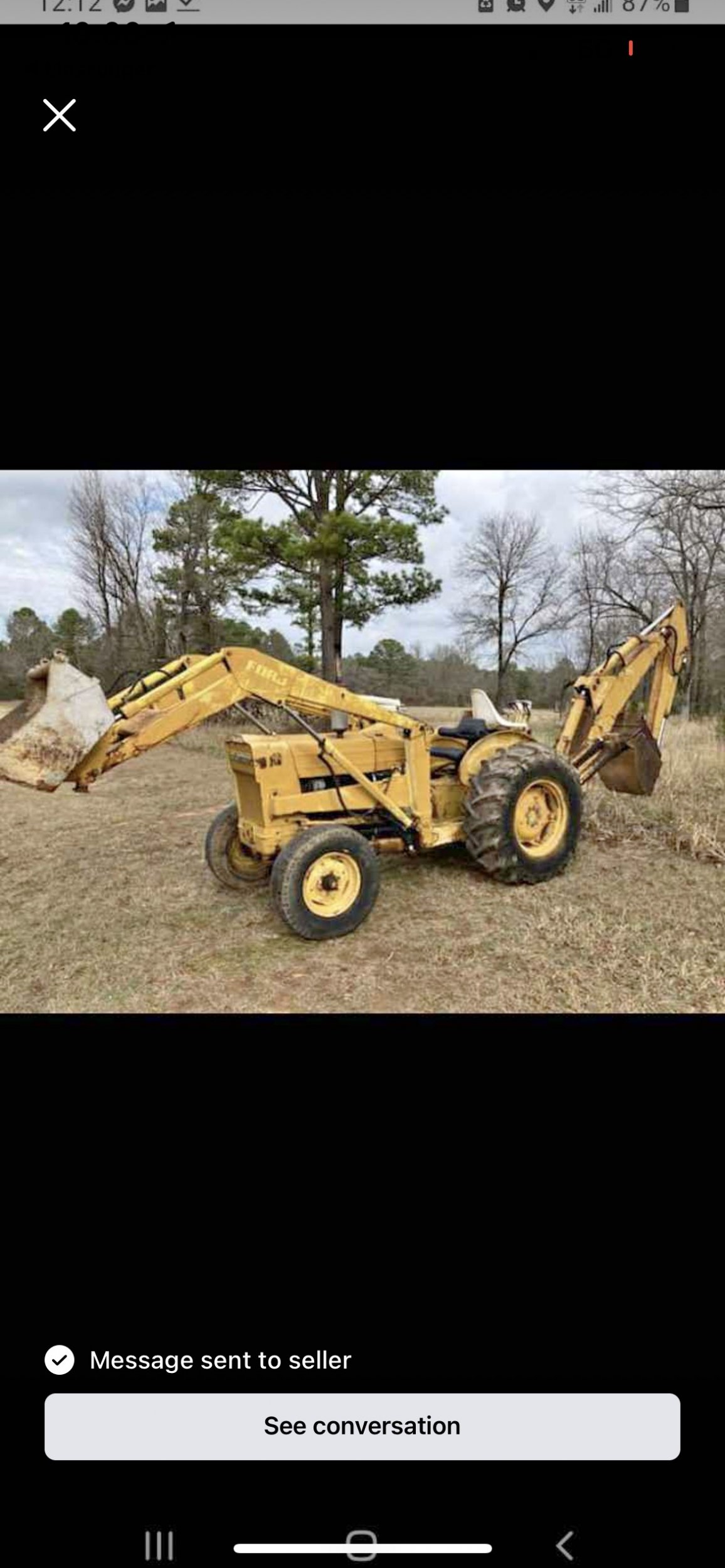

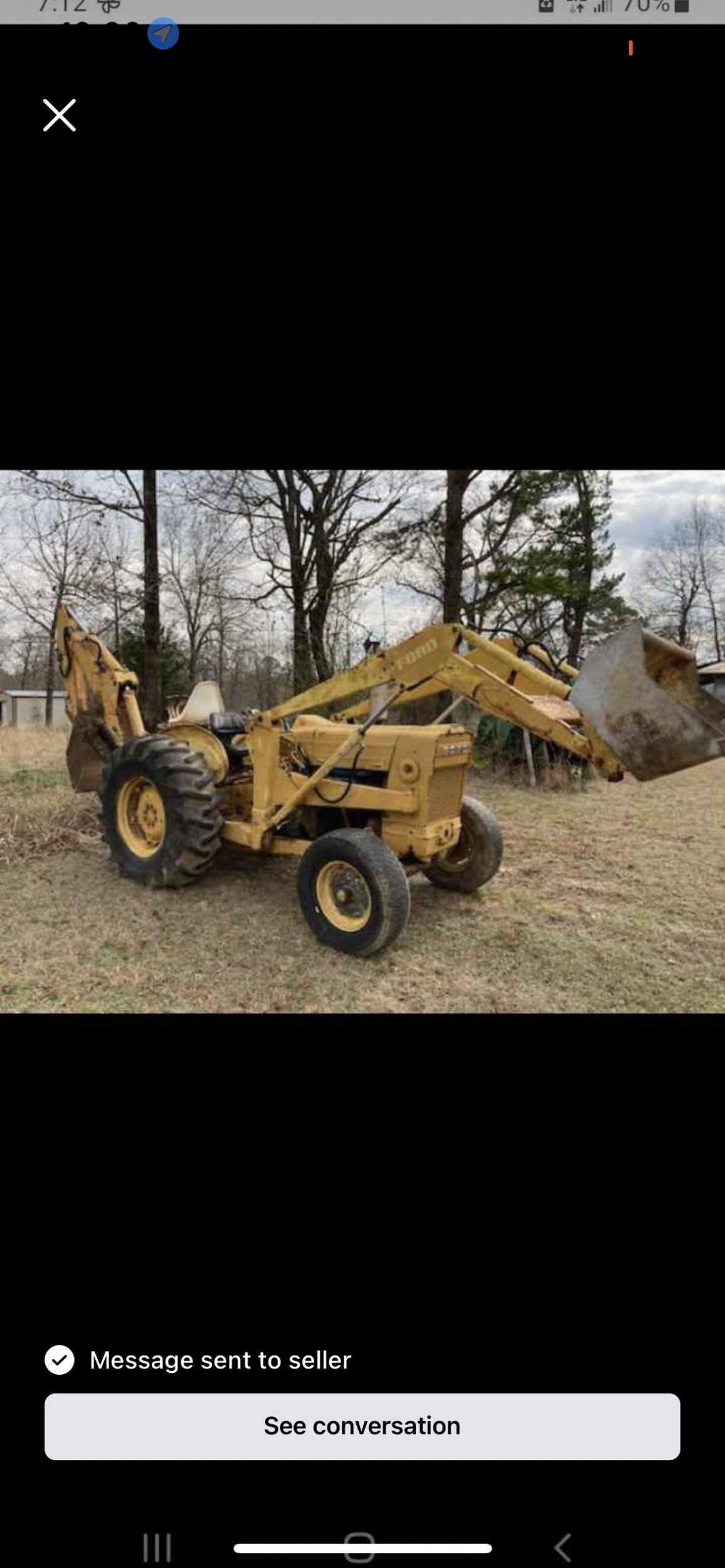

Ford 3500 industrial. Have to pump the clutch twice sometimes to get it to disengage. Said he has been using it 20 plus hours a week for the past 5 months on a property project he just finished. Everything works as should besides that he says. A lot of hoses already replaced. Said he would take $5k for it. Can you tell if I m correct that this is a plan manual transmission? No tc or shuttle? Any specific concerns I should look for? What you guys think about the price. Has one new rear tire also since he punctured the other on a sapling stub.

The left shifter is the gear selector. Looks like my 3910 minus the trans dip stick. Probably a 4-speed. The right shifter is the H-N-L (high-neutral-low) selector. So, it's a 4x2 or 8-speed transmission. I typically cut in 3-low at about 1800 rpm. Once you get used to shifting, forward and backward cutting is no problem. I have many Mesquite trees I back under while mowing. Don't know about the double clutching. Mine is not like that. Perhaps it's a PTO thing with that model. If it has a clutch problem, you have to split the tractor to get to it. Not a job for the typical home-shop tinkerer.

My uncle is an old mechanic of everything as well as my dad. Although I've never actually split a tractor like my uncle has done many times I have a friend that buys and sells them and he had me come out and help one of his laborers put one back together because I have a knack for things. Figured out what his shop tech couldn't in 10 minutes. I think it was more his shop tech wasn't good rather than i'm awesome but I think its something I can work on pretty easy. Will weld up a tractor splitting jack rail system if I need one. My ck3510 Kioti is my main tractor, this is going to be mainly for its backhoe and maybe some loader work. I think the clutch got stuck at some point and has some surface rust which should grind off with time or its a simple adjustment issue. I'll have a better idea after I run it tonight. It weird, everyone i've talked to is all over on if this is a good deal or not. I see the plain ford 3000s loader but no hoe going for $3000-$3500. Found two similar model loader hoes for between $6,000-$6,500. I think my local market is a little higher than some. I use to go buy compact 4x4 tractors south of me and resell them for a $1,000 in my area. I haven't done that in a decade tho since I started real estate investments. i'm rusty on prices, covid has made things go up too. I found a mf40 massey loader hoe for $3,500 last week but it was full of issues so I walked and has been parked for a long time. He sold it a couple days after I left. Was cheap but it looked like alot of work and money so I passed on it. I'm sure this one will be too, just hopefully less work and money. I am happy its been being used and isn't a I bought this and parked it 5 years ago and just got it to start back up so I can sell it type situation.
