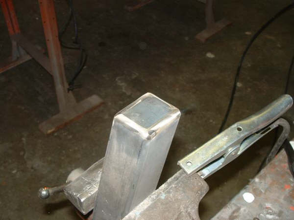

For a cleaner and more professional appearance I welded caps on the end of the tubes that would not get covered.

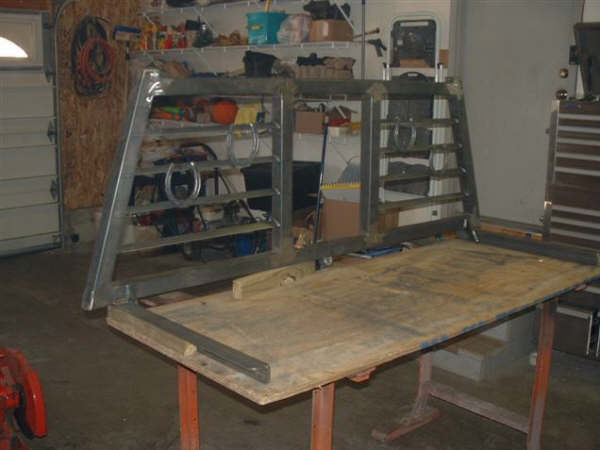

After welding everything up solid I ground all of the butt welds flush and then went over them with the sanding disc to get out any grinder marks.
Then I welded on the 2 pieces of 2" angle that would attach to the bed and hold the rack vertically in place.

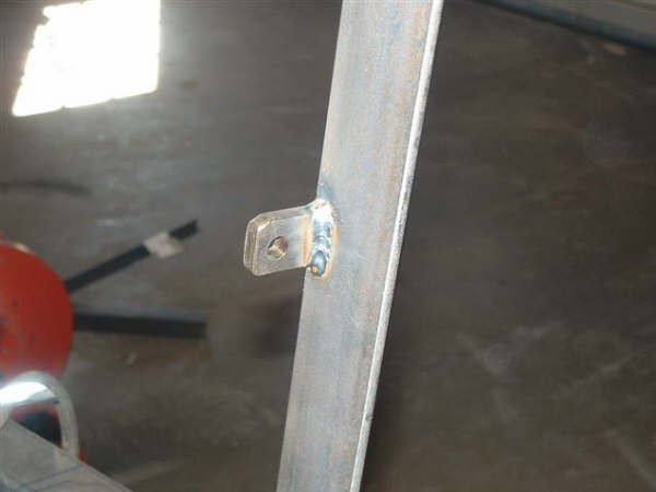

I wanted to be able to install the tool box for my truck with out drilling holes in the top rail. So I welded 2 tabs on to the 2" angle iron that I could blot my tool box to.
