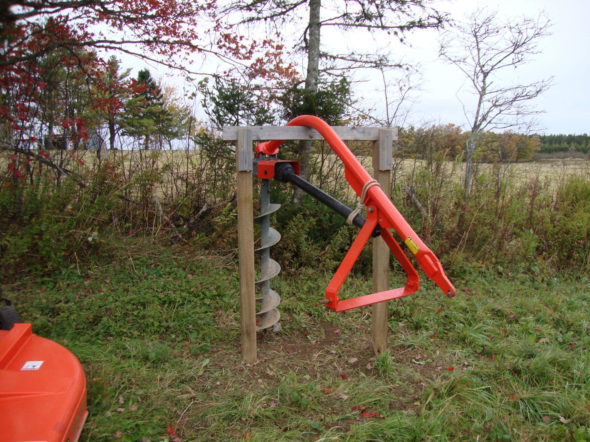

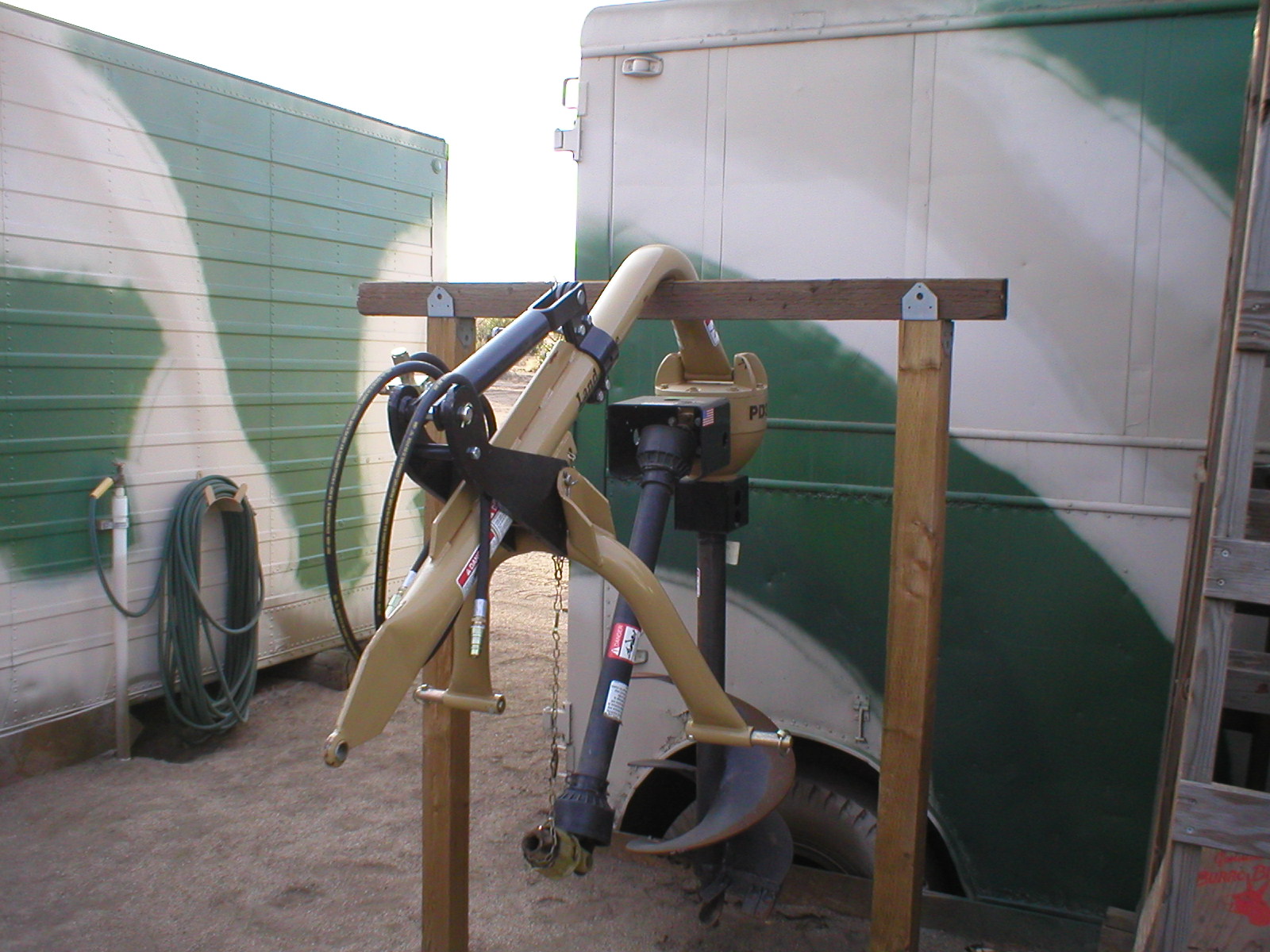

As a side note, do you guys take the auger bits off when you are done for the day or do you leave them on? I was planning on leaving it on but it scraps the ground in certain areas, so I tied the bit up a little using a tie down just to get it put back up, how are you all hauling it with bit attached, is there a easier way?
Andy
/ PHD with L3800 #14
Dug a couple of holes yesterday and worked great. Can't believe the ease at which it was.
Andy
Mine stays on 24/7/365.. I tie it up as high as it will go with some rope when transporting, then let it hang down from the stand when it's off the tractor.
Sean

Same here: Mine stays on always, & I use a strap to secure the bit up toward the back of the tractor to keep it from dragging the ground.
/ PHD with L3800 #16
I have a stand similar to Chilly807 and the only time the auger bit comes off is to change the size of the bit. The post hole digger always hangs with a bit on it. ;)
