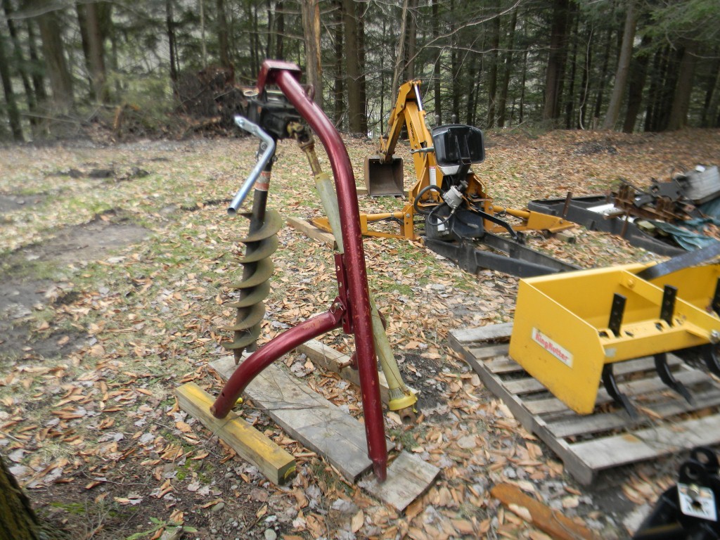

Currently my PHD is sitting on 4 boards. I did cut a large chain link in half and welded it toward the top of the boom pole and can support the PHD from a tree branch with a chain or rope but don't have a tree branch handy where the PHD would be out of the way for snow plowing.

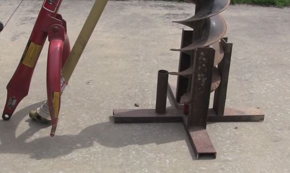

Saw this on YouTube. Seems simple enough. I just park mine in a partially dug hole.

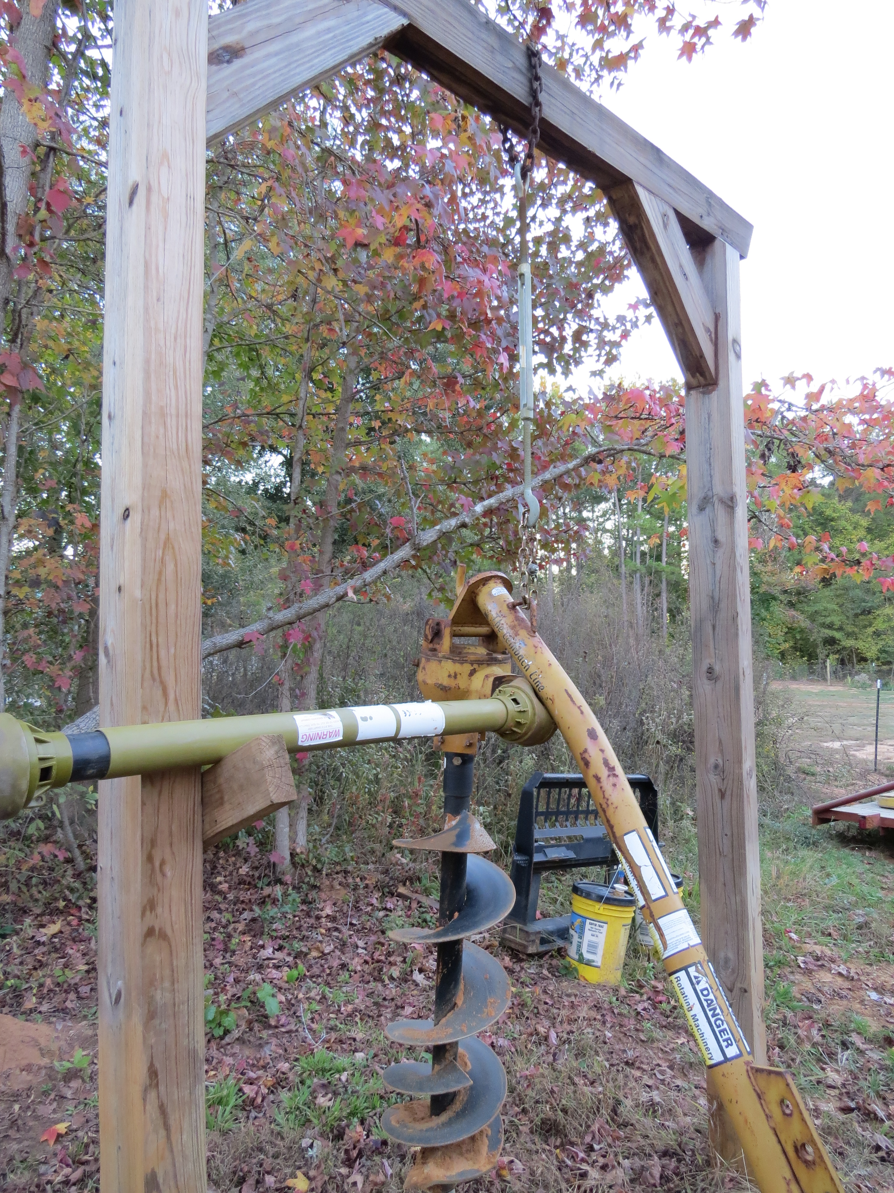

Couple of posts that I salvaged from a remodel job and a chain wrapped around the top make it real easy to attach and remove my post hole digger.
