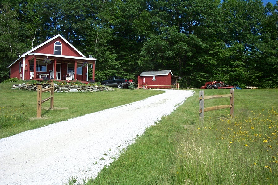

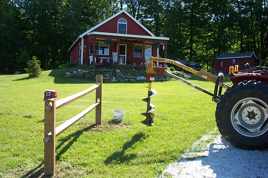

Good Mornin Guys,
Just one last followup on this PHD thread. I did purchase the Leinbach 7300 unit, I didnt want to post any kind of review until I really had a chance to test this unit out and and try it in some different applications ! When I first got it I planted a bunch of small pine trees, spelled fairly shallow hole, but with the 12" auger I found it was the ticket for numerous plantings ! As a side note, you can take a piece of chalk and mark the bottom of the rear tire, make one revolution and drop that PHD in the ground again for the next tree ! ;) Dont forget to tighten your lower arm turnbuckles ! :(

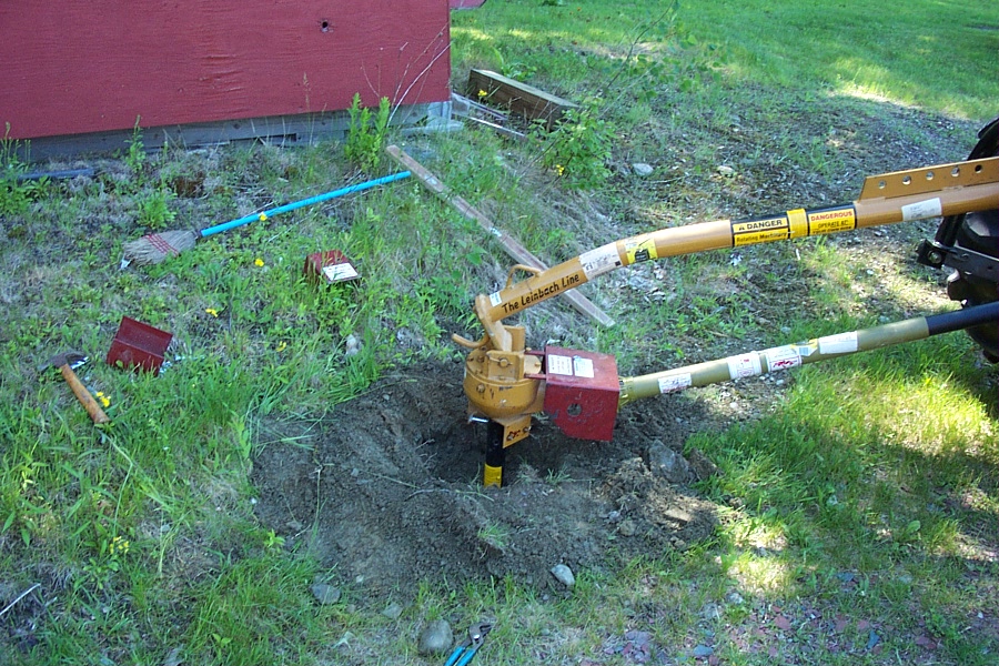

My second project was planting a bunch of split rail fence on various parts of the property ! :) I was cruising along just great, when my Uncle Dave arrives up the driveway and says, why not a couple of sections in front of the shed for a hitching post ! :confused: OK Uncle Dave, no problem, as soon as he leaves my PHD started drillin for China ! ;) I coulnt get that thing outta the ground no how ! :( But some where in my memory banks, someone ( Gotrocks) said get a big pipewrench ! Well a bit of sweat, but that method does indeed work ! :) Thanks TBN and Gotrocks !!!
All in all I am very happy with this unit, it has done everything I have thrown it at it to date !;) I would defintely reccommend this unit, the 7300 is well matched to the Massey 1040, and the previous link that I provided on where I bought the unit from were helpful and curtious !
Here are a couple of shots from my latest adventure, the post holes ranged about 2 to 2 1/2' deep that is until I started drilling for China ! :)
BTW I have purchased some extra shear bolts from True Value, money well spent ! :)
