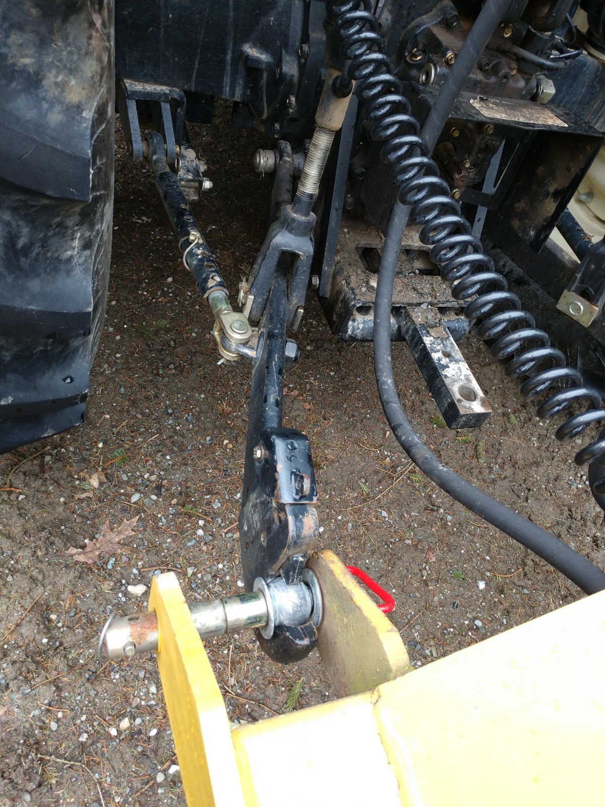

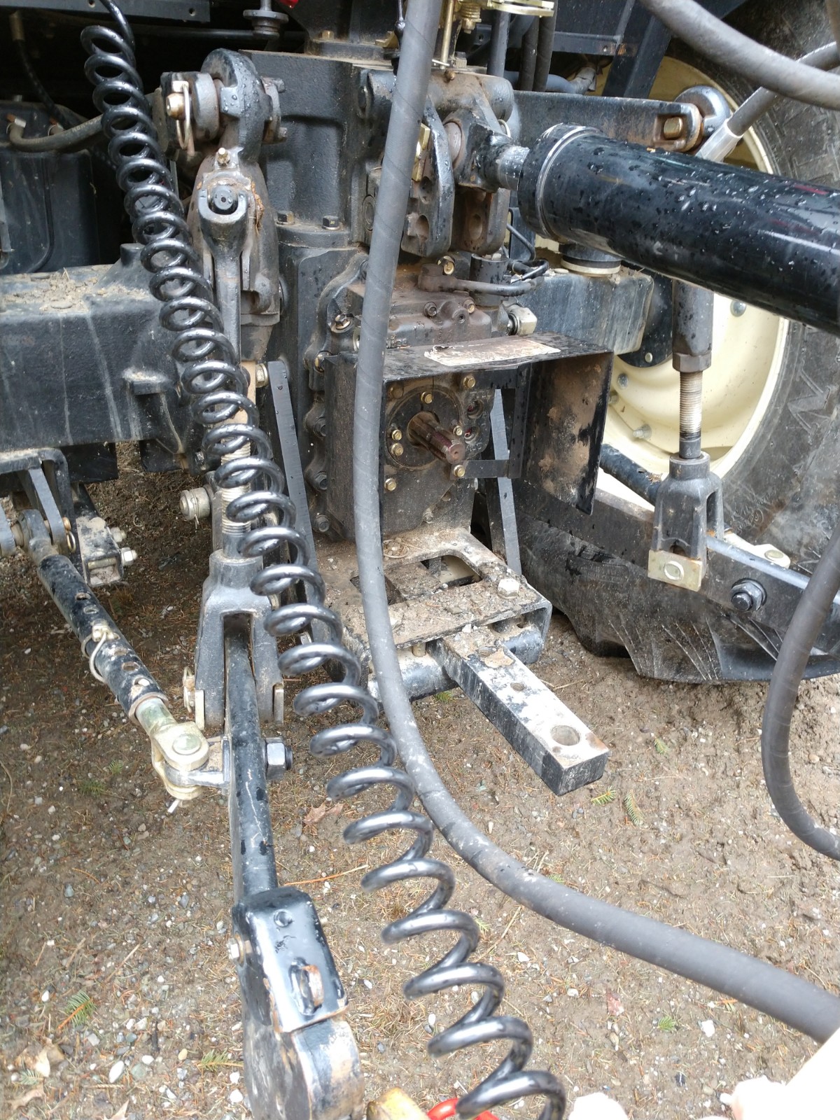

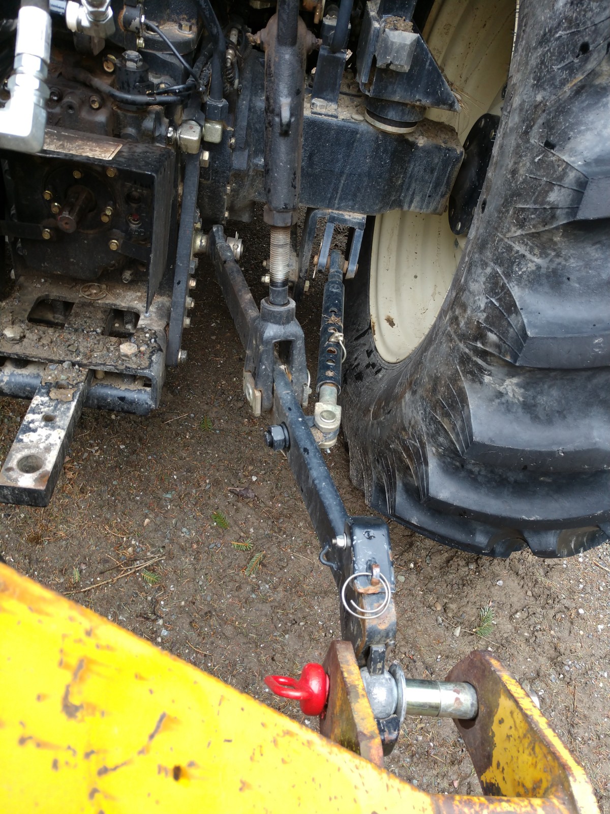

My 8050 has pin and sleeve type stabilizers which keep the lift arm spacing steady but adjustable if needed.
What I like also is the room when working on the rear, you have access to the pto and hydraulics without fighting to reach thru or around a quick hitch,
I did have a quick hitch on her for awhile, not any more except for a couple of specific uses ( I actually have mounted a gooseneck ball on the top of it.)
