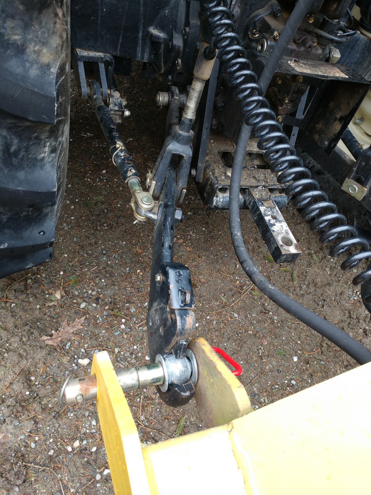

Was hard to find but managed to find one. You can also hook a string/chain/cable on the eye on the top, and you can open the latch without leaving the seat. Once the ball seats on the hook, it will self latch.

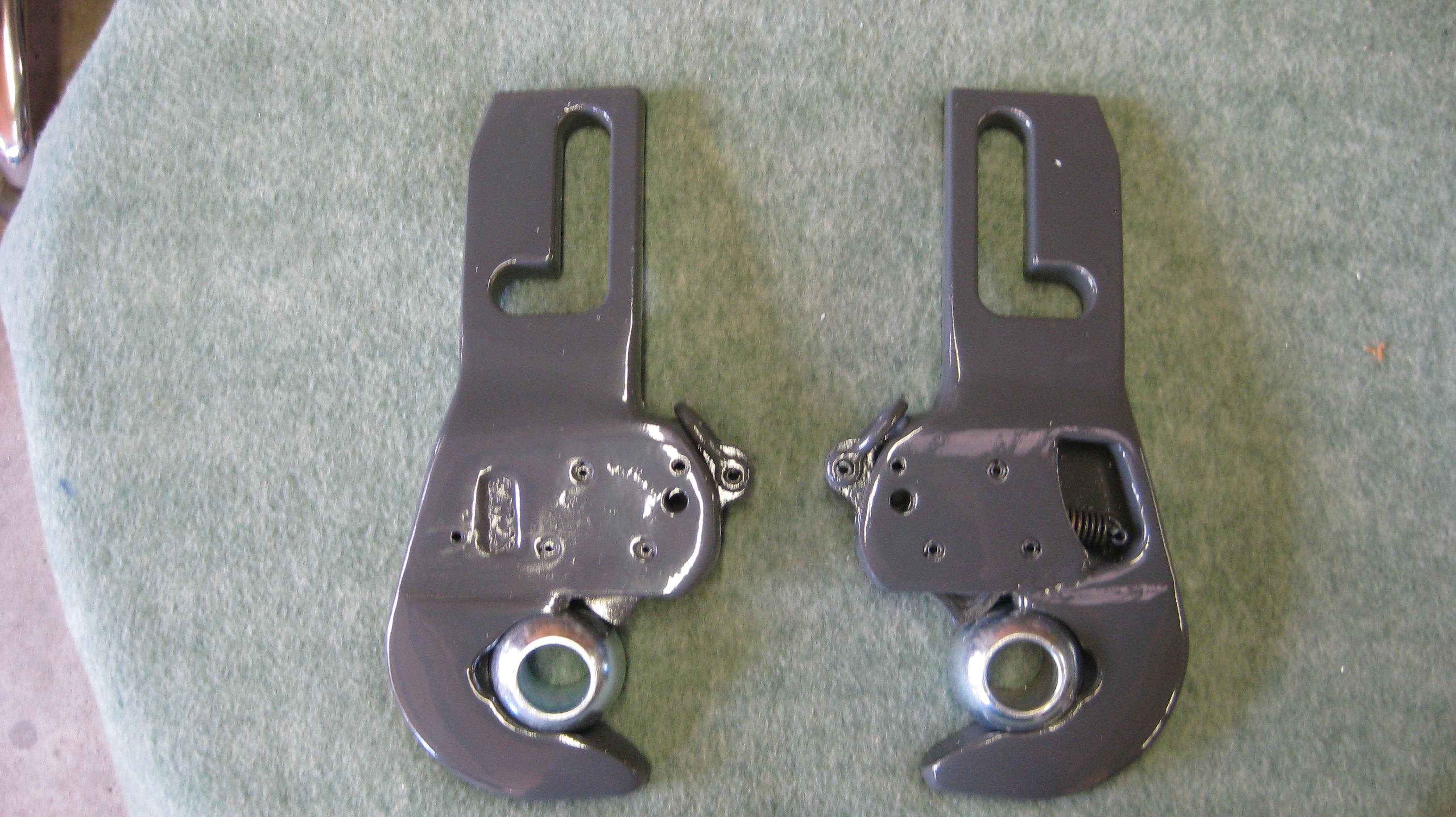

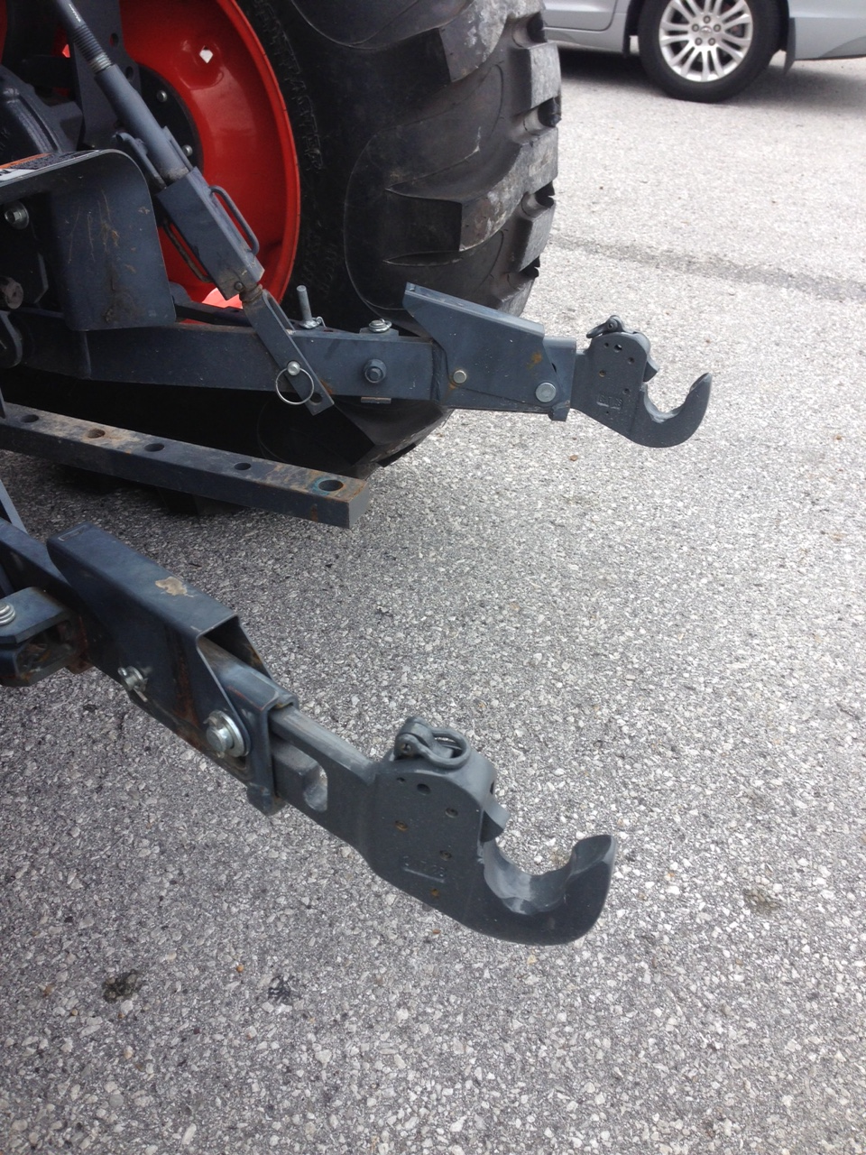

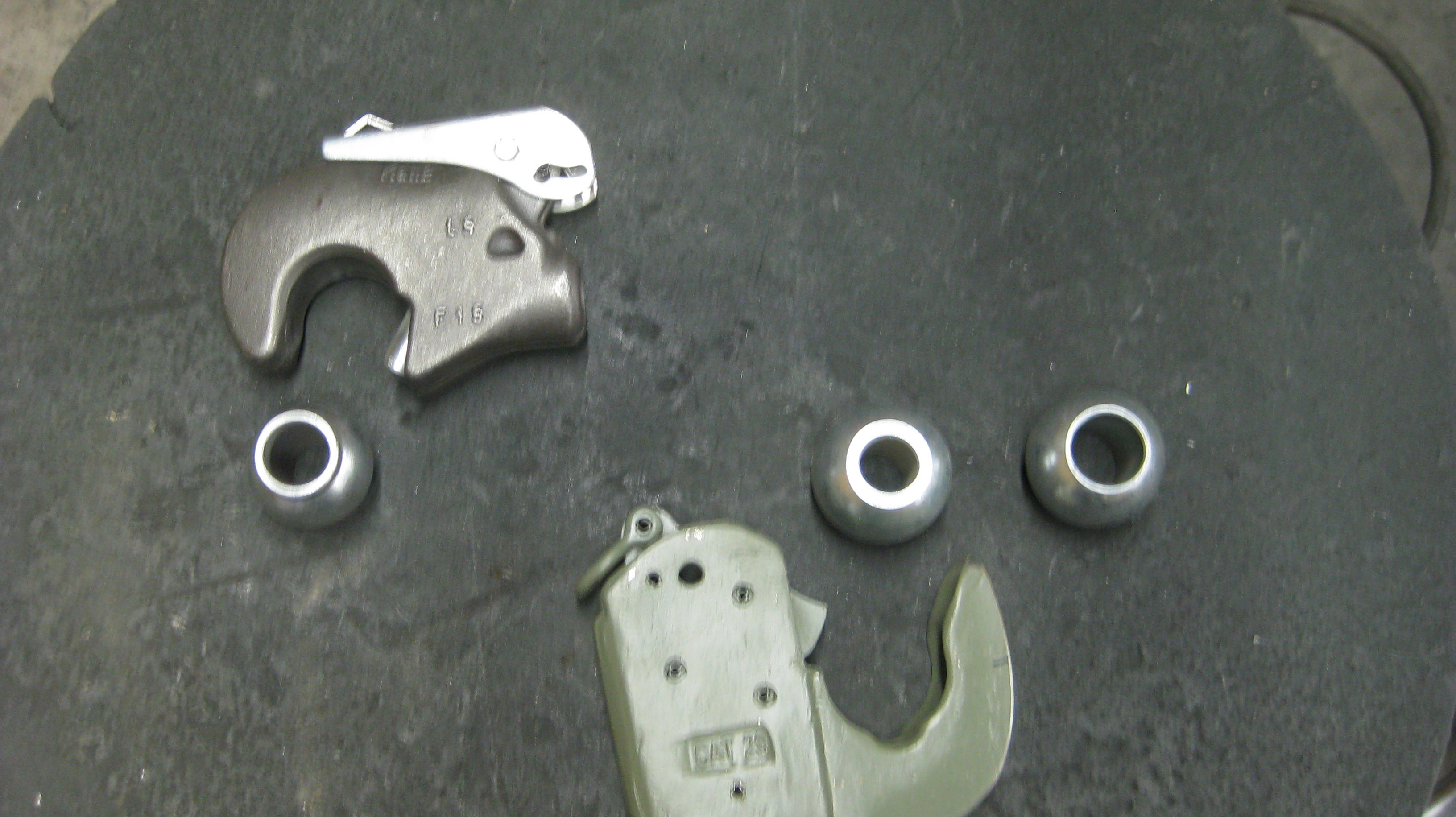

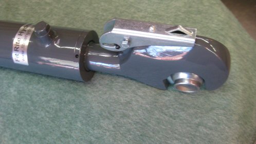

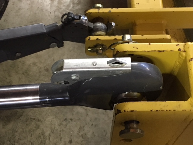

Here are the European type ends on an L6060. But then to complete the set, you need a hydraulic top link with a hook end. :cool:
You can get a complete draft link set with 2 sets of balls for $270 shipped to you, you can cut & weld to your existing extendable ends. Or you can ship your extendable ends to me and I cut, weld and return ship for $350. :thumbsup:

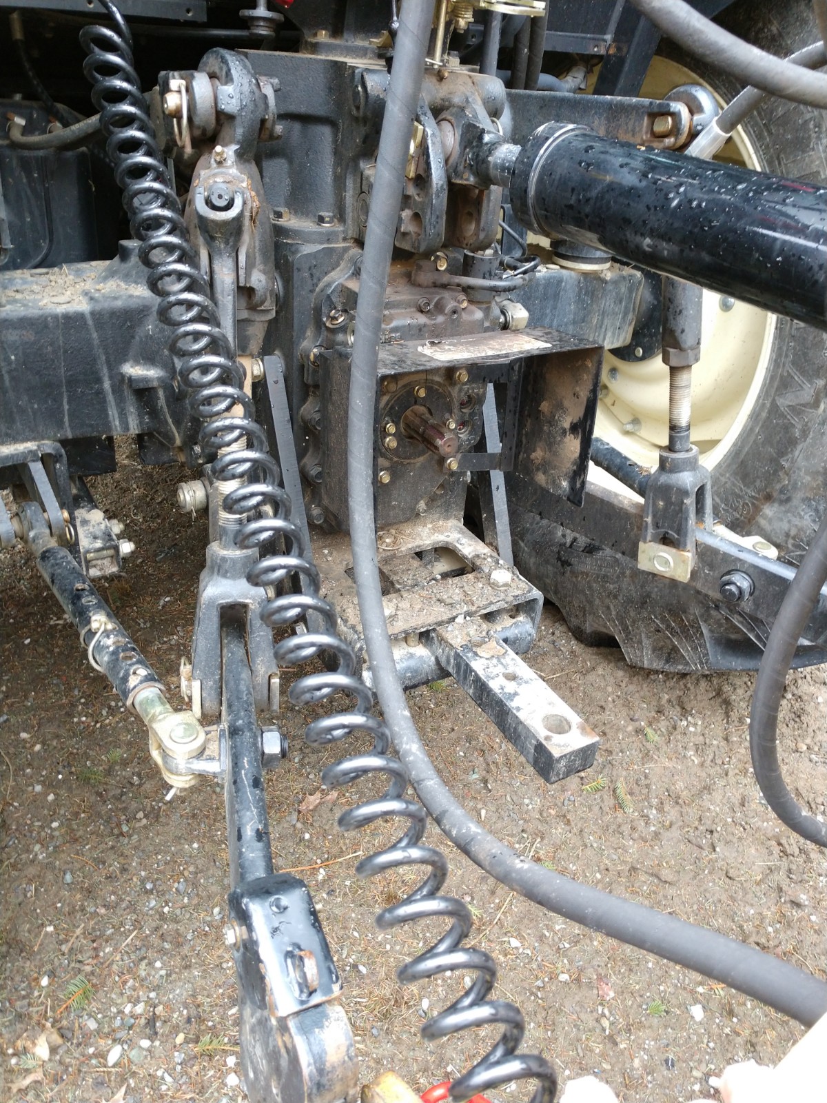

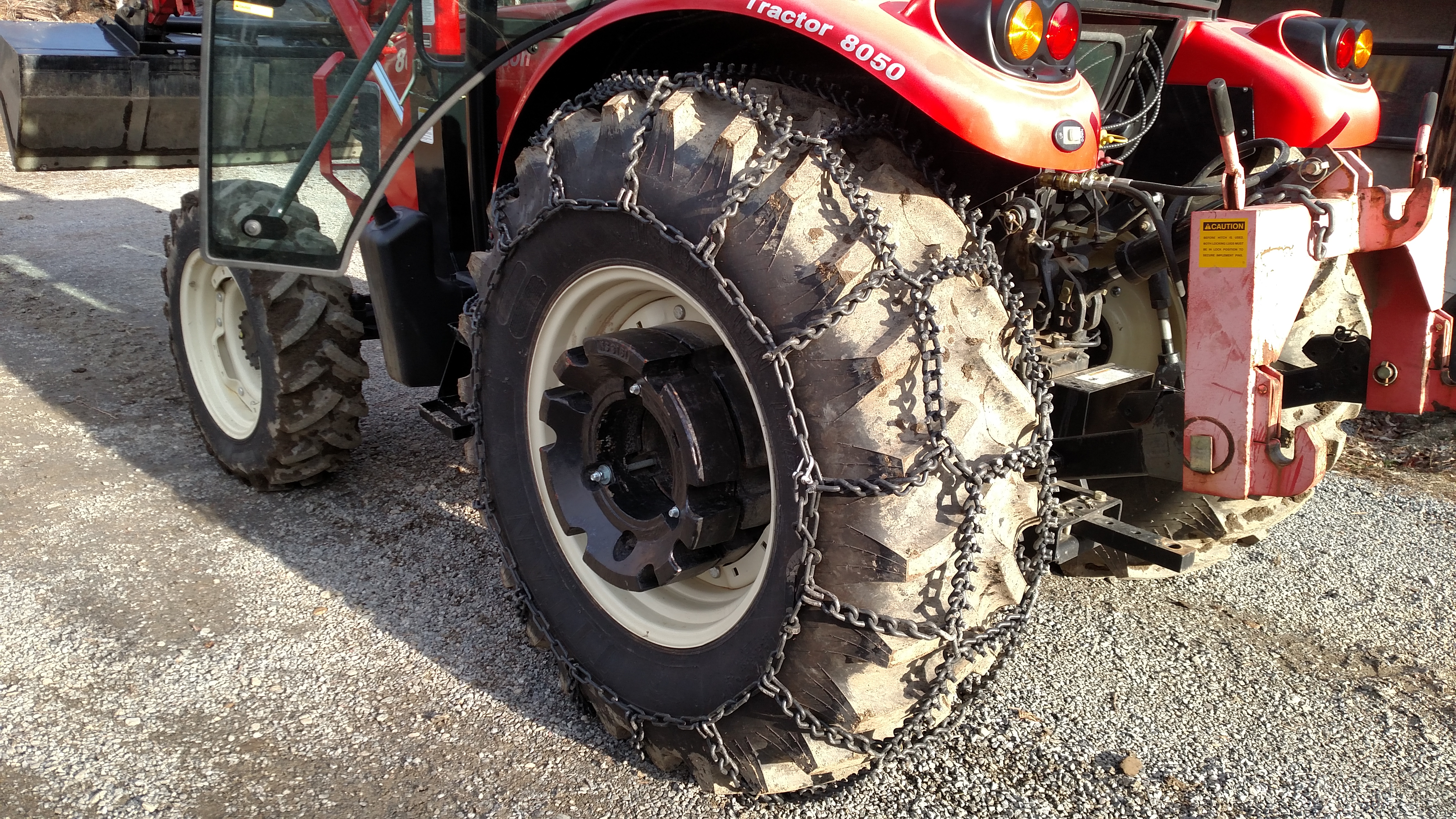

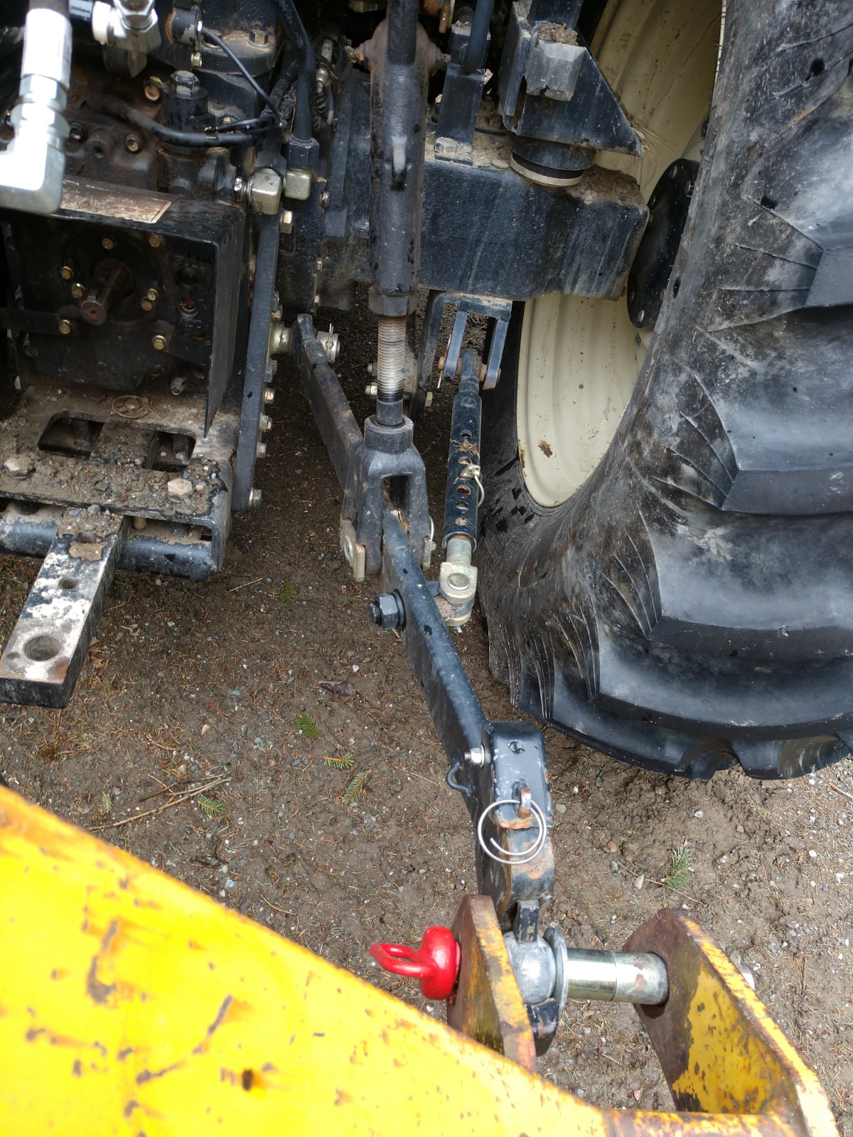

I have these on the Branson 8050 and I find them nicer to work with then a quick hitch. I use a conventional hydraulic top link.
The main thing I find is they are easy and quick to fasten to the lower links and many times I will reach in to connect my pto before putting the toplink in place the room to maneuver without the quick hitch verticals and horizontal bars is very nice, it gives a person room to reach and lift to connect the pto without having to reach thru a quick hitch.
