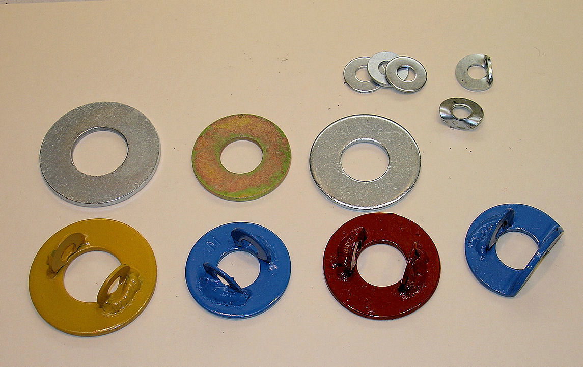

And what are the yellow washers? Looks like maybe you had a bunch of custom ones made (or made them yourself) with two tabs for the lynch pin to keep it straight and in place. I've already used the hitch enough to know that I've had to reposition the washers a few times to keep them out of the way of the arms coming up from below.

The yellow washers are just hardware store washers that fit CAT 2 pins and a couple of small bent washers welded on. The reason they are yellow is because the CAT 1 washers were painted blue and are grade 8 washers. Red is CAT 1 but regular washers. Also, the stock Pat's bent washer can be modified with a washer to keep it in place and keep them out of the way (also blue).

Really like your washer idea, both the extra 90 degree washer for lynch pin stability and the color coding.
